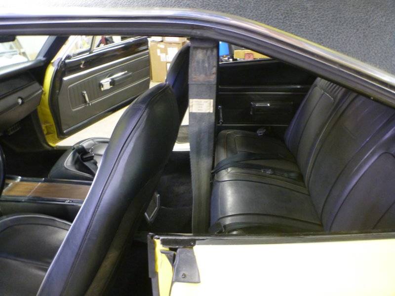

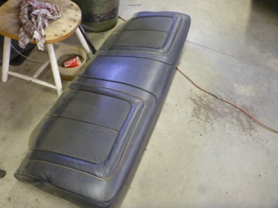

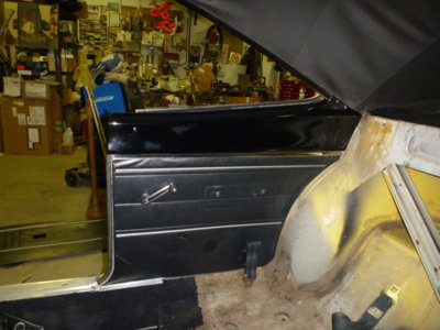

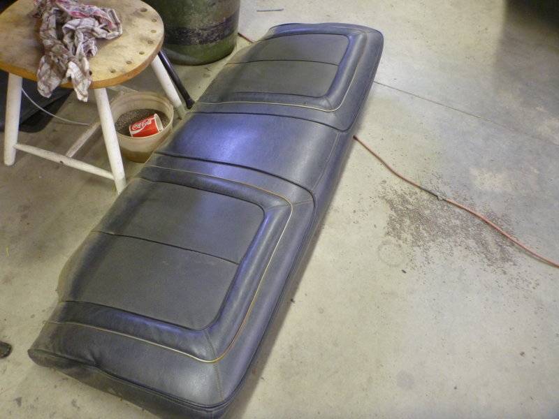

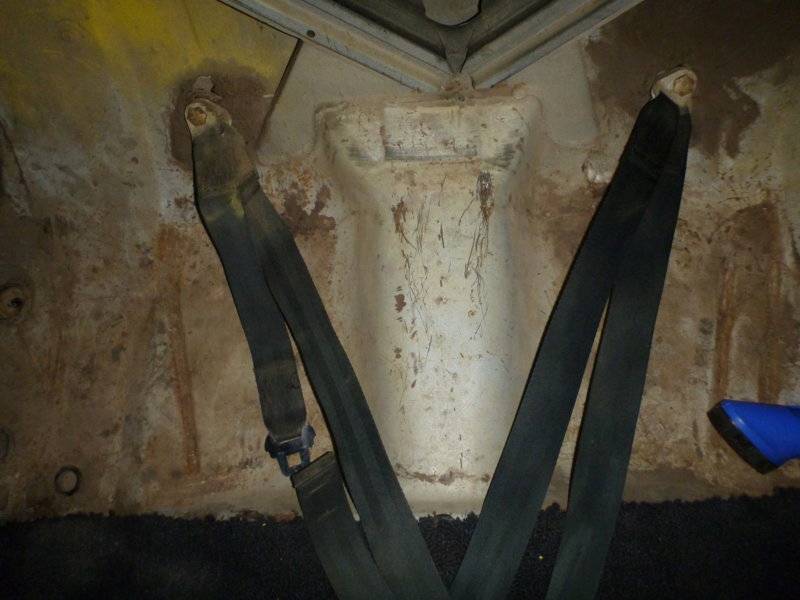

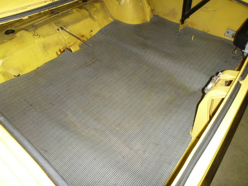

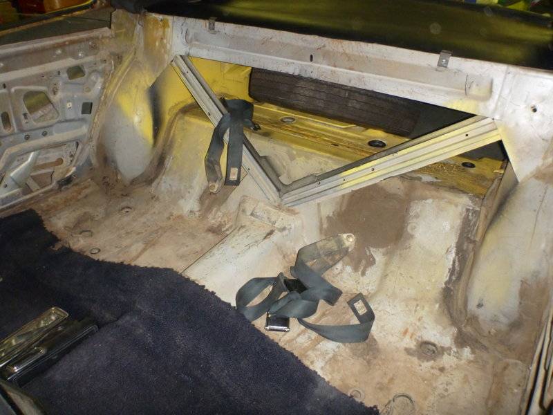

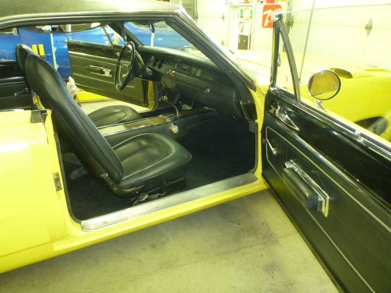

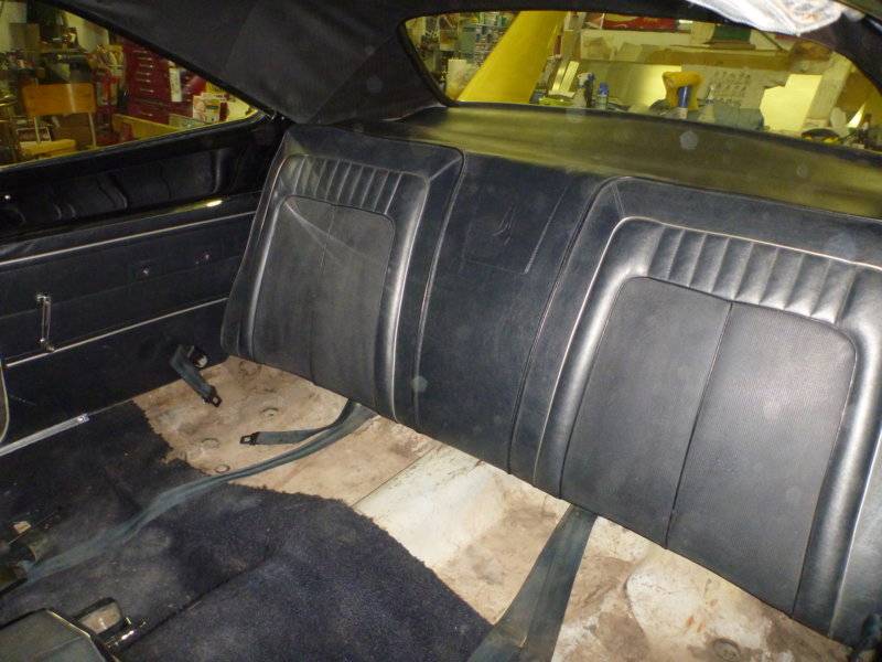

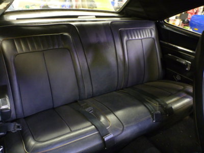

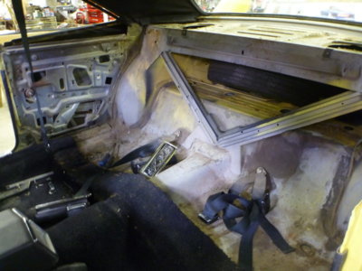

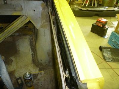

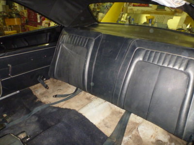

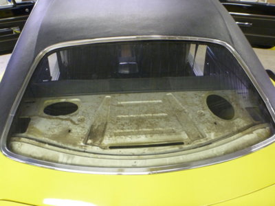

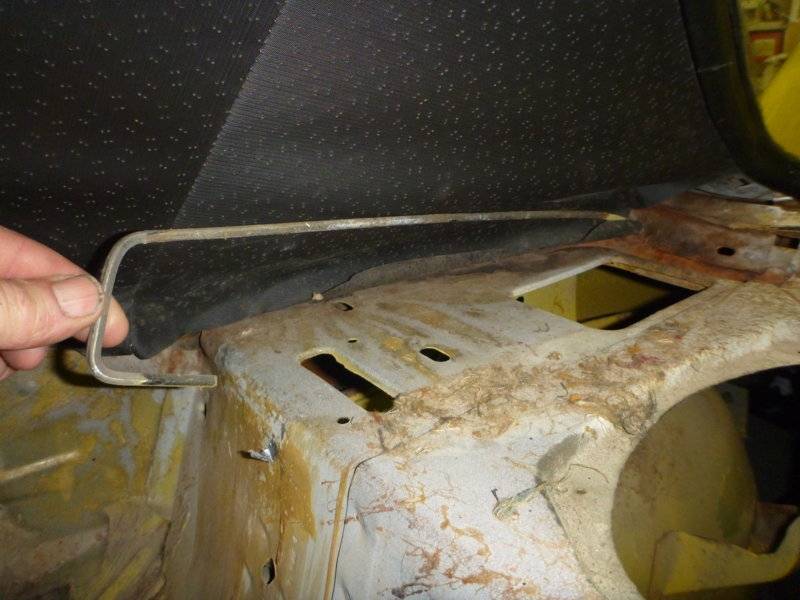

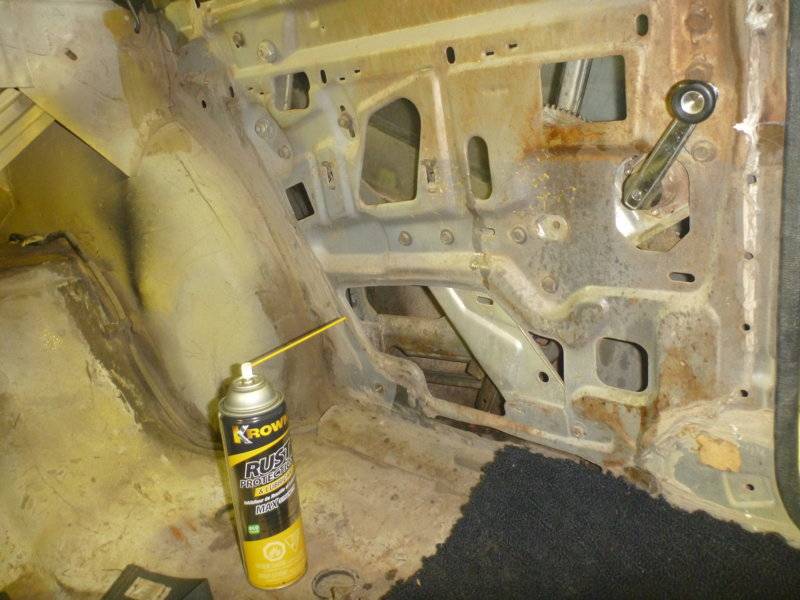

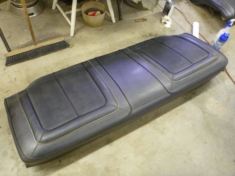

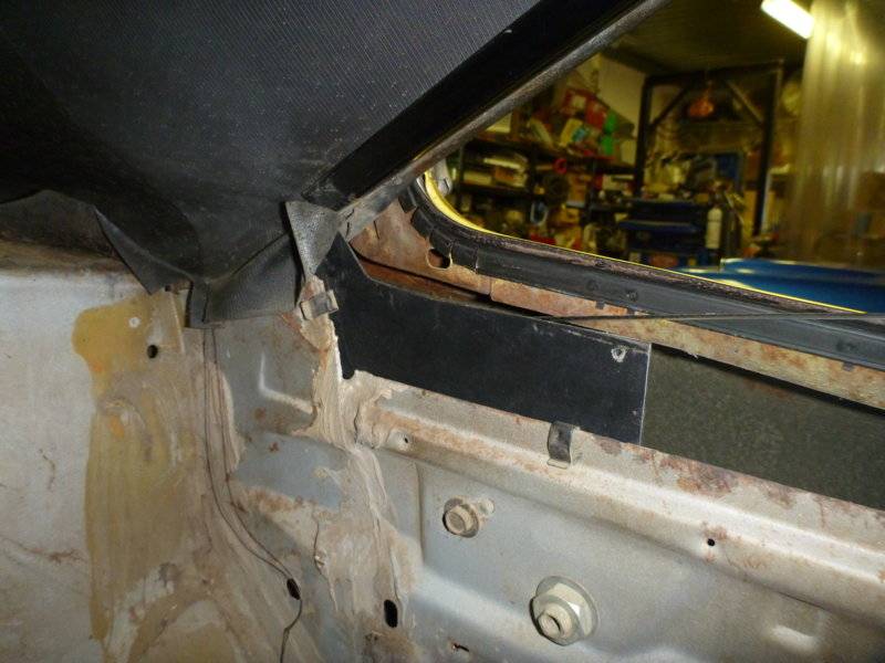

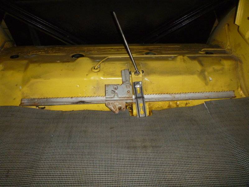

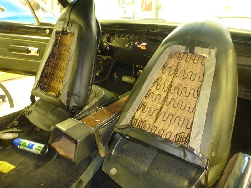

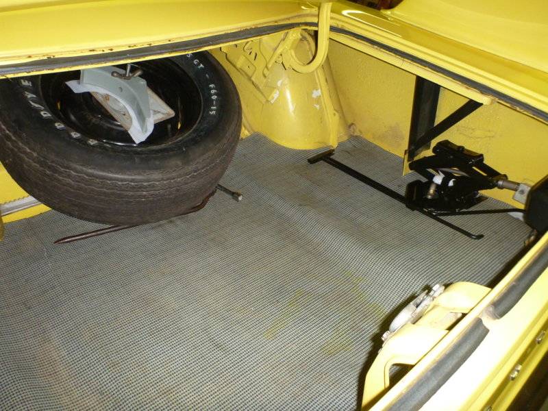

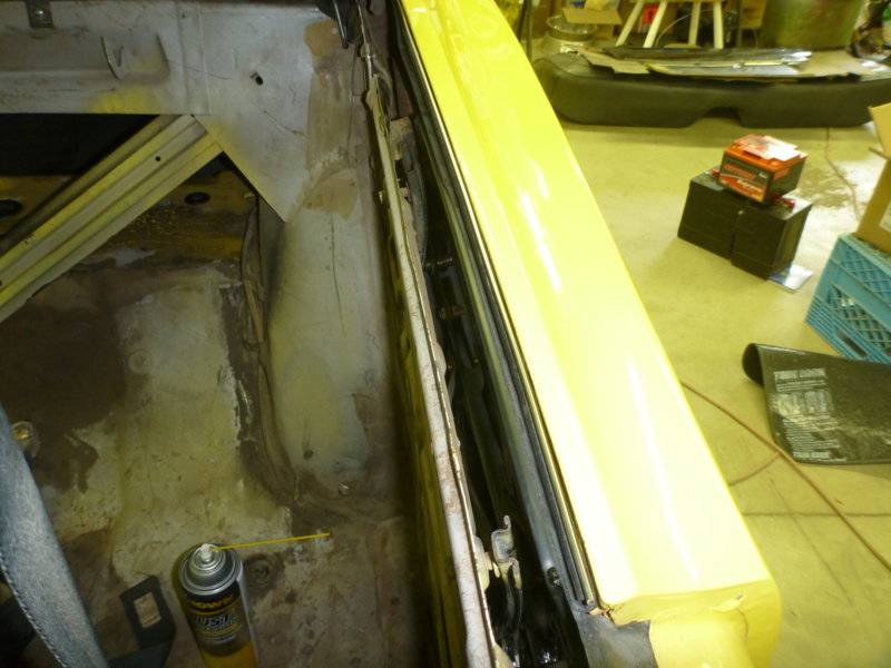

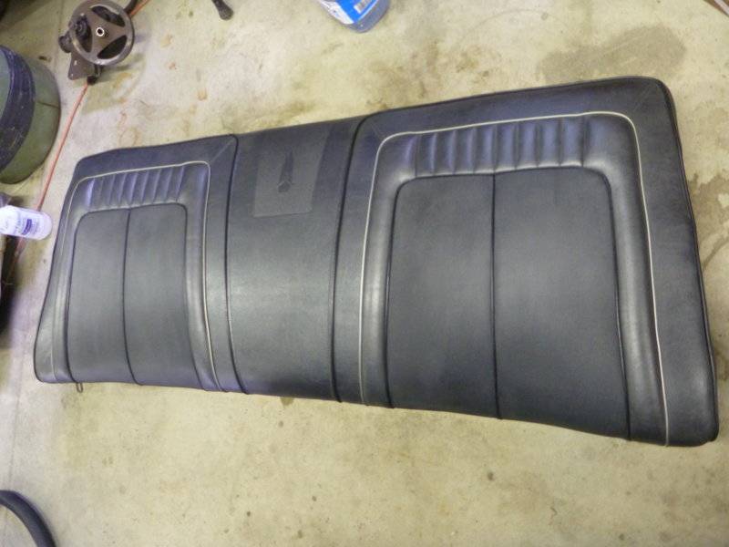

Rear seat out.

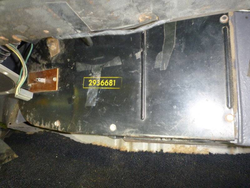

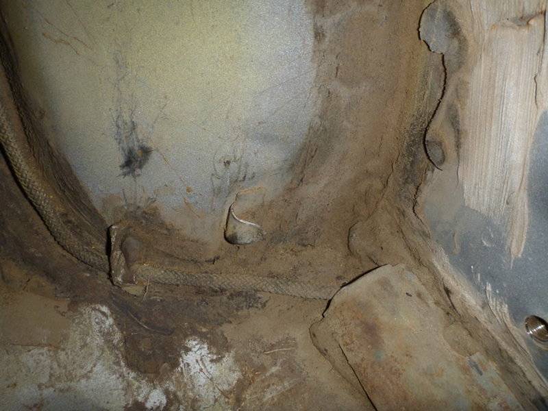

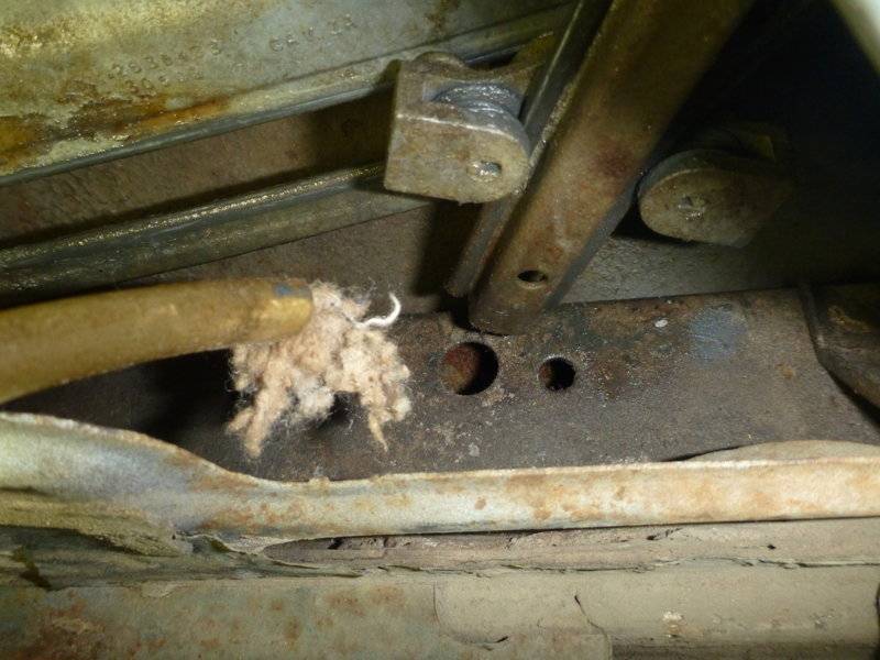

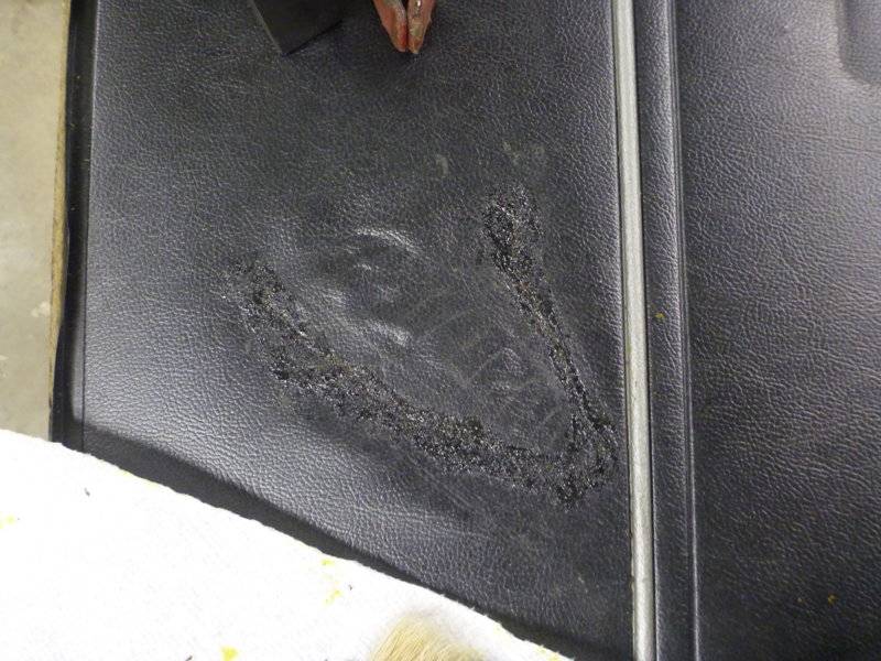

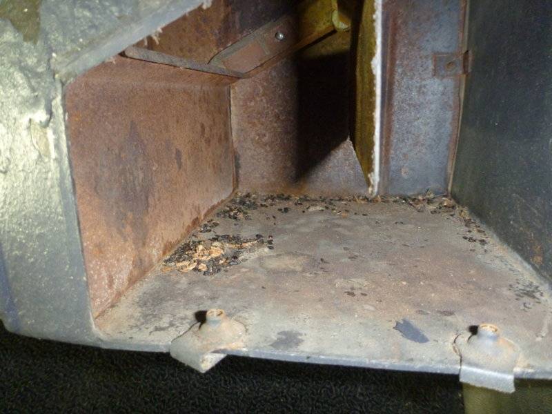

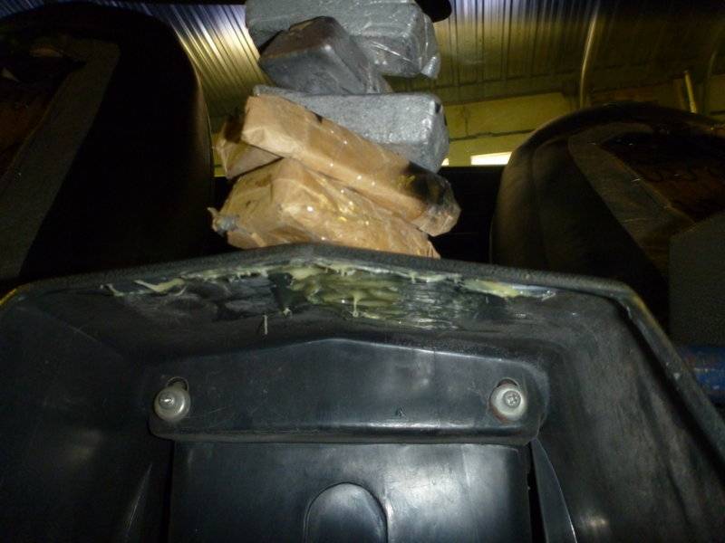

Someone dropped some hash.. wasn't me, I don't sit back there!

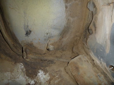

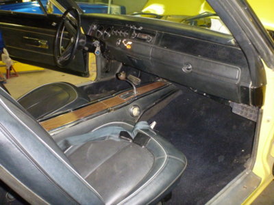

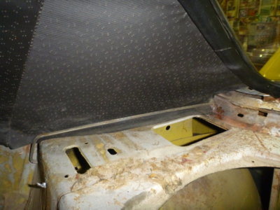

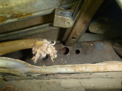

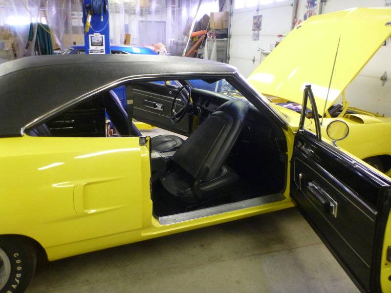

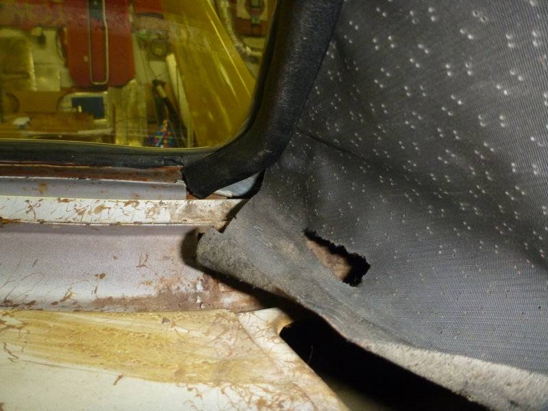

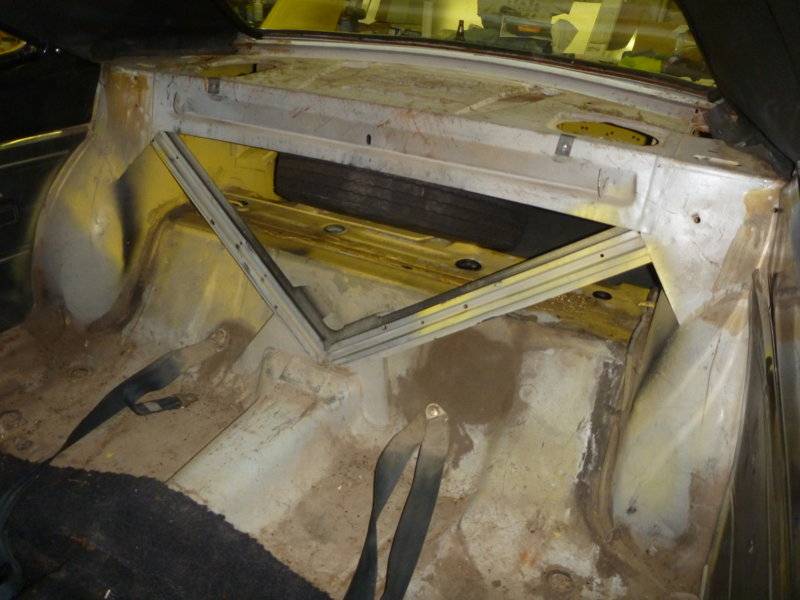

Man I wish the Bee had of been in this shape. Floor pans, etc are absolutely MINT.

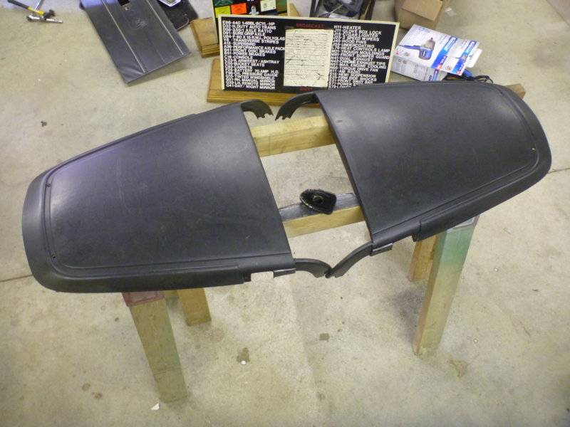

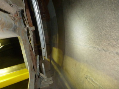

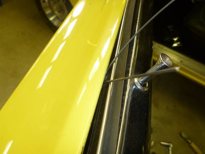

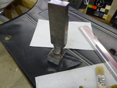

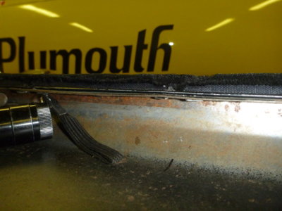

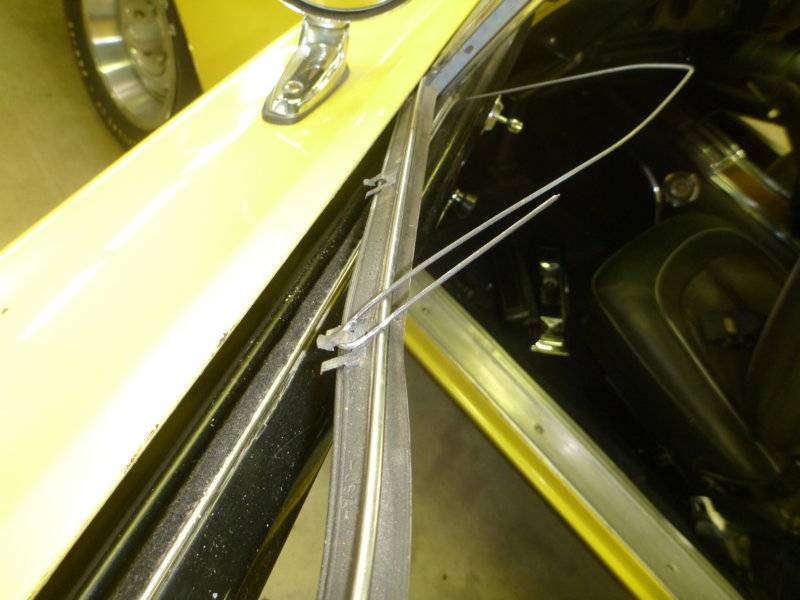

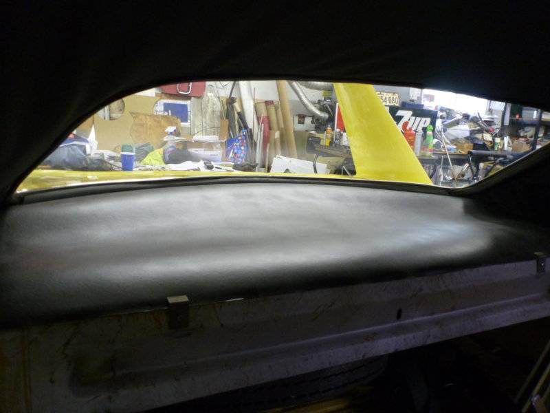

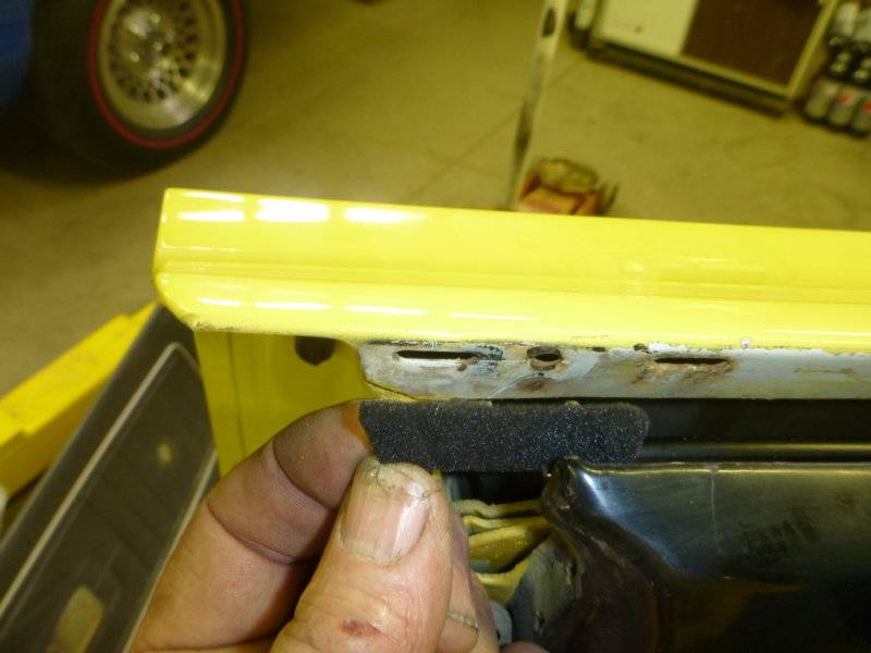

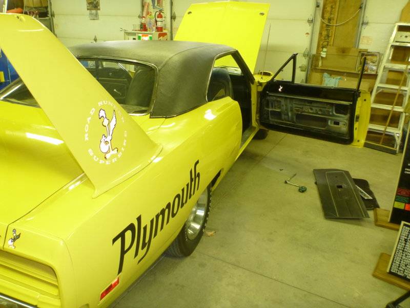

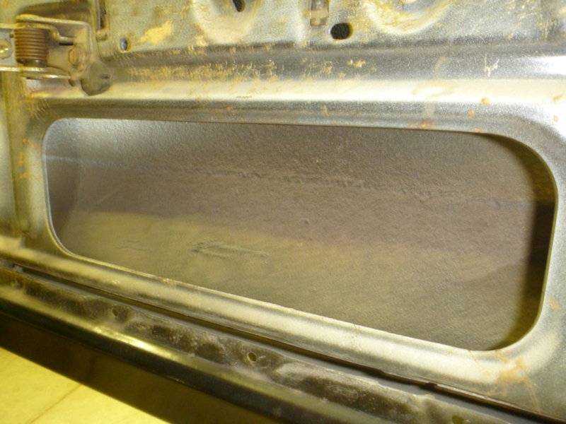

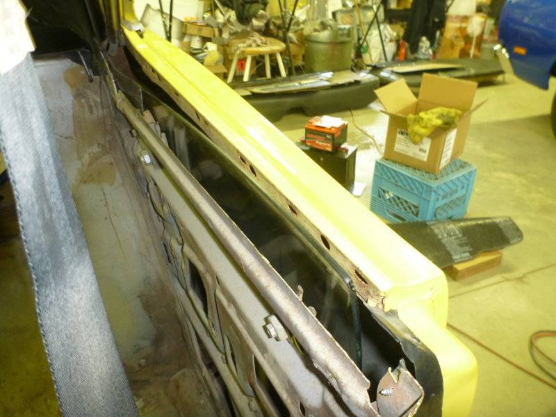

Rain shield still in place on the driver's side, missing on the passenger side.

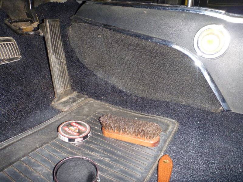

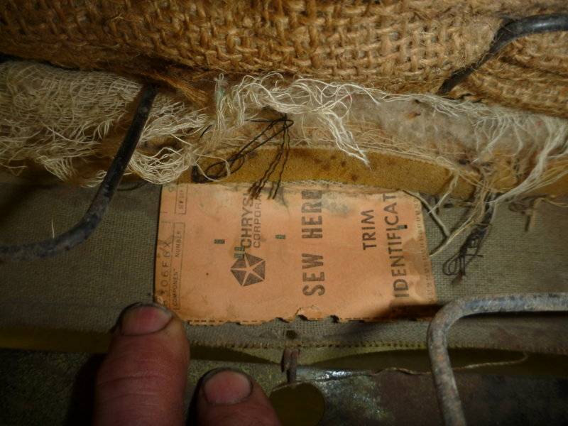

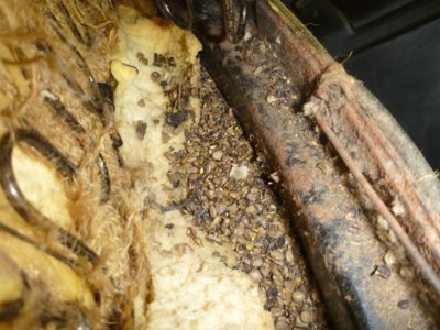

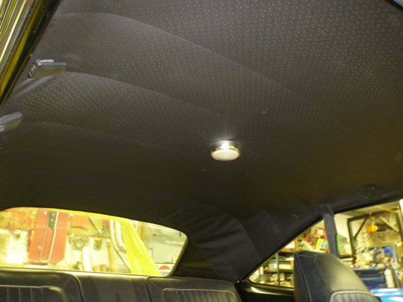

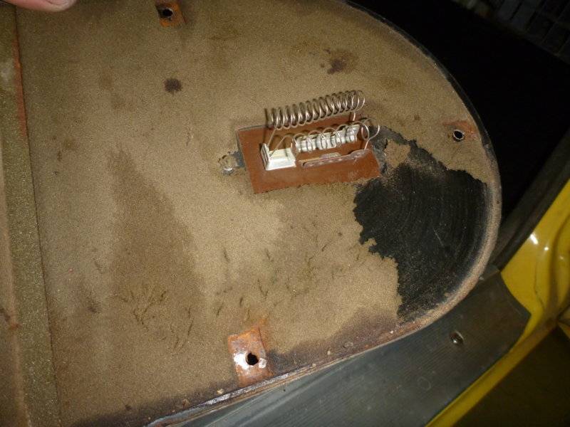

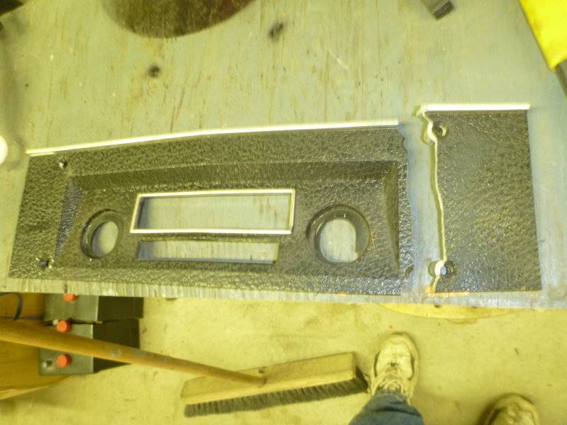

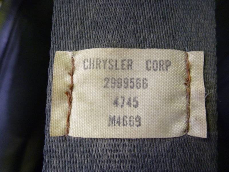

I see many painting interiors body colour... grey primer throughout.

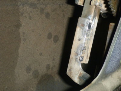

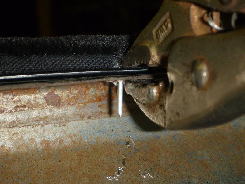

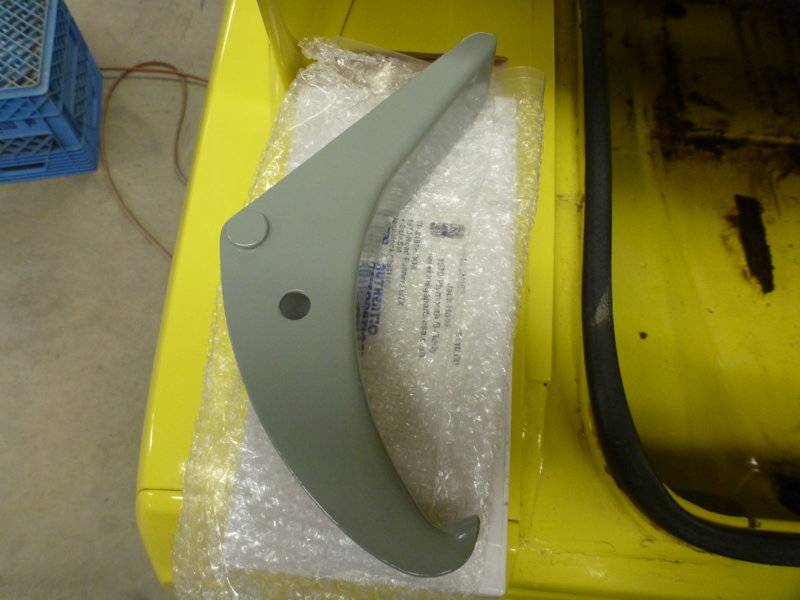

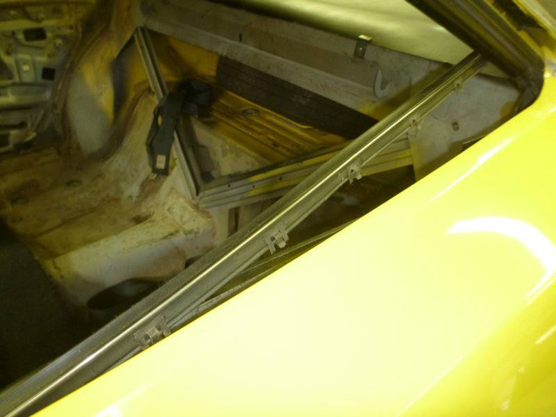

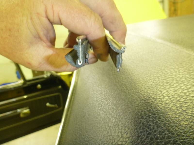

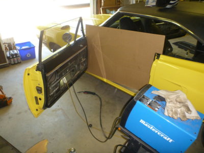

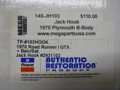

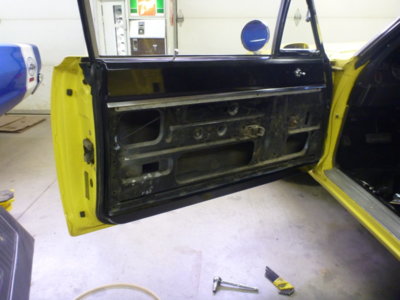

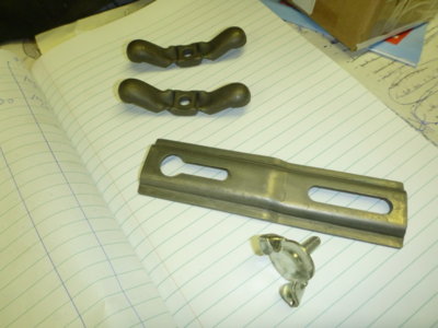

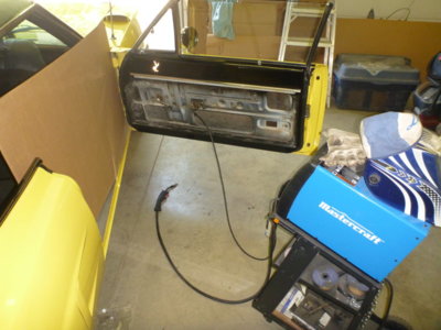

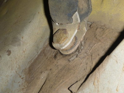

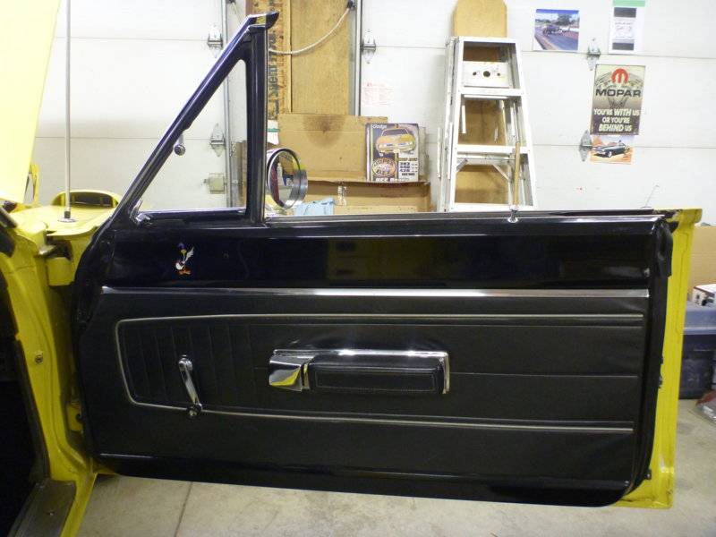

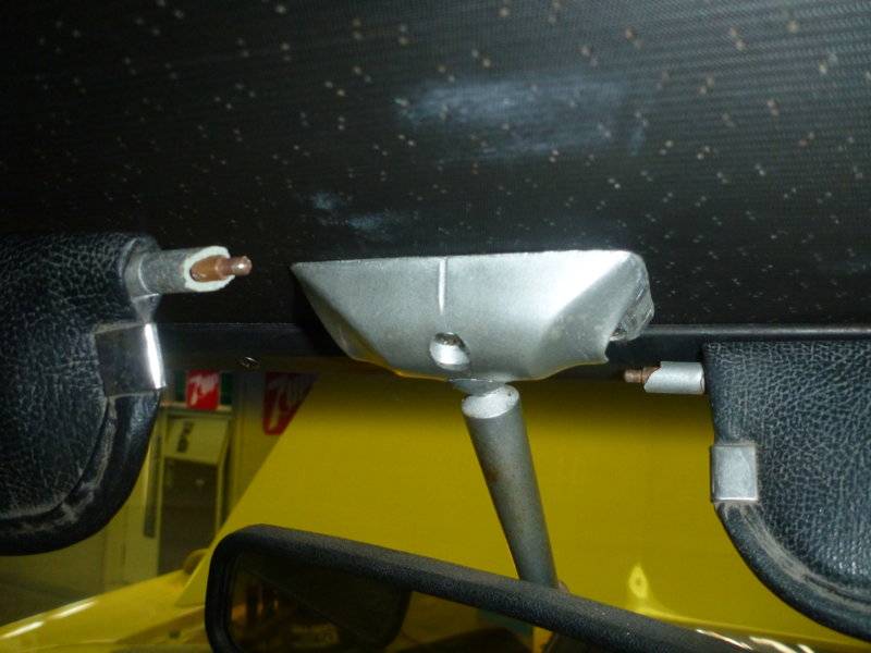

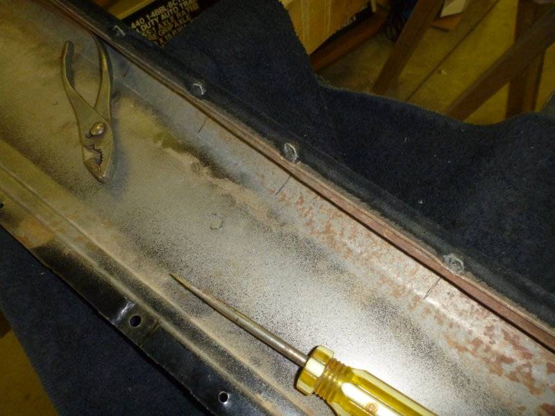

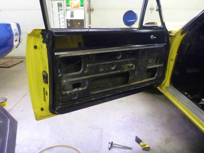

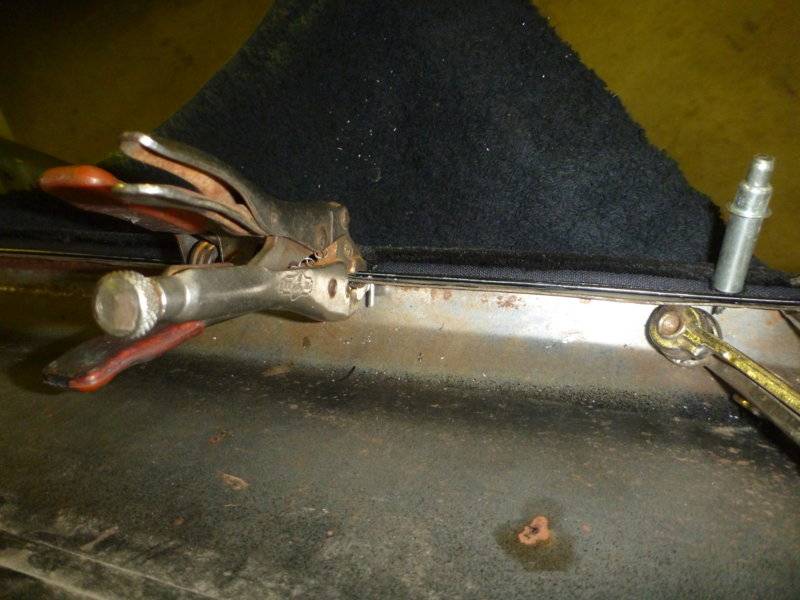

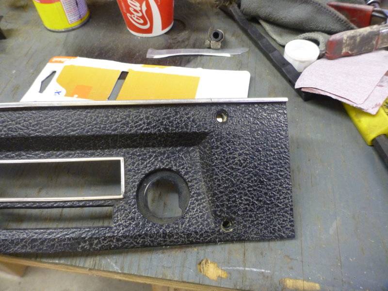

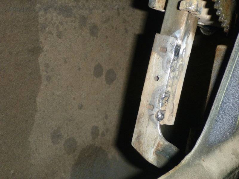

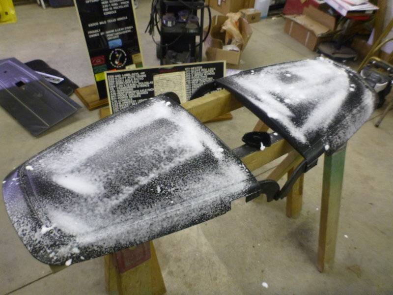

Typical vent frame lower fork broken off the track. Still has the OE "anti rattle" felt on it. Guess I'd better pull the drivers door panel and check it too! Will MIG weld it in place..

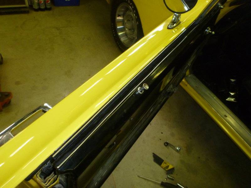

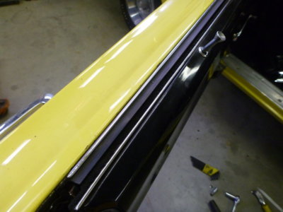

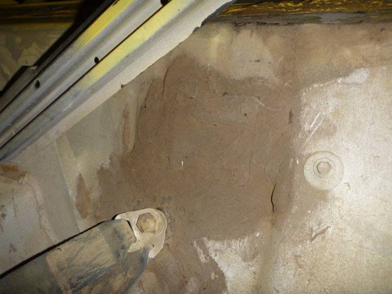

So nice to tear into a 50 year old door, 30 years after buying a car on a whim (at 28 years of age) and finding that the metal has never been touched!
All to remove the mirror, so I could tighten up the pivots screw.

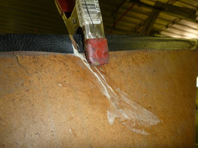

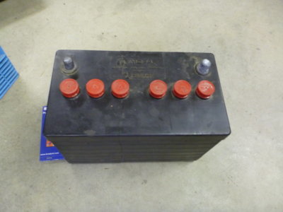

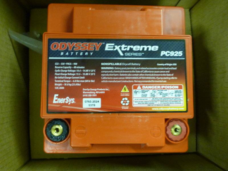

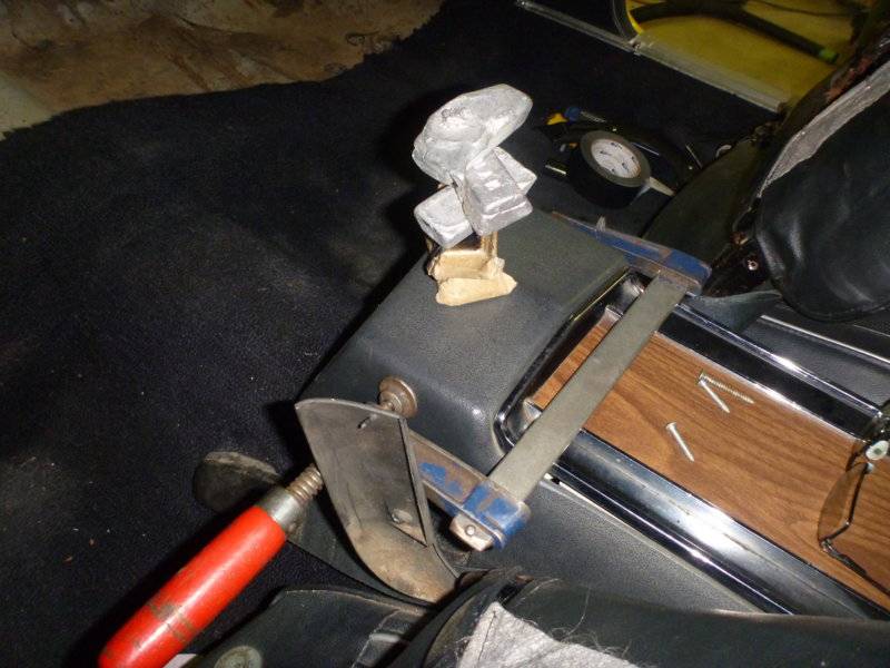

Purolator dropped my battery today, to stuff inside an old script case.
AGM is going inside this, that looks just fine.. even though it froze and cracked in half. Just makes it that much easier to work with and when slid (and bonded) back together it broke so cleanly that you can't even see the crack.
