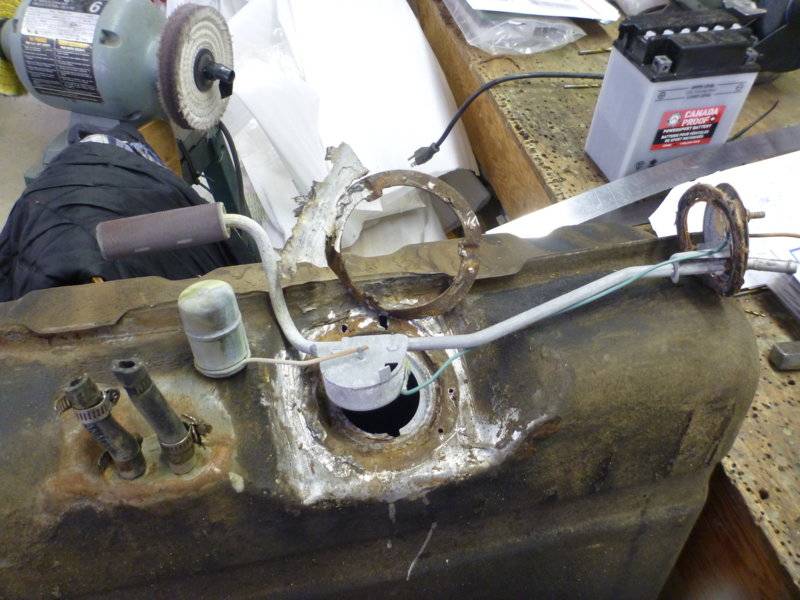

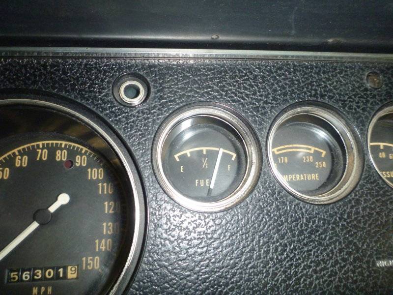

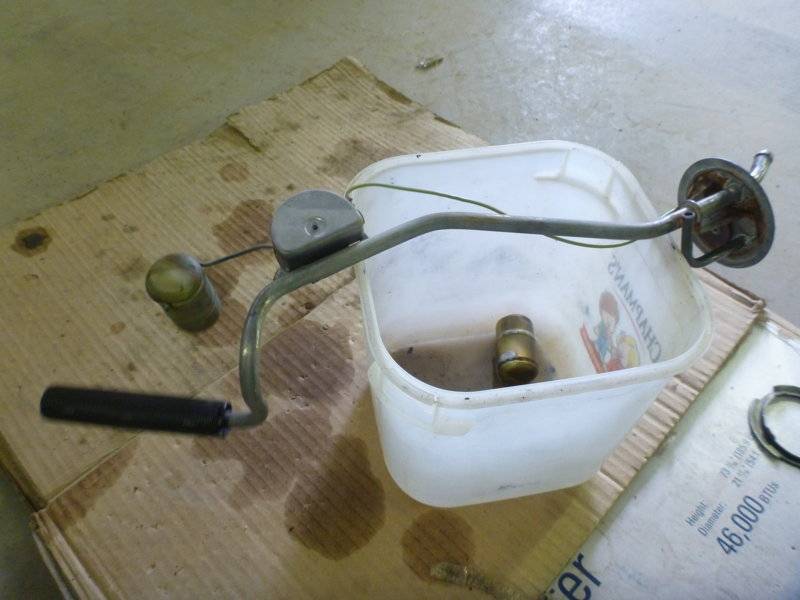

Put the Bird in the trailer for a test run with fuel gauge showing 1/2 tank a couple of days ago and it's worked flawless for months. Took the car out and as I hit the ground the gauge went to zero. Guess I must have missed a pin hole fixing the crack floated and it sunk again or something fell apart. I have no time for this right now, but I can't be running around Bama with no fuel gauge so I guess I'l be burning the midnight oil. Need to leave by Thursday latest..
:soapbox::soapbox::soapbox::soapbox:
Bummer.....better get onto that fuel gauge now. :thumbsup:

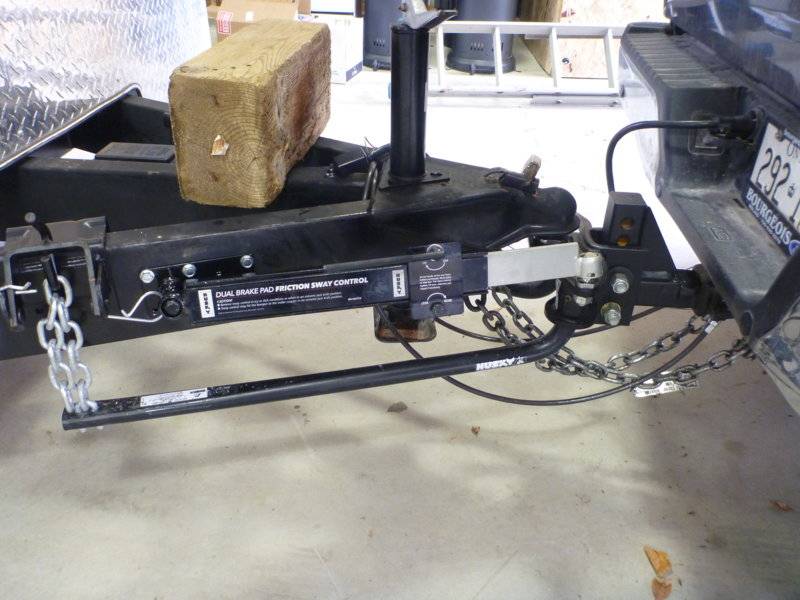

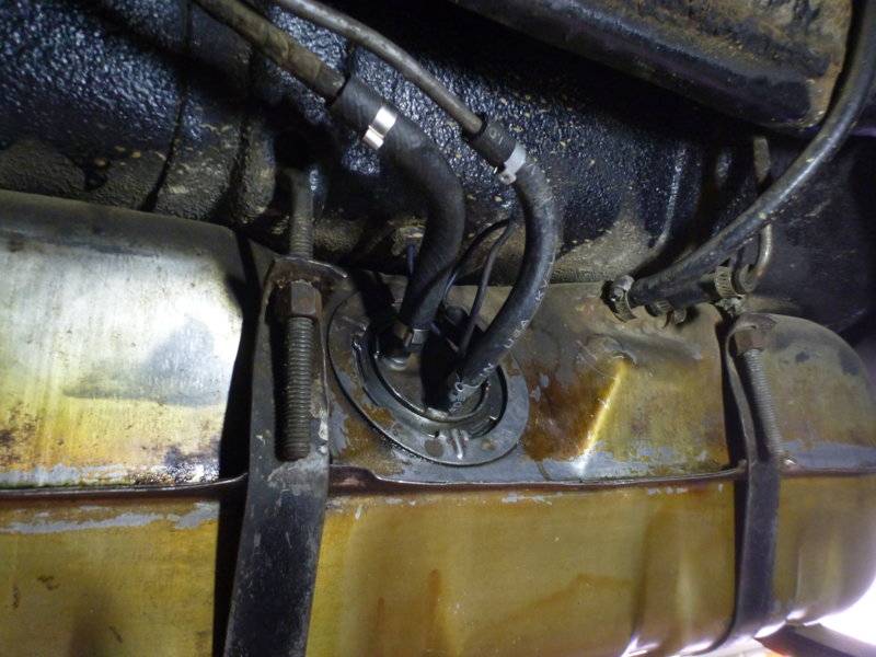

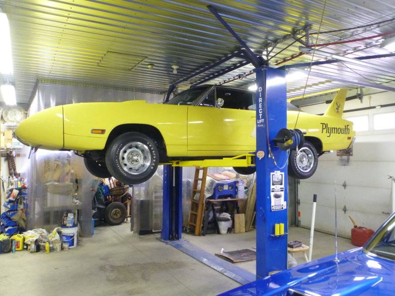

Running in circles Roger between getting the trailer ready, hitch sway attachment installed... but I rotated the cars, Bird's on the hoist. Gauge is good and swings to full grounded out. Sender's at 70 ohms saying tank is empty... so suspect she sunk again. Better see if the old float on the old Bee tanks sender is good... hard part is getting it out since we soldered the bastard in about 40 years ago! Doubt I can find a float in town anywhere tomorrow..
Got the sway bar attachment installed to the hitch and the "Murphy Bed" in place. Then spent 2 hours 15 minutes hammering the fuel sender out of the OE Bee tank that we soldered and sealed in there, many times, over the past 40 years. Thankfully finding a good float. Drained the Bird tank, re and re'd the sender swapping in the old Bee float. Refilled the tank with fuel and I have a working gauge again. Thank God as Leah and I plan on driving the **** out of this thing in Georgia and Alabama, so definitely need a working fuel gauge ! Time to pack!

Was the old float full of gas? Just to make sure you found the problem....:)
Yep.. it was sunk again and had some fuel in it. Guess I missed some of the crack when I fixed it previously. Can't believe it floated for this long though and decided to sink this week... but glad it didn't sink next week! LOL Just glad the old OE Bee float was good!
