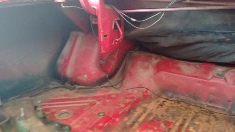

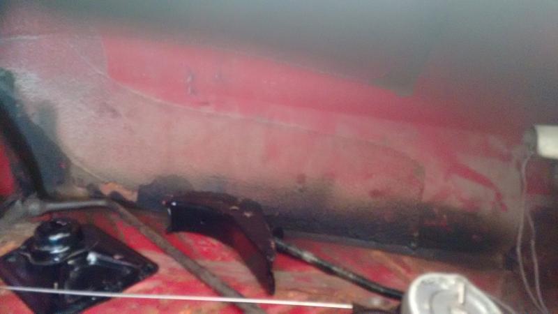

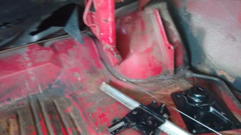

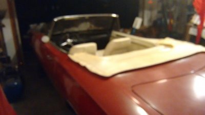

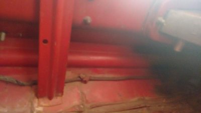

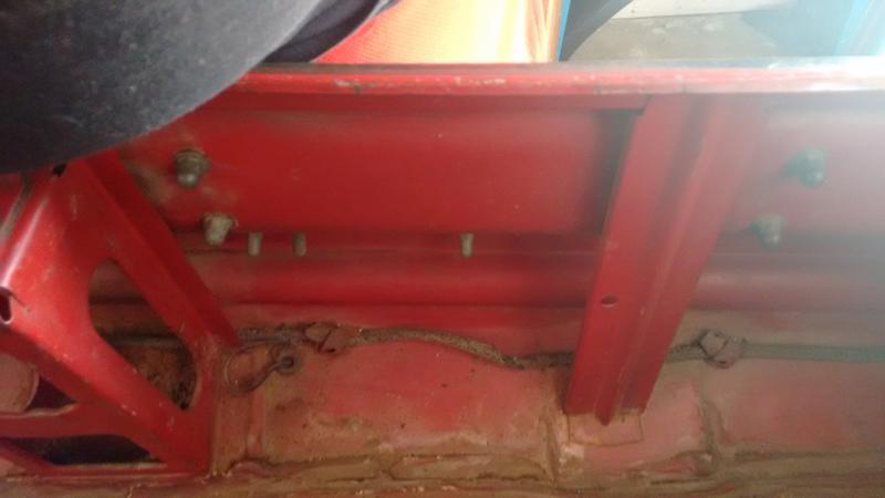

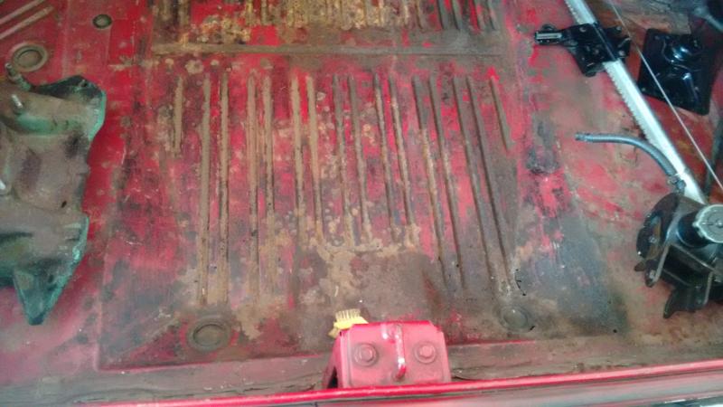

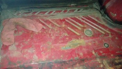

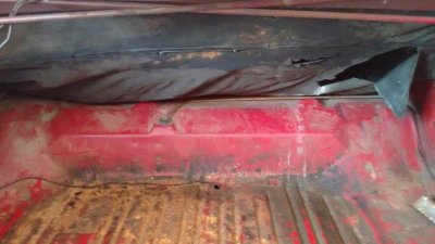

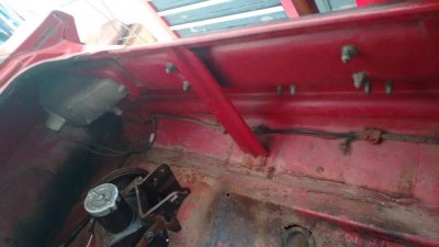

A few weeks ago I took all the parts out of the trunk of the R/T to check out the condition and get some pics for potential buyers and to document the overall condition.
I'll go ahead and post them up here I guess ... I know everyone loves pics, if you are like me I even like pics of rusty gold as the pickers guys say on T.V. LOL
Its fairly solid but has some rusty/scaley in the lower part of the pan. I'm not planning on doing a total resto on this car ... just a mechanical resto and leave it with it's patina and drive it as much as possible like my buddy Dennis H. and some of the rest of you do. I spoke to Dennis yesterday morning and told him I'm getting back to getting fired up over this project. Cheers and thanks for the talk Dennis.
Also thanks much for the early morning chat Kahn ... like you said. Little bites and onen step at a time so it's not such a big job.

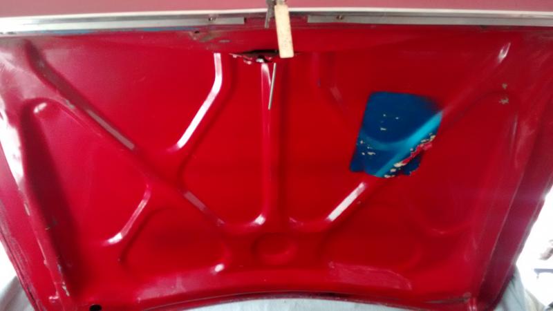

Here's the pics

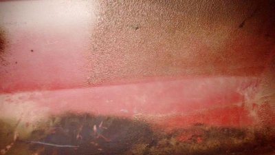

The car is PP1 Red but this deck lid used to be blue .. whoever painted it years ago taped off the jacking instructions ... it was painted in appox 1987 or before. (info from Previous owner).

It's gonna need a new top, rear glass window, and well liner ... and boot cover eventually. When that happens I'll refurb the top bows, and pumps, lines etc and paint the top frame.
But that's much later
Also going to clean up the rust and prep, prime, seal, and paint the trunk floor to keep it from getting any worse and to make it water tight. I only found a few pin hole in the right hand corner but may find more when I attack the rusty area more agressively.

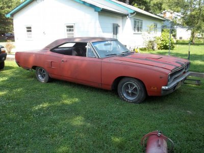

I do still have this car which I will never sell ... doesn't look this nice anymore though. It will get the Hawk-Rod treatment one day once I sort out my present mess

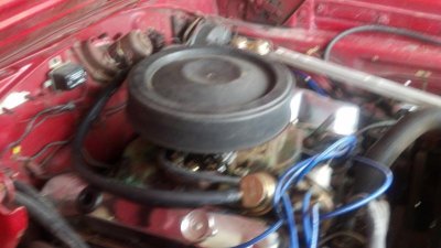

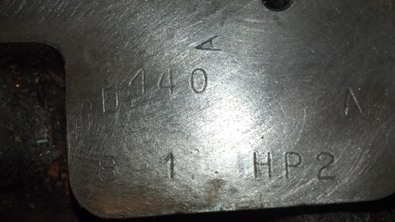

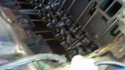

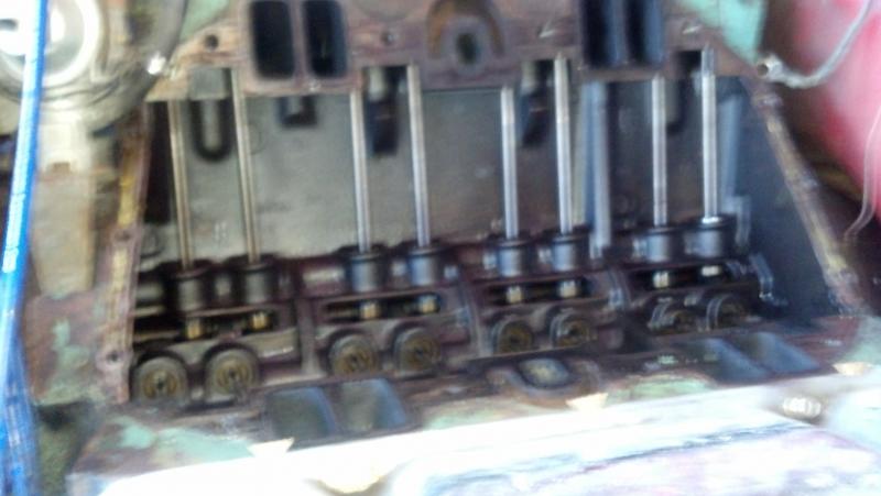

I'll post some engine pics soon if not now. It was leaking so much from the valve covers over the years I don't know what came from where
If I have to rebuild I may go with another 440 I have and get it done as a stroker - ala Prop, Goon, and others ... but that starts getting a little deep into this one that started as a simple spruce up .. famous last words right !

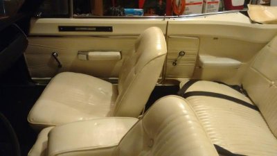

The girls put a lot of time cleaning up the interior ... years of dust, grime, etc and some parts. It was a lot of elbow grease but came out pretty decent.
I know what it's like just to keep a white interior clean, let alone having to scrub years of crud off of them. Try working on a 66-300.

Thanks man and great advice. I love white interiors but if you let them go it can be a lot of work to get them cleaned up. I'm still loving it though.

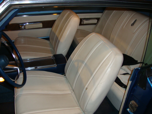

I've kept the white interior on the GTXer presentable by using half water and half simple green on a microfiber towel...and for the deep dirt, a green crothbrite very lightly in small circles!! :pimp_daddy:
Love that car ... looks great Mar

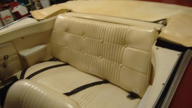

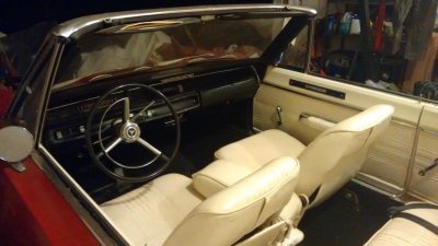

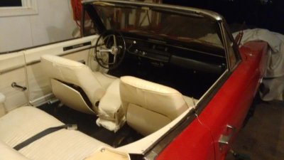

Here are some pics of my interior .. not great shots but what I have.
The seat backs seem warped so they will need to be replaced eventually or something donet to make them look better than now.
The only rip in seats is the buddy seat has a split seam. I have an upholstry guy who should be able to take care of that easily.
The materiel is not original looking but they pattern matches the factory style ... again dates to 1987 or before. Door panels are originals and look OK. I will definately pull the seats and carpet eventually to see what the floor looks like from the top, and do some patching of what I find. Then new carpet and new seat spacers ... current ones are broken.
I'll probably get legendary covers eventually but that's going to be a later.

A lot of these pics were taken before cleaning was done or finished ... during the cleaning actually.
