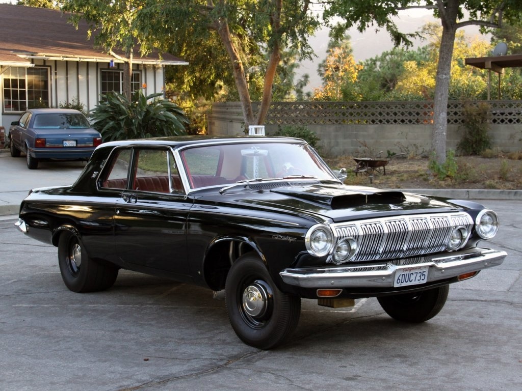

Steve, here ya go:
Mosher's 63
This is the look I am going for on my 63 Polara
Dale Reed built my engine, he does all of Bob Mosher's (I helped)

Thats so badass! One day I'll sell the 64 Plymouth HT and get a 63 or 62 dodge sedan. Or maybe if life goes well I'll buy both haha (lottery fingers crossed)
