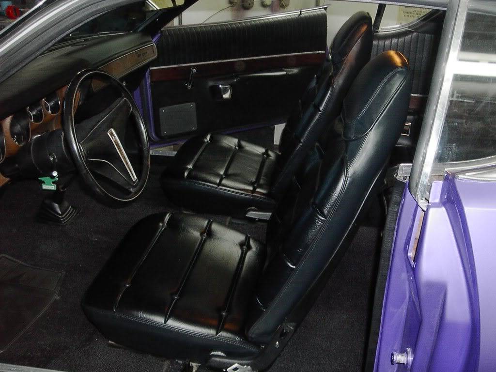

Overall, the body is in great shape. It now sports a Plum Crazy paint job. It had the incorrect 73 style seat covers which I have since replaced for the correct 71 covers. I also have put the vinyl roof back on.

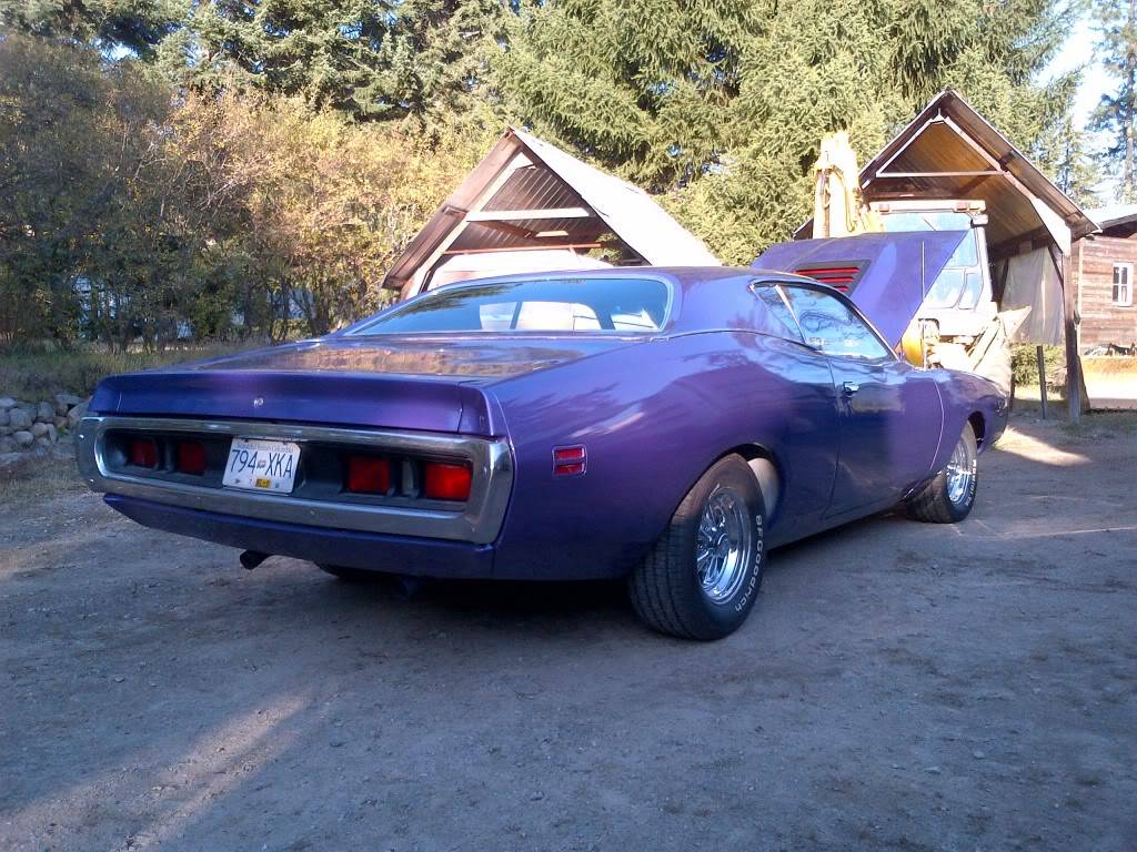

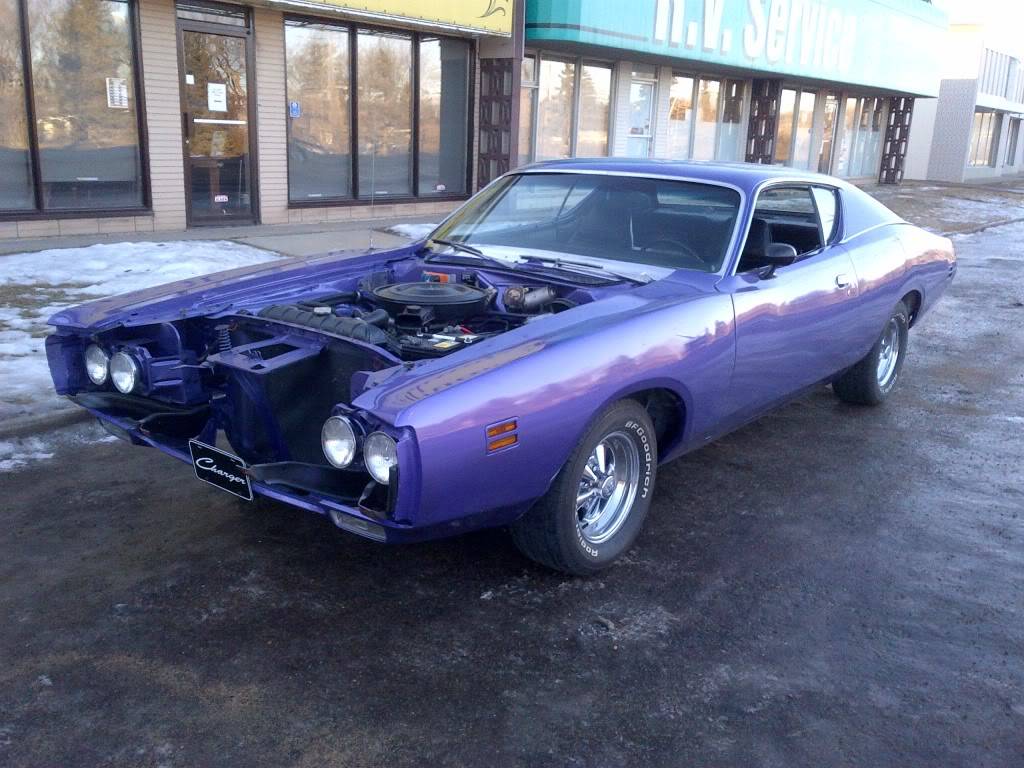

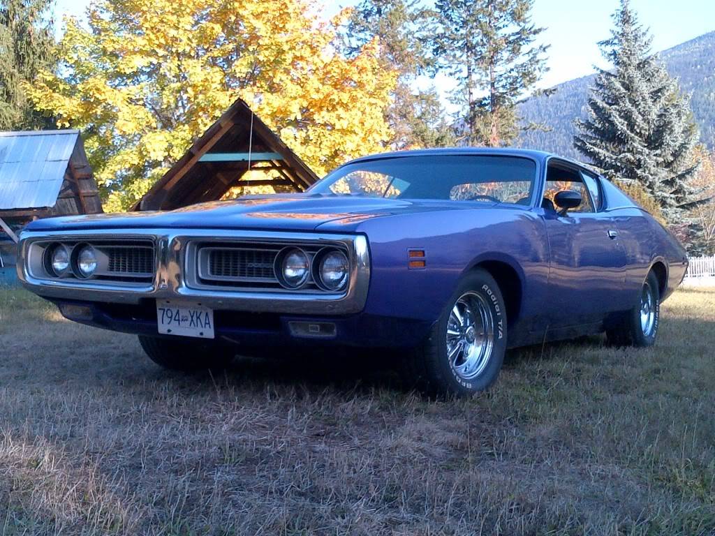

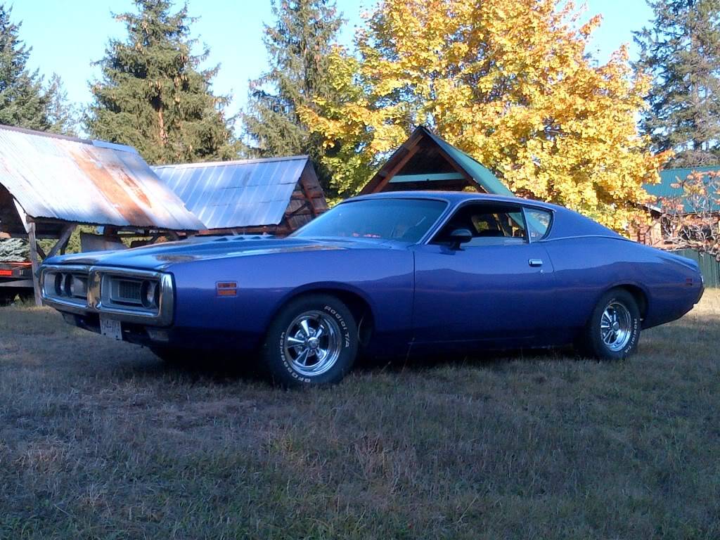

Here is the car how it came to me.

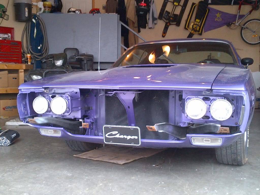

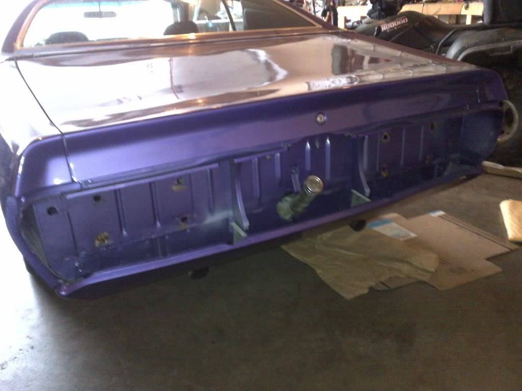

I have a new valance with exhaust cutouts to go with the tips.

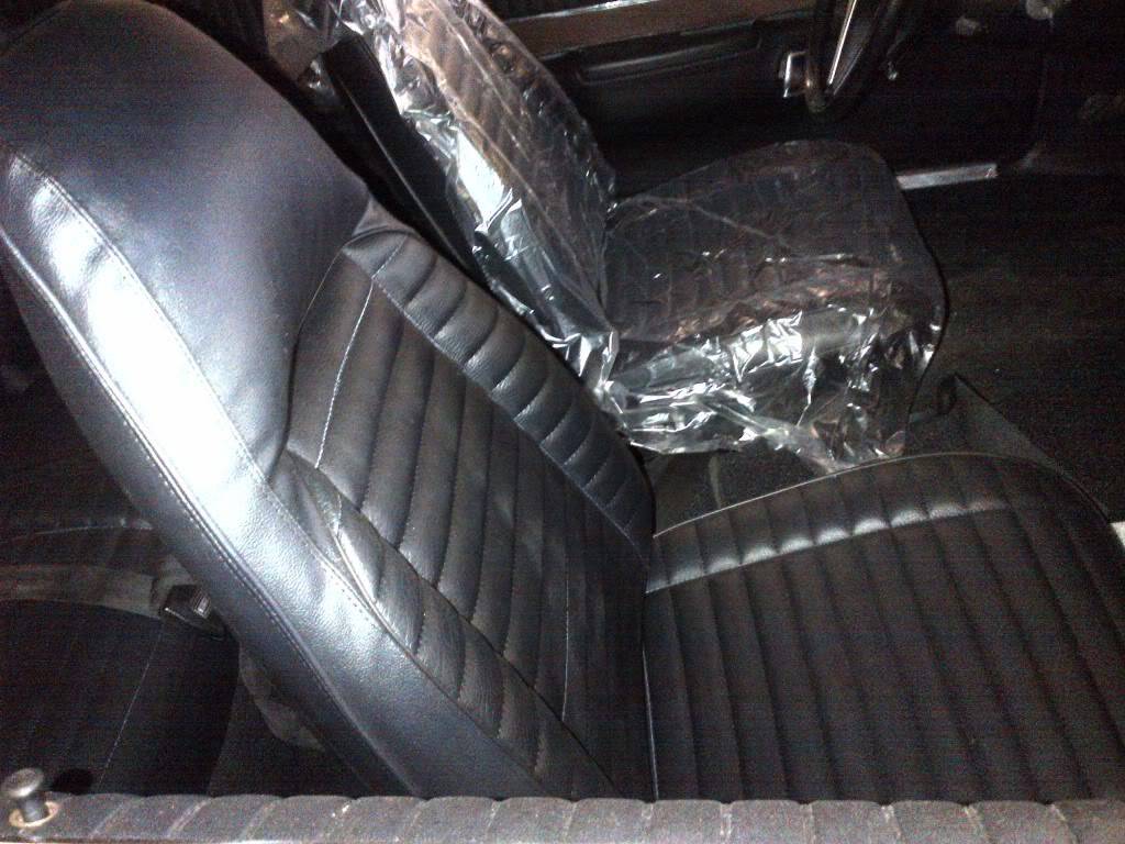

Interior with incorrect covers on the seats.

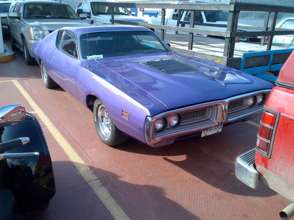

On the ferry for the ride home. Drove it back. :D

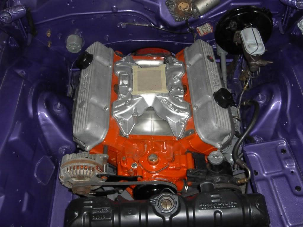

A shot of the 400 that is in the car. Out it will come to grow 100 + cubes.

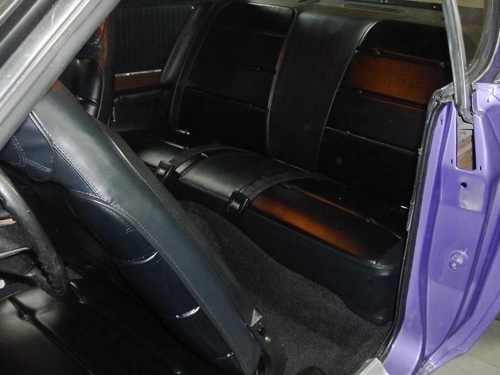

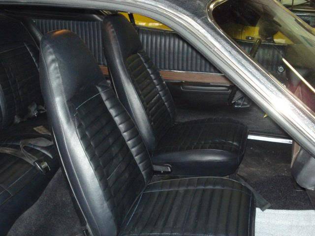

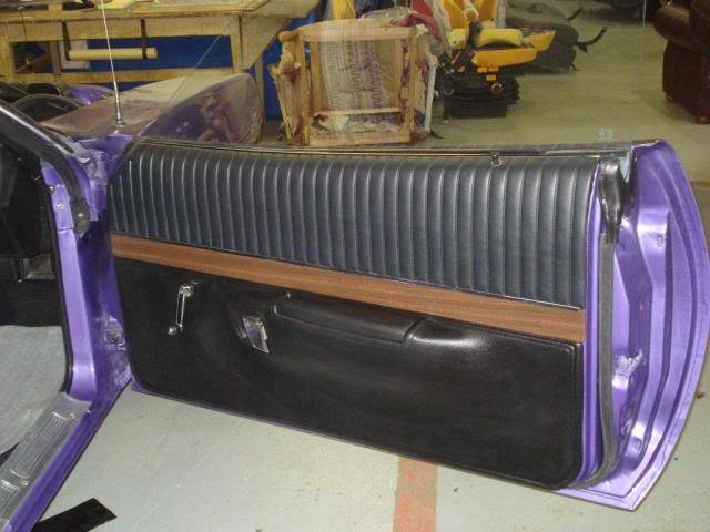

It now has the correct interior.

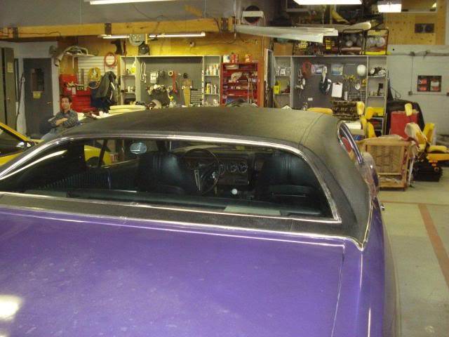

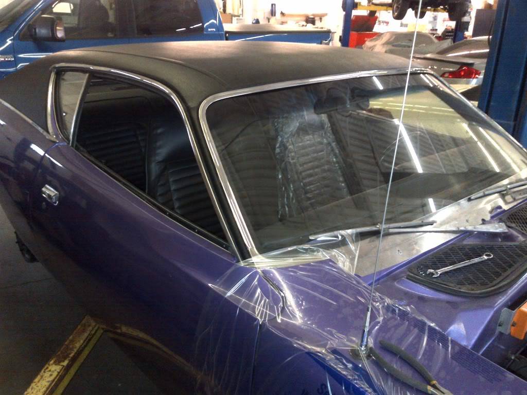

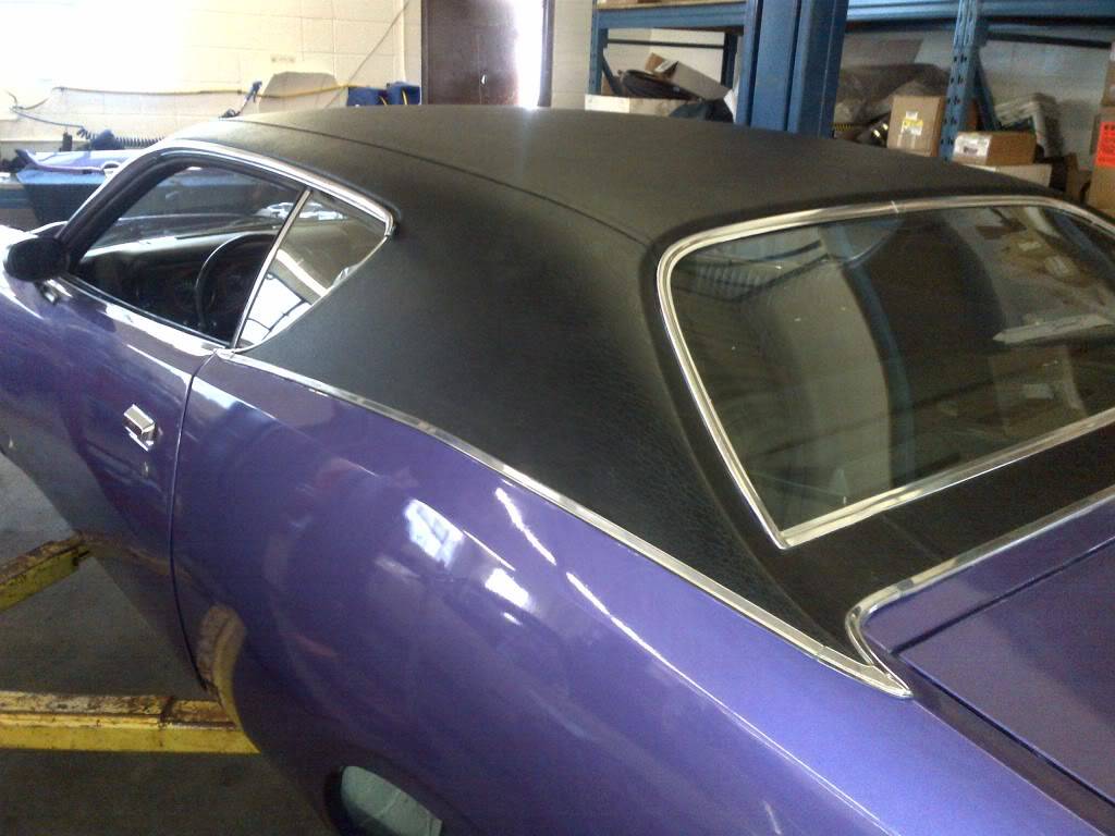

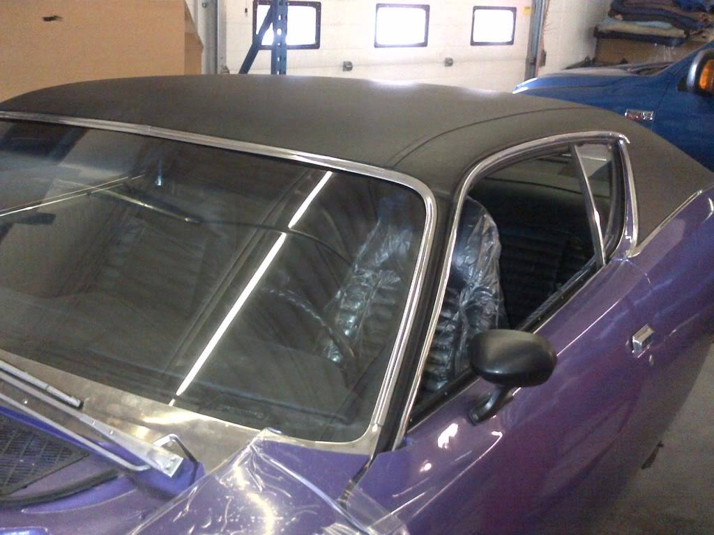

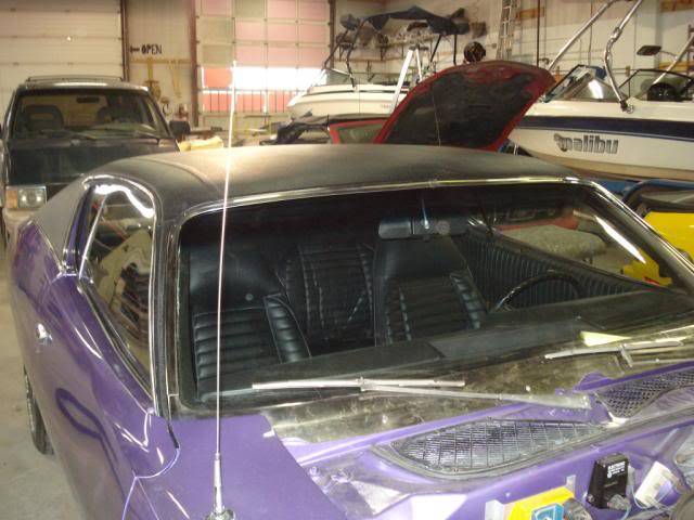

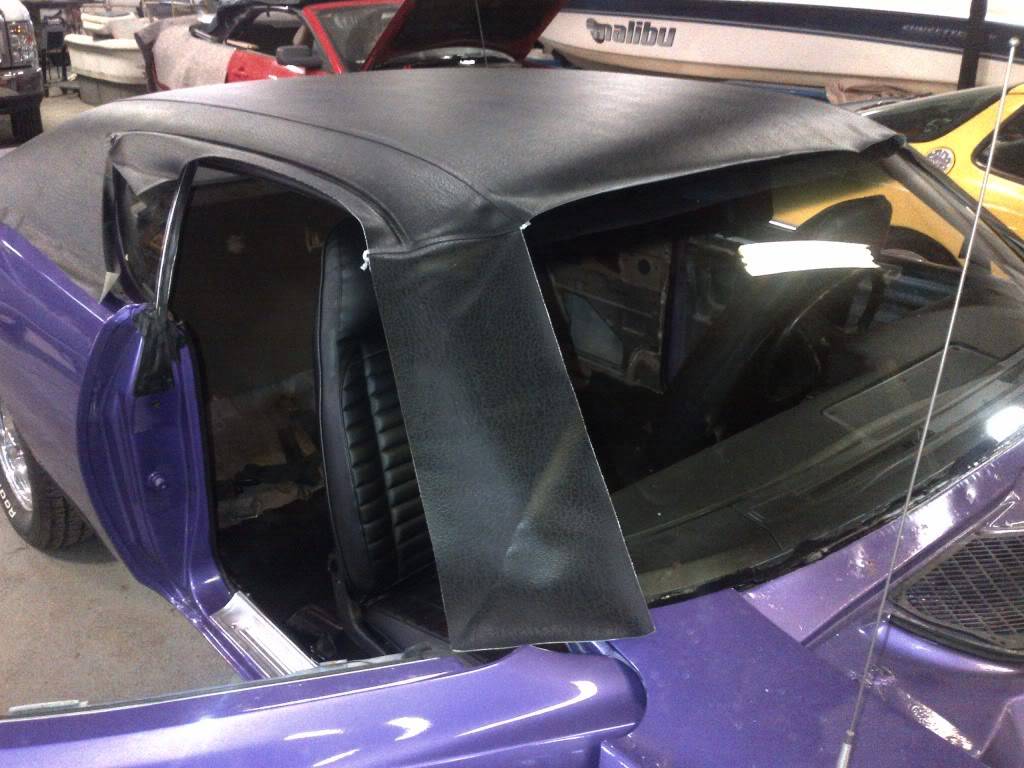

The vinyl looks great too. Last photo before it goes on.
The start of the vinyl.
Finished result.

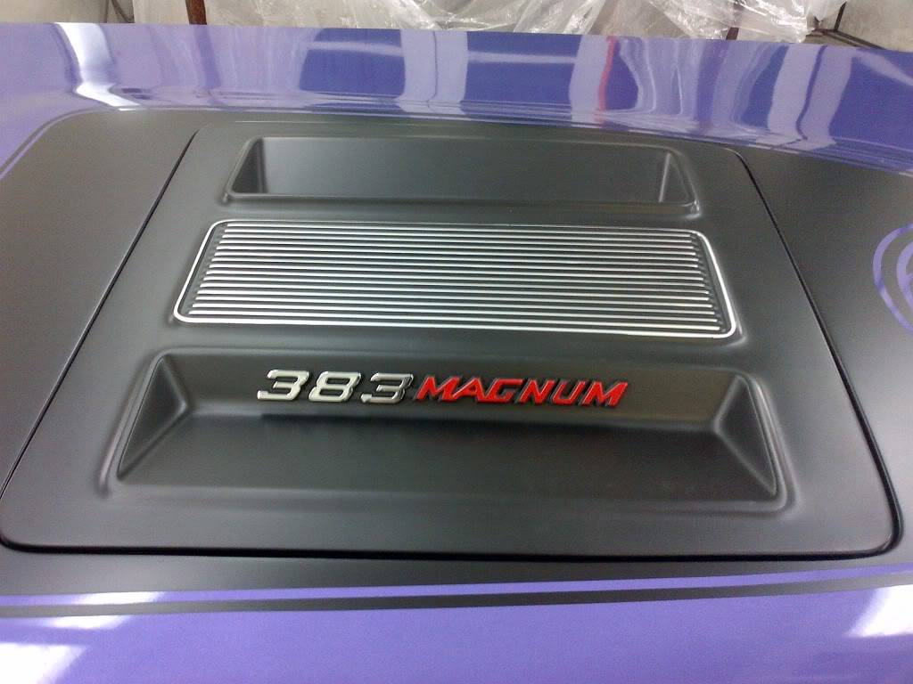

The hood with the bulge & the insert finished.

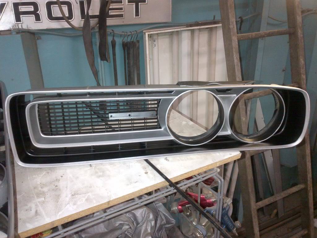

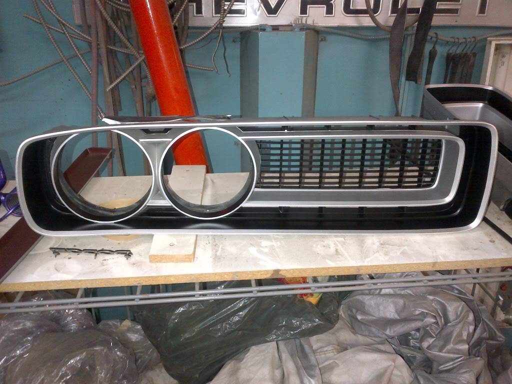

Grill looks great.

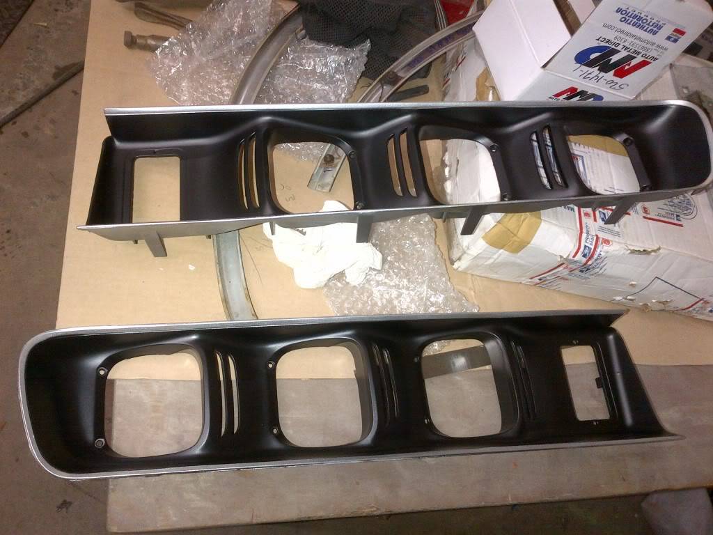

Tail Light bezels look good too. I did the edge in silver, quite like it.

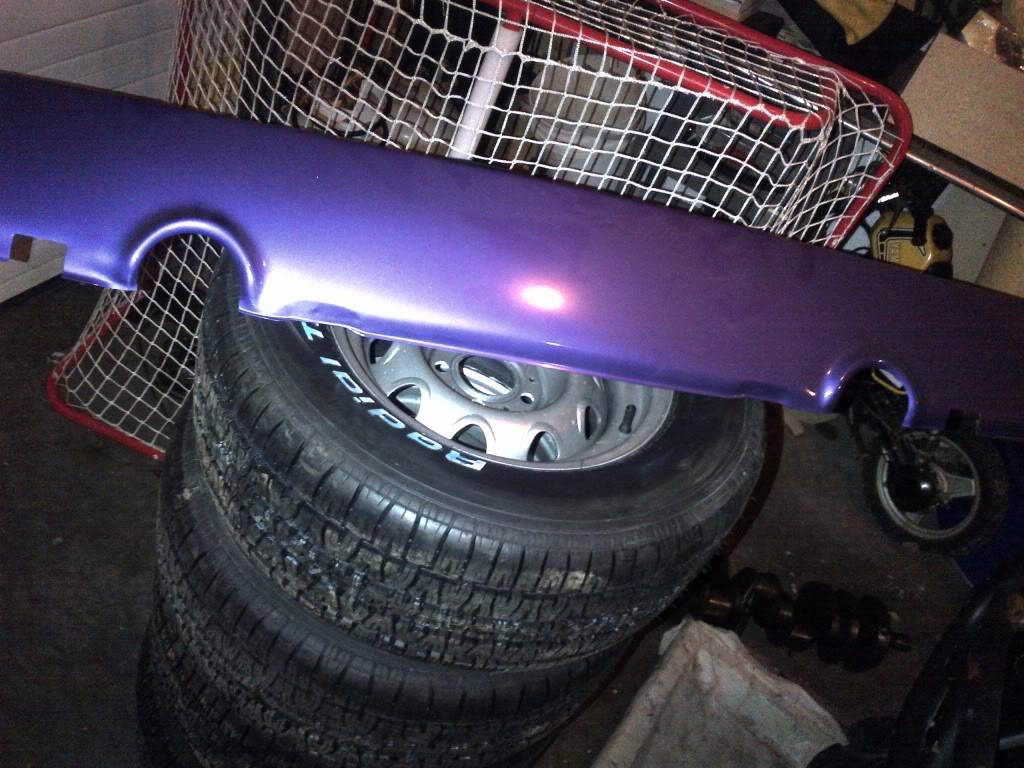

Here is the rear Valance with exhaust cutouts for the machine gun tips. You can see the Rally wheel wrapped In BFG's underneath.
Beautiful car buddy! Inside and out thats a winner there, your interior looks almost new in it, those bucket seats are really sharp... Inspirational pictures for sure.... Please keep updating, love it.

The shop was busy & didn't get the engine or tranny out yet, but dang the vinyl is SWEET!
Love the body condom :D

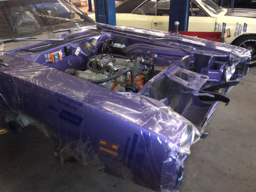

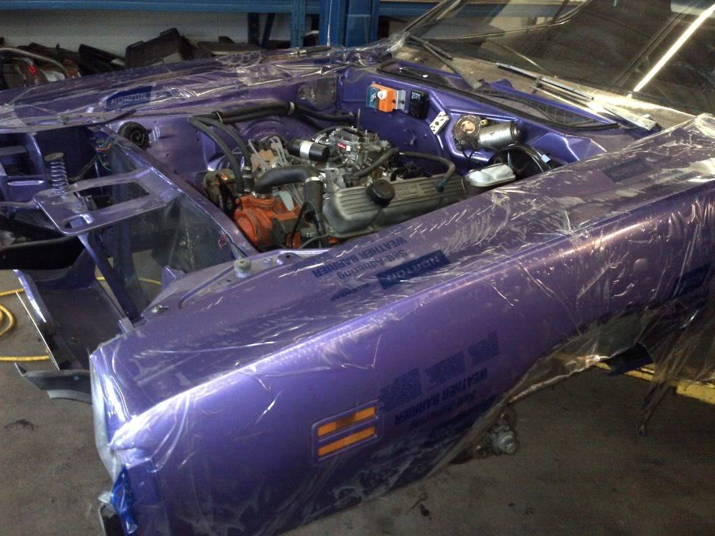

A start to getting the engine out, well the rad is out ;)
Seats look as good in person too!
