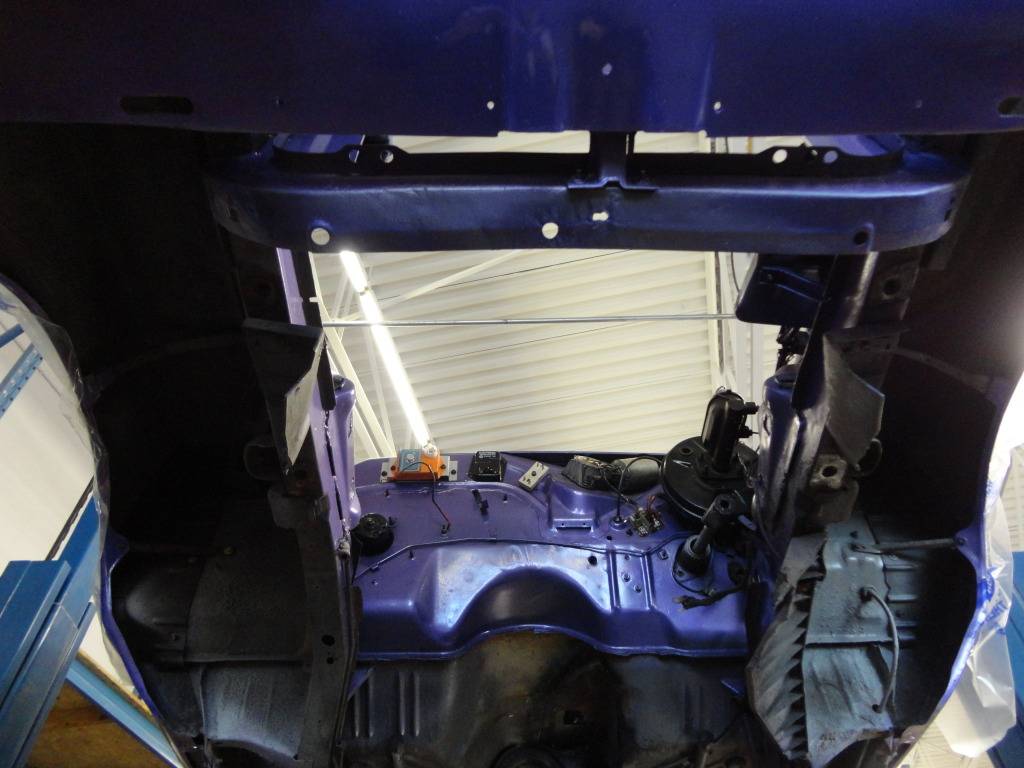

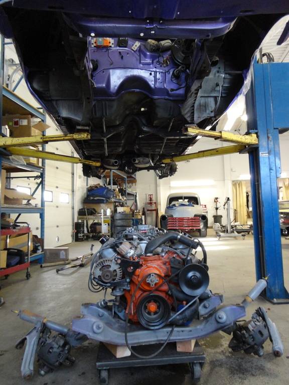

Engine & Trans coming out. As well as the K-Member.

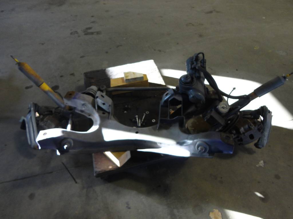

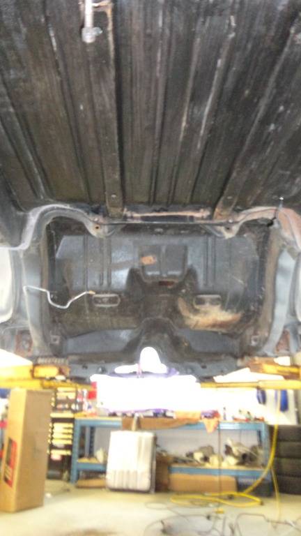

Engine & K-Member is out.

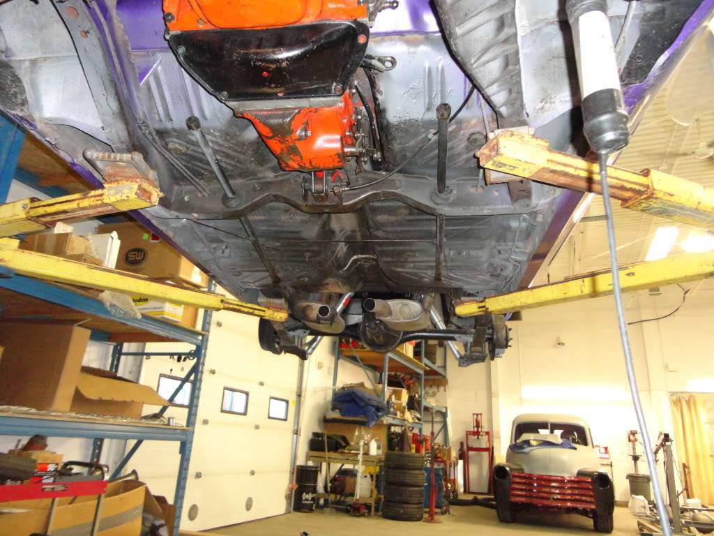

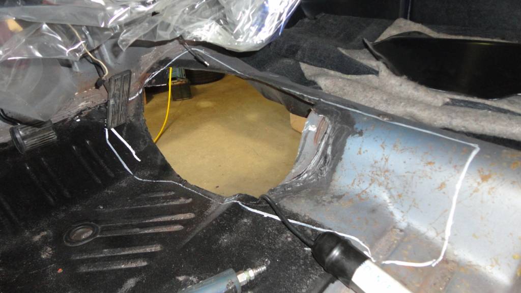

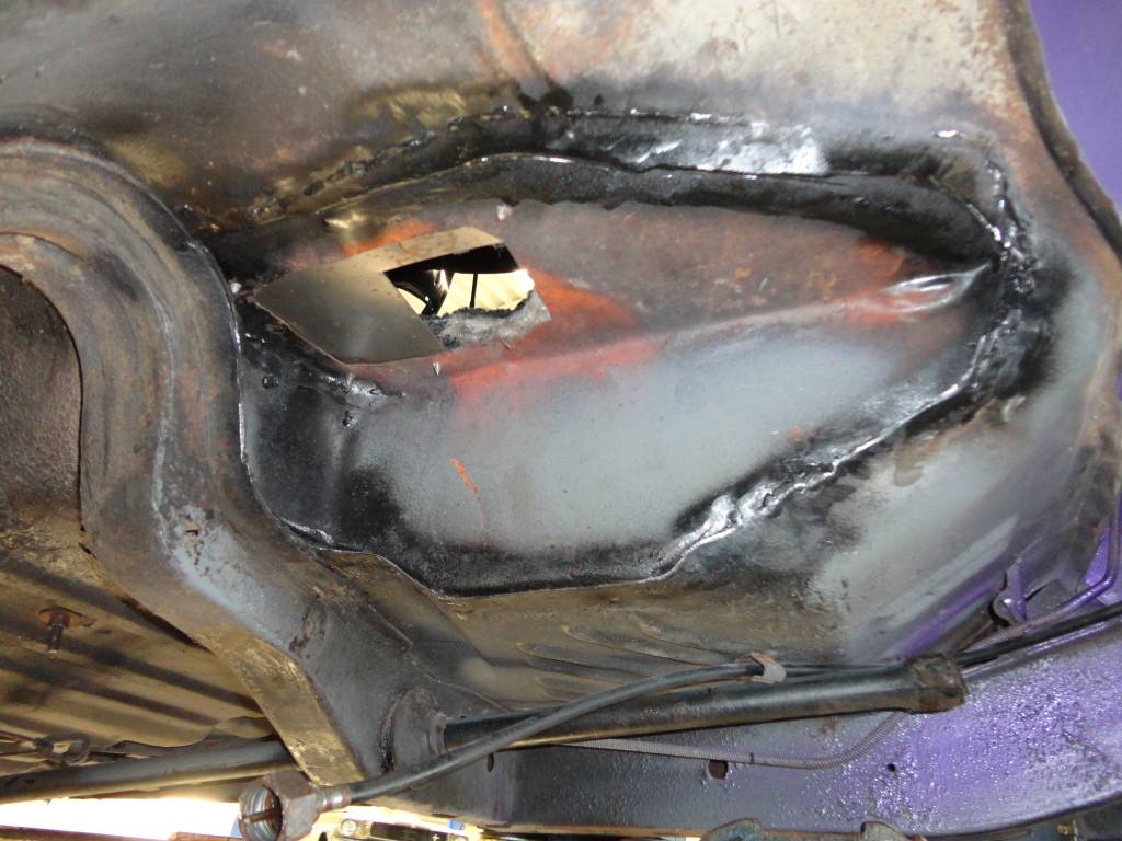

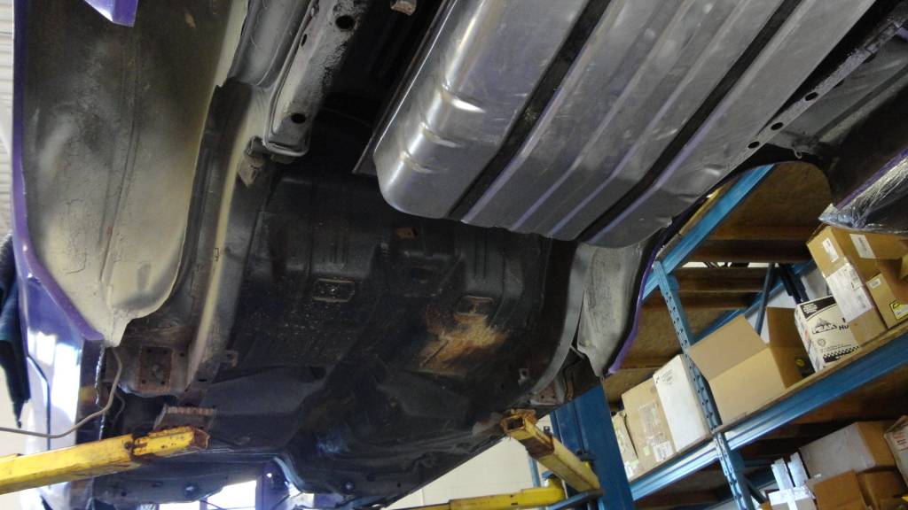

Some people should not be allowed to work on cars. What a butcher job. Thankfully he didn't cut into the cross member & it can be fixed with the correct console shift position tunnel.

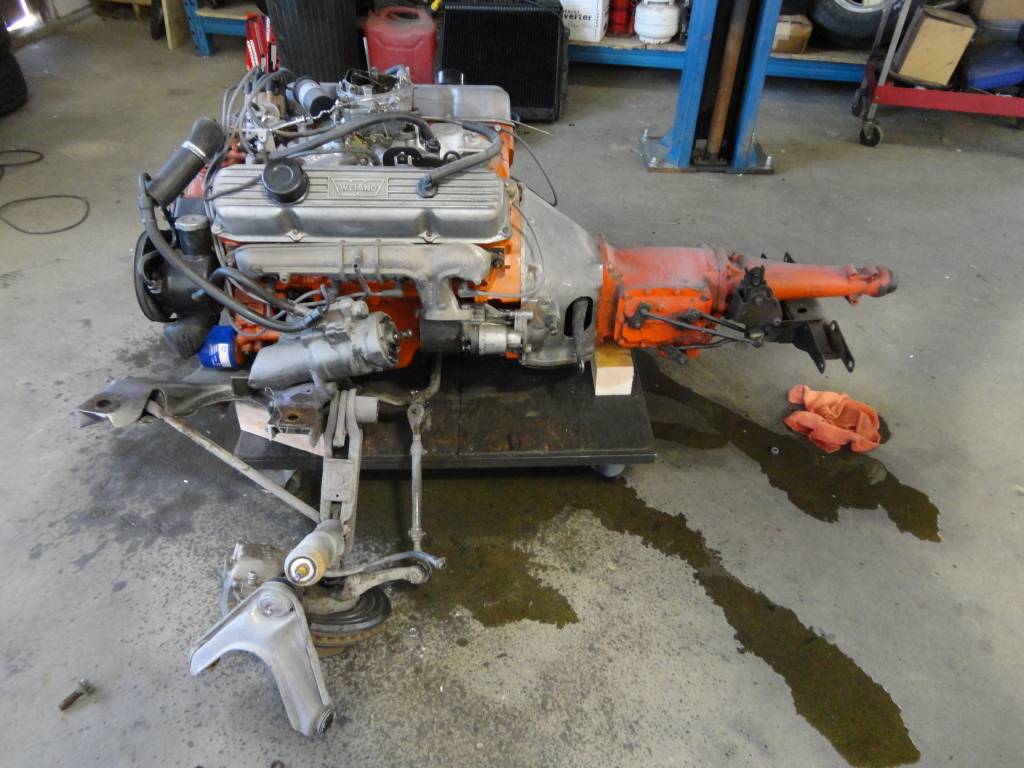

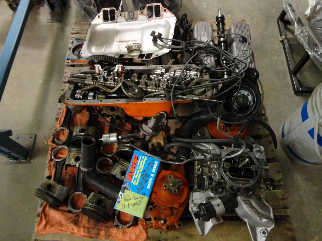

A pile of parts. I guess the engine had some issues as well. Good thing I pulled it as it probably would have left me on the road. Again, some people just shouldn't touch cars.

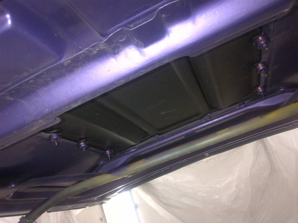

The insert is fastened to the hood. Looking real good.

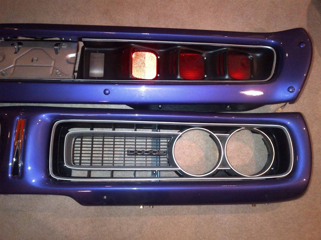

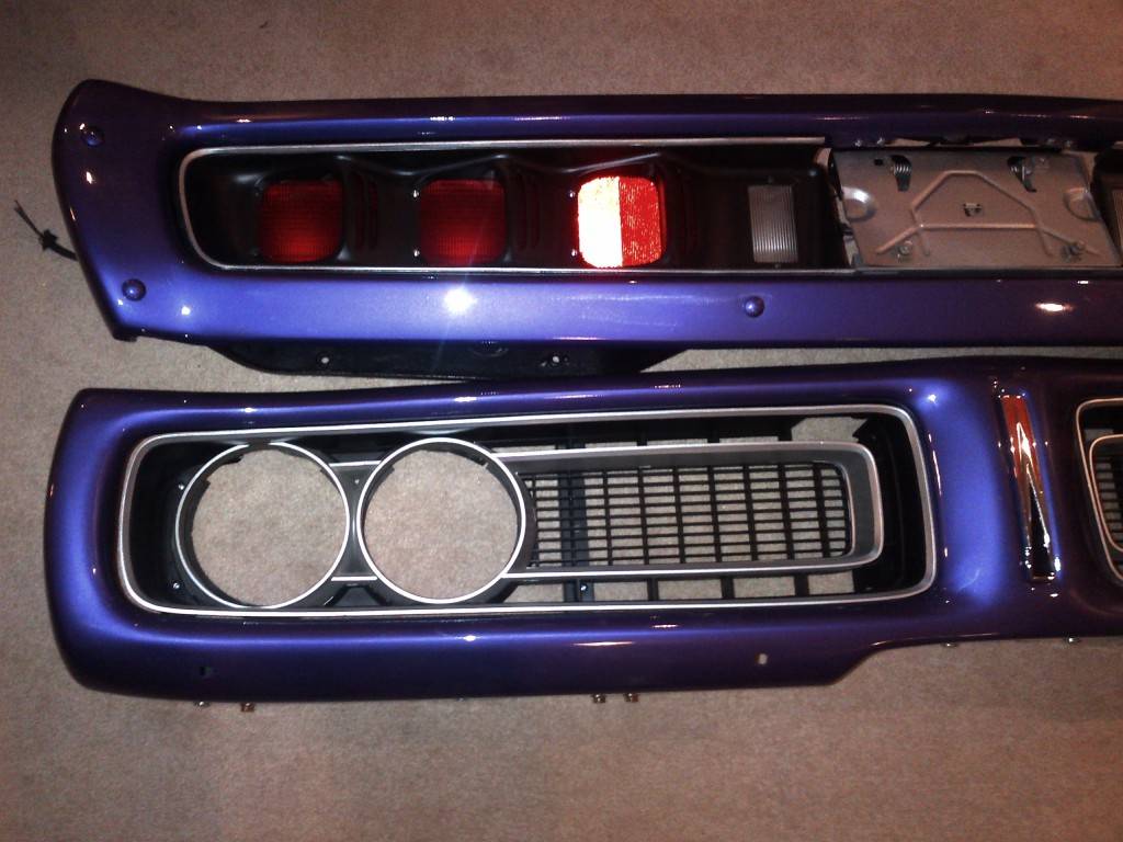

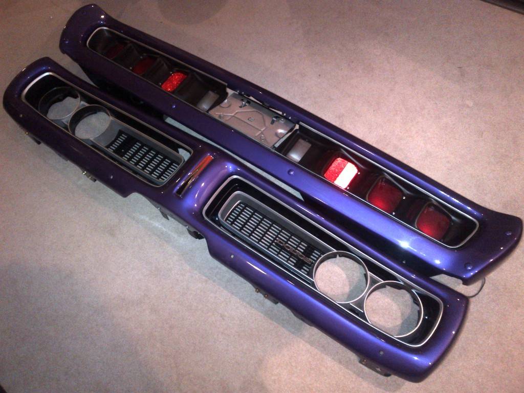

The Bumpers are all assembled & ready to go back on the car. I will run them to the city on Monday.

I do have two quick questions about your insert as I have the identical one and need to stop it from leaking and have new emblems without fasteners.
1) What did you use as a gasket between the insert and hood?
2) What type of anchor/fasteners did you use for the emblems?
Thank you kindly!
Troy
I actually used windshield butal seal. It comes in a roll & can stretch & bend to any shapeit worked real well.
I just used speed nuts for the emblems with 2 way tape behind.

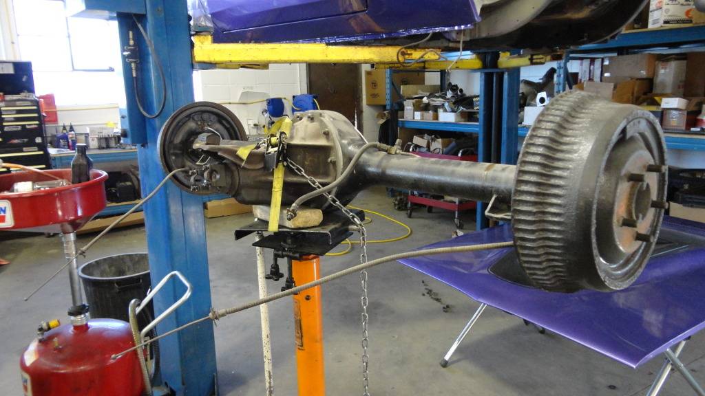

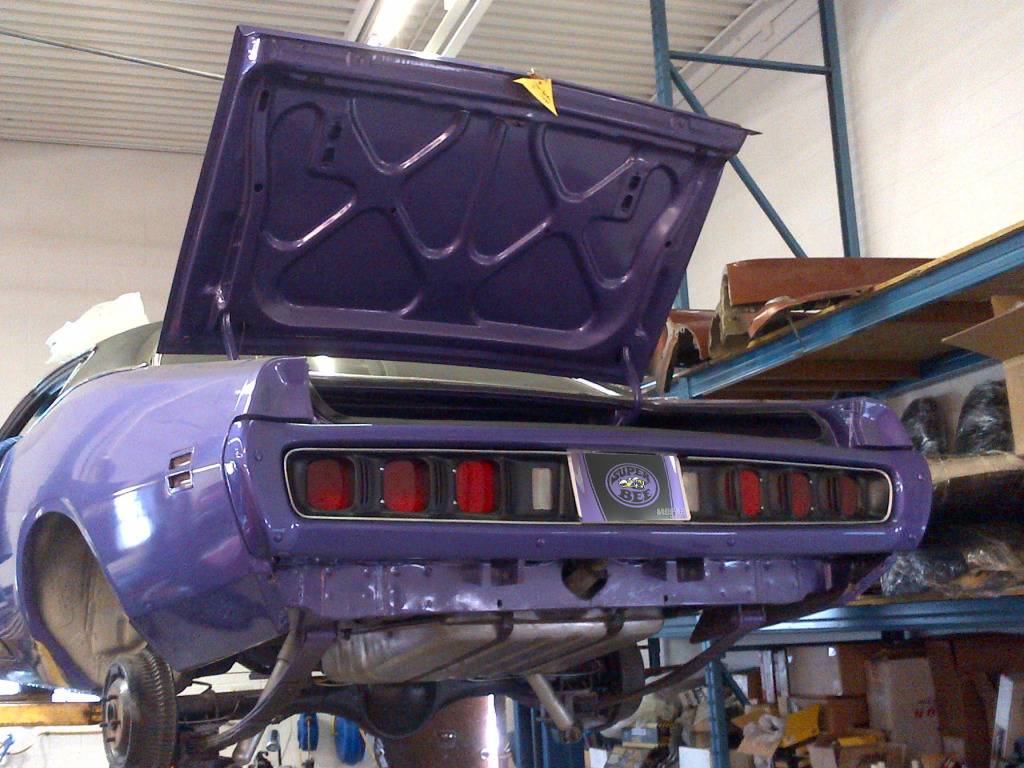

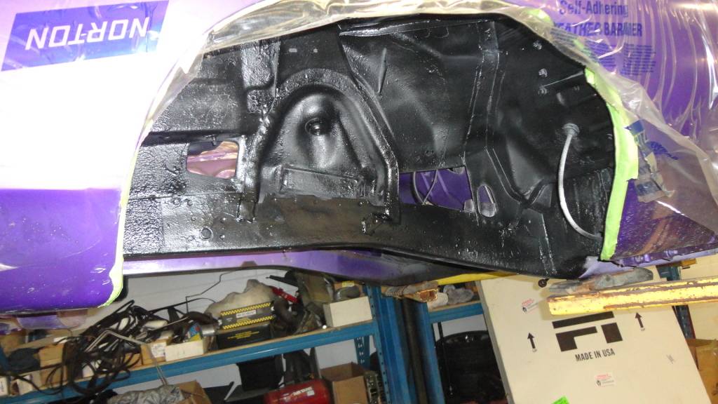

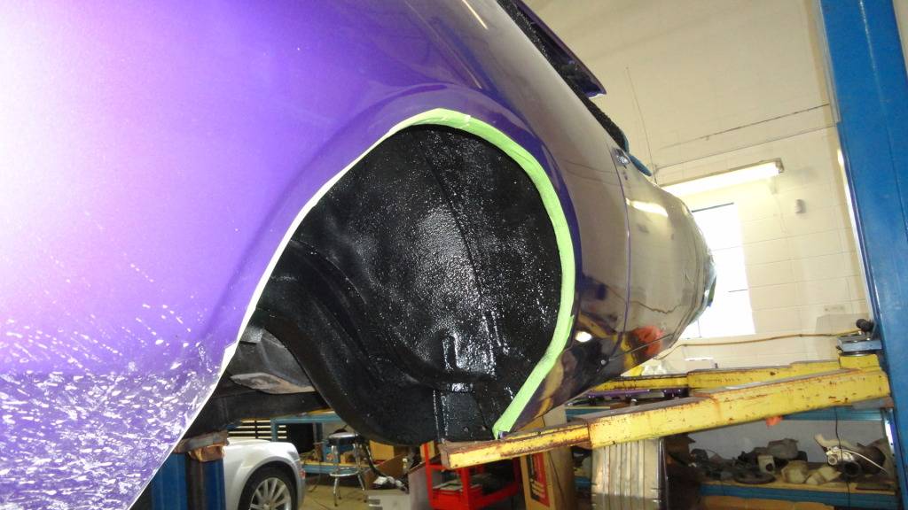

A few more updates. The rear end is out. New springs, shocks, disk brakes and a 3:91 ring gear to go in it.

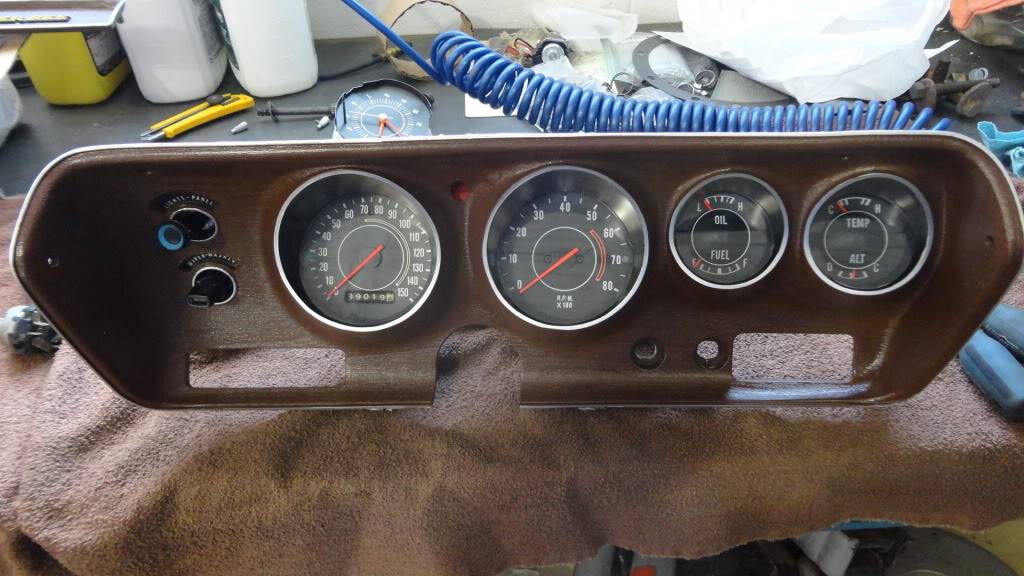

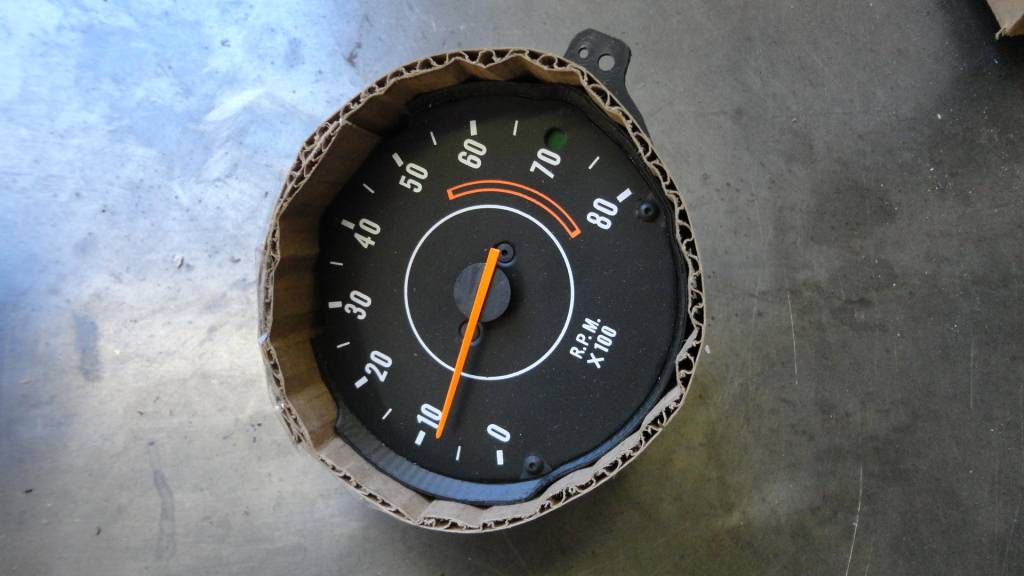

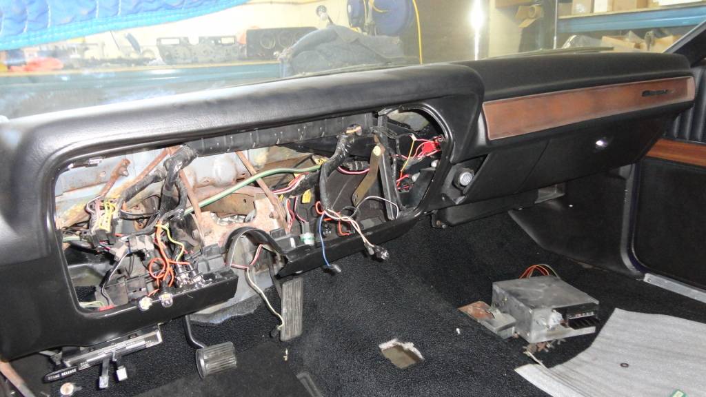

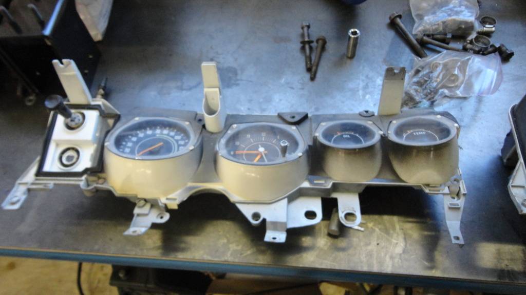

The dash is out too. Replacing the clock with a tach. Putting new pedals in and a tilt column as well.
Getting excited for summer!!!!!
The Rally dash now has a tach where the clock was. Looks great. One step closer. Getting excited.

The front end is prepped for the RMS front end kit, as well as the rear end is prepped for the super stock springs. New brake lines and a 3/8 fuel line to go in as well. One step closer.

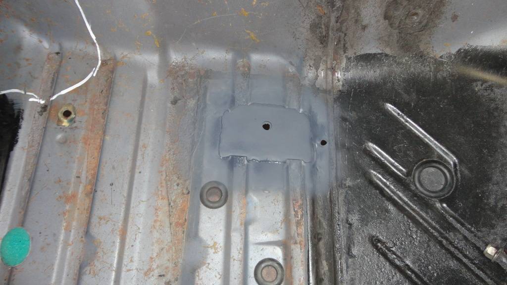

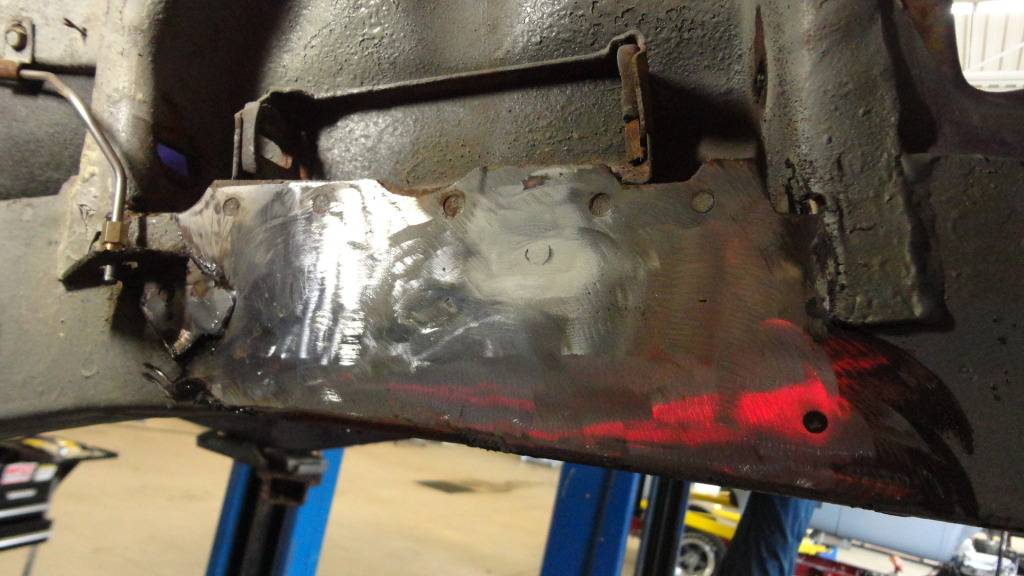

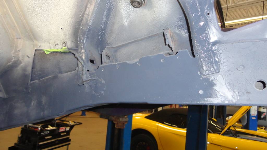

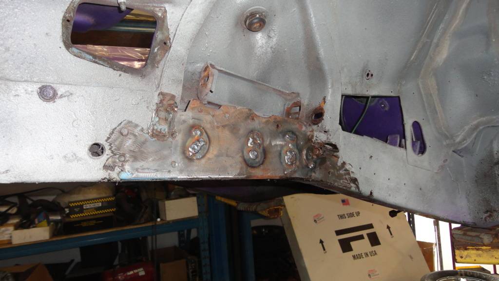

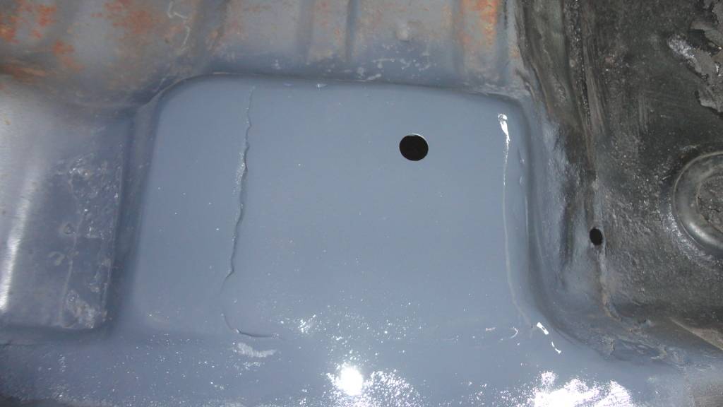

Here is the floor being prepped. Bucket seat plates welded in, small floor repair and the tunnel being fitted for the proper console shift position. Another step ahead.
