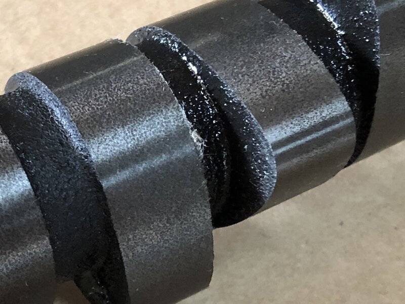

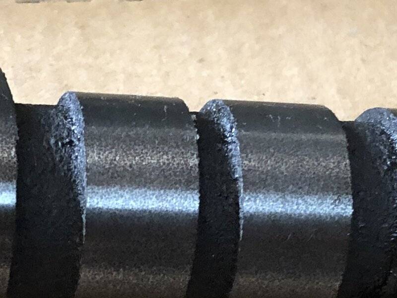

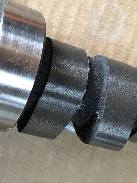

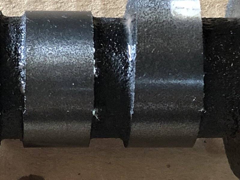

I had to dig to find the pictures but this is the Comp Cam that I bought and returned. You can see shreds of cloth stuck to the unfinished edges of the lobes.
Thanks! that isn't good. It makes me want to pull an original from another engine here and put it in. is an original 1968 cam still be serviceable?
