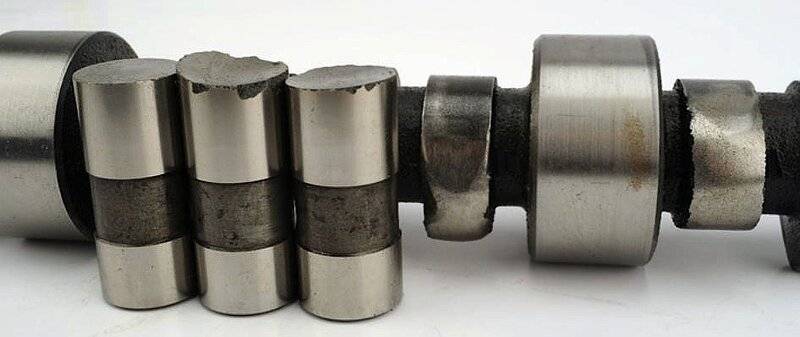

There's a thread over in Engine, Trans & Driveline about new wiping out lobes/lifters on new cams during break-in. I'd like to get an idea of how big of an issue this is, and see if there is this is more prevalent with some brands of cams over others.
If you have installed a new cam within the past five years, please participate in the poll and also post the brand, how long ago you purchased it, if you had any issues, what break-in procedures you followed, and the part number/specs (if you remember).

Apparently an old lifter (non-roller) will wipe out a new cam...
So confirming all are in fact “new” needs to be a part of installation procedures?
And then see if people still have cam problems if they check the lifters?
If the video from UTG is accurate, the cam problem is pretty broad, across various manufacturers
I would lean more towards improper machining of the lifter face than a huge rash of returned lifters being placed back on the shelf. He said there are only two manufacturers left, anyone know who they are?
oh sorry I meant various cam brands, are getting wiped out; doesn’t seem specific to any company
so kind of points in the direction that old lifters are taking out new cams
I don't think there can possibly be enough people returning used lifters to account for all of the wiped cams. But if there are truly only two manufacturers of lifters out there in the world, and one of them is not properly machining the lifter face, that would do it.
Whether is a used lifter or an improperly machined one, both cases would need similar inspections
It only takes ones bad/old lifter to take out a cam
So worst case is a person returns 16 used lifters, and 16 new cams die
