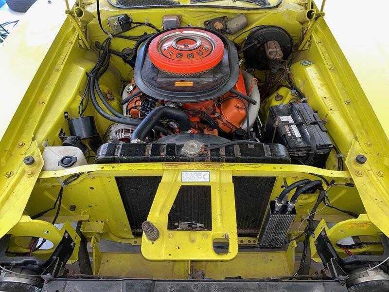

How can a Charger really be a Charger, if it cannot Charge? In addition to always having to charge its battery with a Schumacher charger in the garage, with the lack of charging, it really can’t even charge forward all that well. My goal is to discover why this Charger has been chargeless for years, and get it charging in a respectable manner again, like it once did when the original owner drove this 1971 383 Magnum powered Mopar home in October of 1970.
At this point, from my research thus far, I predict that the reason for being Chargeless is due to electrical modifications by previous owners that were done incorrectly and/or very badly. Age of wiring and connectors could also be a contributing factor.
Previous owner said alternator and voltage regulator were replaced several times over the years, and each time charging would occur, but for a very short lived time. It would always soon return to the chargeless state it’s in now..
The last professional mechanic to troubleshoot the charging system on this car decided somehow, in his ultimate wisdom, that he should install a FORD voltage regulator on the car. I don't know what he expected a Fix Or Repair Daily voltage regulator was going to do for the car except butcher the factory wiring harness.

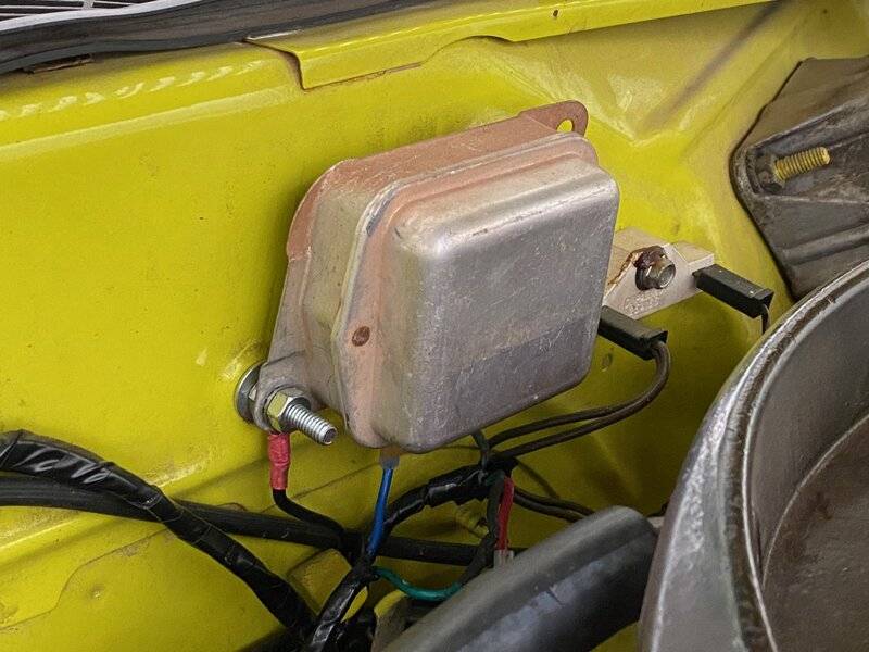

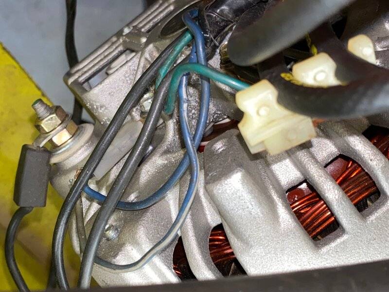

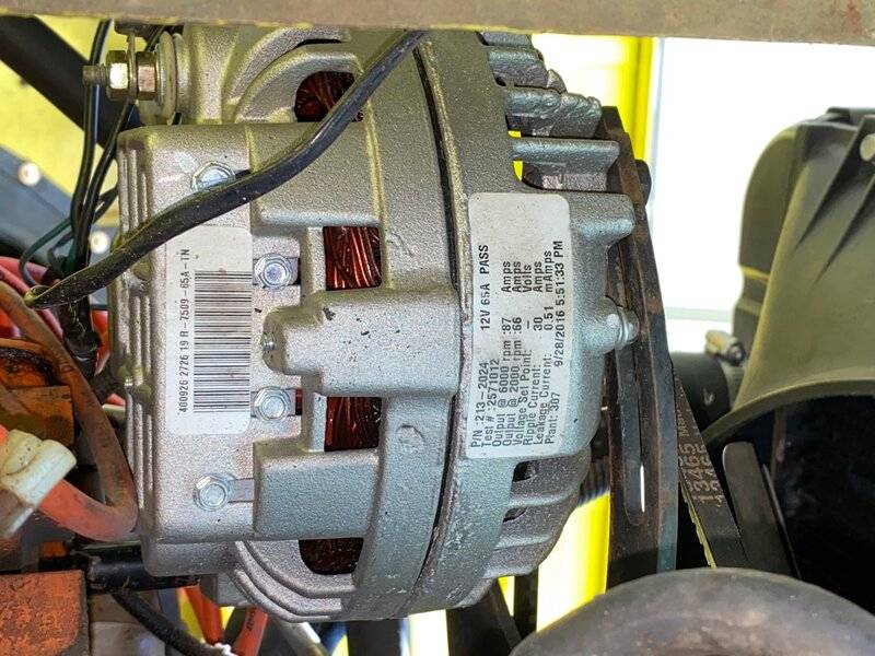

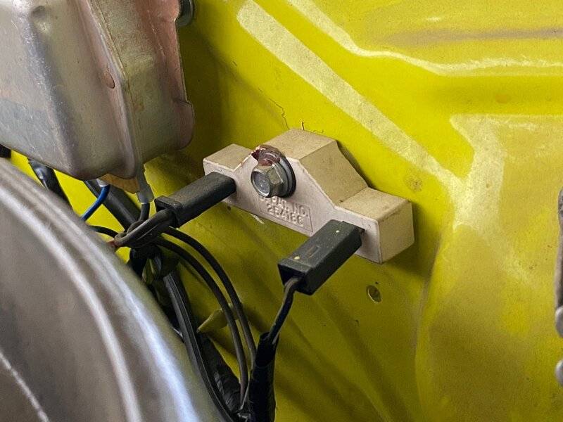

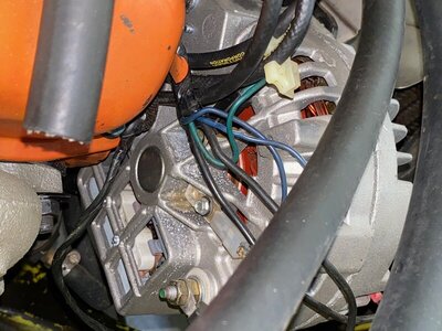

So this is the state of the current system. Ford regulator, 1972 and later style Chrysler alternator rated at 65 AMP current output. Electronic ignition, with factory style distributor and a single style ballast resistor. Fusible Link is present at starter relay. All gauges in instrument cluster function INCLUDING the dreaded AMMETER gauge.

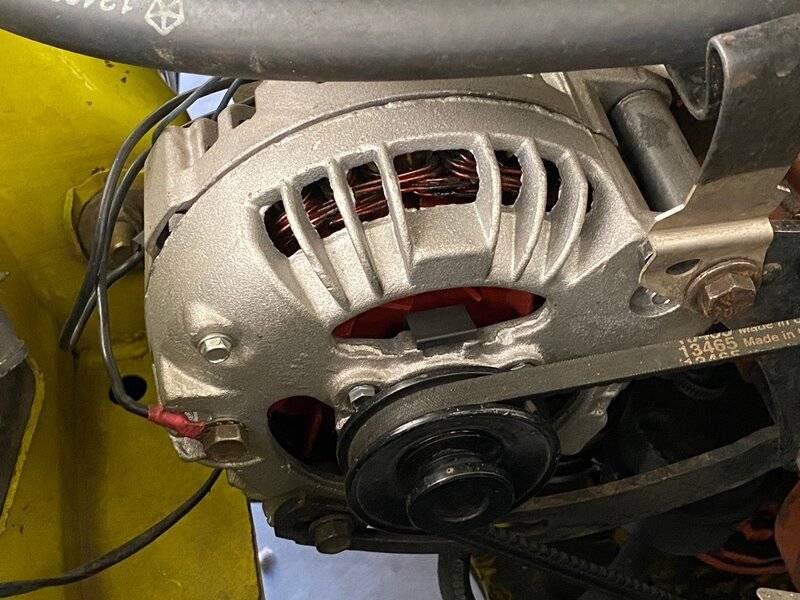

Alternator was remanufactured less than four years ago, when its tested output was 66 amps at 2000 RPM, and 87 amps at 6000 RPM. NAPA battery purchased new exactly 3 years ago, rated at 1000 CCA at 32 F and 800 CCA at 0 F.

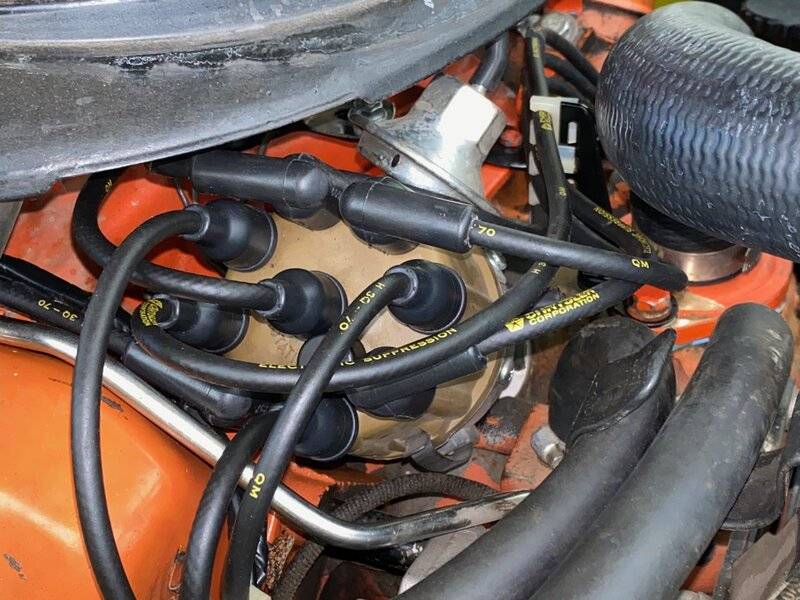

I’ve already replaced all spark plugs and plug wires. Made sure all connections on both ends of plug wires are solid. Replaced coil wire too.

1971- I see a electronic ign. So that's been modified. I'm not sure if the alt is putting out any current - in the day with only ignition needed, it can run off a fresh battery for a while.
You need a voltmeter to measure voltage at the battery. Do a full-field test for the alternator with a voltmeter at the battery. Disconnect the green wire at the alt field terminal. Jumper the field terminal to ground. The alt will go to full output. Do not maintain this for long. The 72 FSM has a detailed procedure with a test DC amp meter and voltmeter.
Aren’t Phord regulators designed to work like old mech Mopar regulators being for single field circuit? While you have a dual field alt?

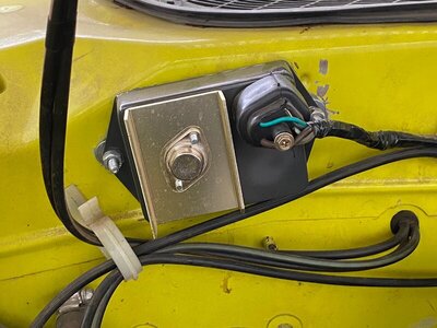

FORD voltage regulator has been removed and replaced with a Chrysler regulator that was included with the car parts. Whether the Chrysler regulator is good, I don't know. I do know it looks a hell of a lot better than the FORD regulator, which looked like it came out of a junk yard.
The other three harness connectors look good at the bulkhead, no signs of overheating or melting on any of them. Will post photos later, more to come.
I'll need this guy's help on this problem, I'm sure..
The Ford alternator regulator (voltage regulator) has totally different connections. I = Indicator lamp, A+ = alternator output, S = stator, F = field connection. The unit has an internal field relay that is energized as soon as the ignition is on. When it closes, it turns OFF the Gen or Alt indicator lamp, which provides the initial field voltage to start. It has NO PLACE on a Mopar vehicle. The Mopar alternator uses different connections than a Ford alternator. Whoever ever installed it did you a terrific dis-service...its no wonder why your system does not function.

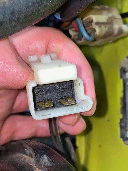

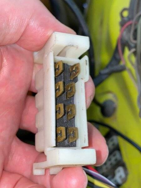

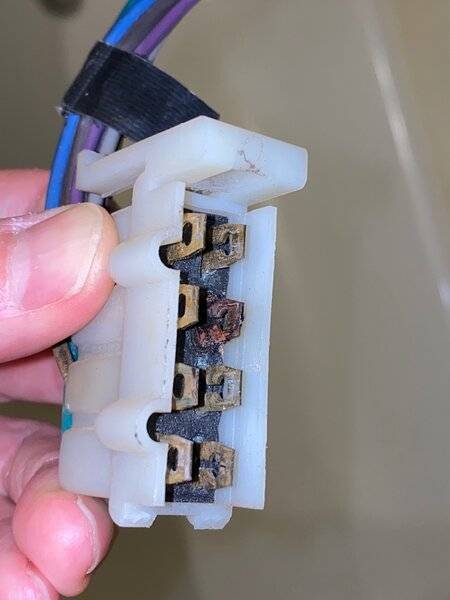

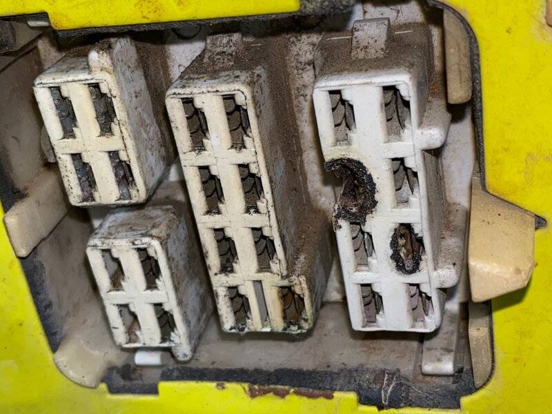

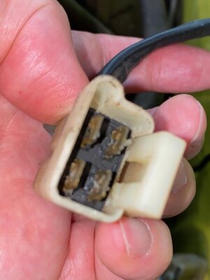

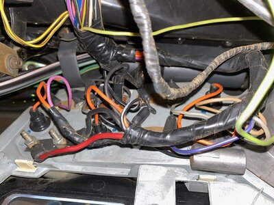

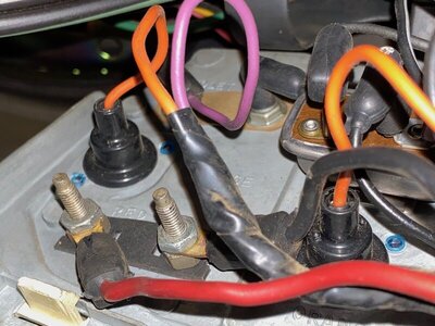

Here are photos of the Bulkhead disconnect and the four harnesses that plug into it. You can clearly see the overheating and melting damage at two of the connectors where the engine harness connects at the bulkhead.
The most damaged connector is #18 R6-12BK Altermator (BATT). It looks like burnt toast. And burnt toast gets Bud Light!! Anyone remember that dumb commercial?
The other burnt connector is #23 J2-16DBL Ignition Run.
So it looks like I will need to replace the entire Bulkhead disconnect thing. The rest of the connections on it are dirty, but I don't see signs of burning. It appears it has been in the car a long time. I don't know if that thing is all one piece, or comes apart in modules?
#18 on the engine harness connector looks like it was cremated. #23 has got some charring too. The other three wire harness connector ends look ok to me..
The big question now is .... what caused the meltdowns? I haven't had a chance to look under the dash yet, where the dreaded ammeter gauge is located.. I'm pretty sure the FORD regulator alone didn't cause this, as according to the previous owner, the car had charging problems long before the idiot mechanic put that regulator on the car. That was why he took it to said mechanic, TO FIX THE CHARGING SYSTEM!!

Fried connections don't always mean there was a cause other than the connection itself, over time they get dirty and loose, loose means heat, heat = toast. You see this all of the time, a lot of mechanics are only mechanics and don't take the time to study the service manuals or even buy a meter yet think they can throw **** at it until it works. As mentioned, replace those connectors.
Those bulk-head Packard connectors in the charging circuit are the weakest link in that original charging system design. By far the most common charging system failure point and has been since these cars were new. If you want a permanent fix for an otherwise stock charging system, by-pass those two connectors altogether. No point in replacing them with the same Packard connectors, they will fail again.
If you’ve been following some of the recent threads about the infamous “ticking time bomb” ammeters, more info on the use of Packard connectors in the charging system is detailed in most all of those threads as well.
Aaand as mentioned on EVERY SINGLE THREAD about this, you can see the heat damaged the BLACK WIRE ( ALTERNATOR ) but red is not THAT bad ( yet ).

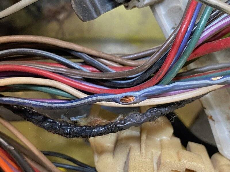

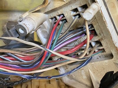

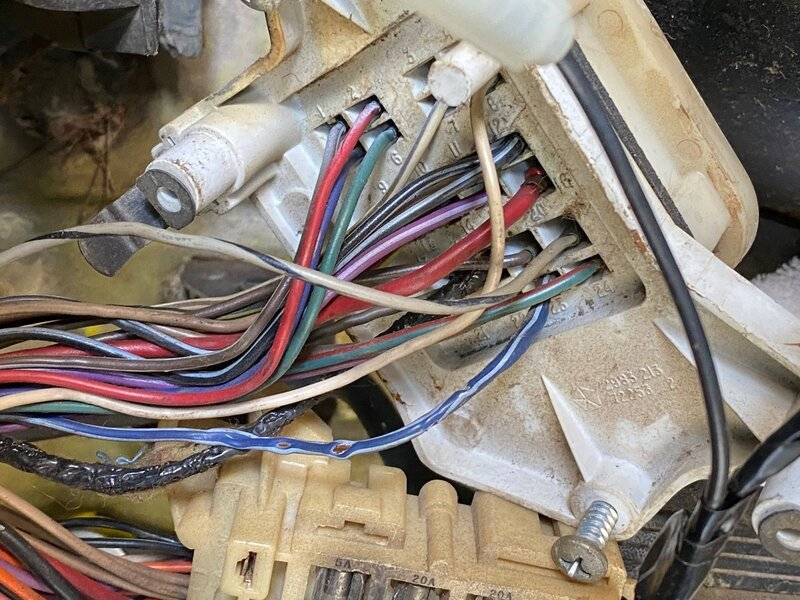

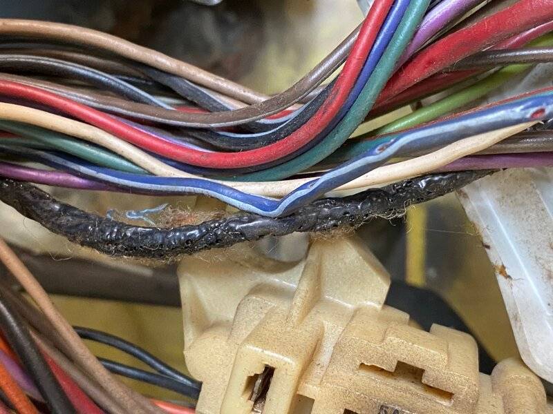

Got under the dash this weekend, and removed the bulkhead disconnect piece from the firewall. Inspection report follows..

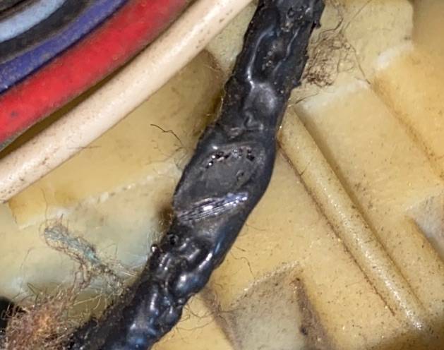

The Alternator BATT black wire was fused together with the Ignition Run blue w/white stripe wire at one particular point, just a bit inside the car past the disconnect piece. I had to pull the two wires apart, they were stuck together quite solidly! At the point of fusion, the Ignition Run wire insulation was GONE! So the bare wire was fused to the Alternator BATT wire. The black BATT wire looks to be in sorry shape (I'm not yet sure if that is all from overheating and melting, or if there is some funky tape wrapping on it, or a combination of both). It looks terrible, bad, bad, bad..
I've posted some photos, with a close up of the black BATT wire showing the fusion point in the center of the image. At this point there may have even been an electrical short.. Several spots on the Ignition Run wire have chunks of insulation missing exposing bare wire. I think these two wire fusion and the fried bulkhead connectors for both of them, are the "smoking gun" of why this Charger has been Chargeless. After seeing this, I am surprised the engine ran at all.. Or that my dash didn't go up in flames.. What do you think would happen if these two wires really shorted across each other?
Now I need to decide how I'm going to fix this mess.. Next post will be the dreaded Ammeter report..

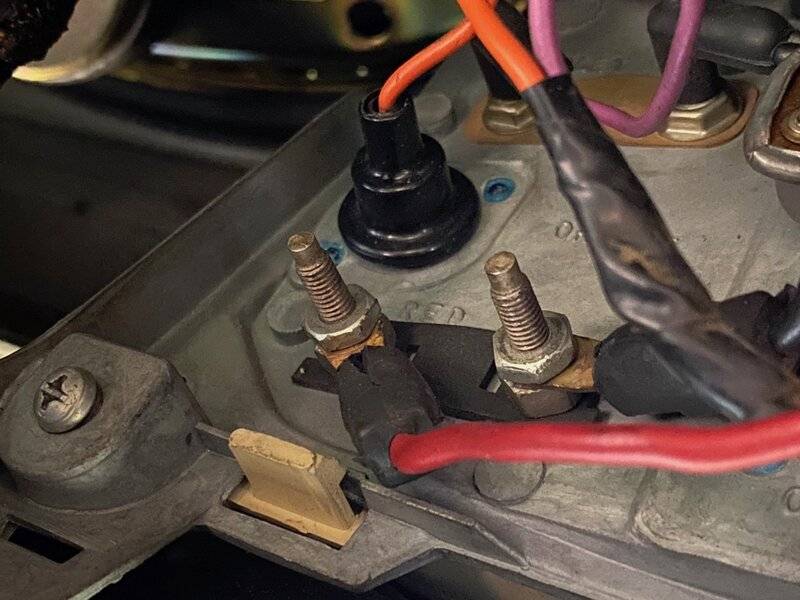

In contrast to the two wires above, the Ammeter gauge looks healthy to me.. I see no evidence of overheating at either of its terminals. No evidence of melted wire insulation near either terminal. Wires looks good near both terminals. I checked the connections and they are TIGHT. Tried to wiggle the the terminal studs and they feel SOLID. I'm not going to attempt to pull the gauge out, because it's too damn hot to disassemble the instrument cluster at this time.
I listened very closely, and didn't hear any "ticking" noise coming from the Ammeter.. I really don't think the Ammeter had anything to do with the wire damage near and at the bulkhead. The Ammeter gauge appears to be innocent of wrong doing here.. Not seeing evidence to impose a guilty verdict on the little Ammeter gauge.

IN MY OWN EXPERIENCE, I got blue wire melted when the alternator Brush isolator got cracked and grounded. It melted the wire insulation up to the cluster ( it was standard cluster back in the days and the PCB gets a source from the run circuit ). It could happen something similar since we are talking about the charging issue.
The black wire... that runs up to the ammeter but goes to a main splice first down the harness tape. That could be some overload issue made along the years because a short will make the fuse link to blown on starter relay. Or simply the resistance at bulkhead terminals due the lack of contact ( for whatever reason) able to hold some amperes rate, then the heat began there and got transmitted to the rest of wire.
Everything is fixable easy and cheap AND as we have being mentioning all along this threads ( and years ) this is a proove the bulkhead, wiring and ammeter issues are NOT NECESARILY related to each other! Everything depends on the actual cause for it. A damaged/shorted ammeter sure will melt the wiring, BUT starting at ammeter, not at bulkhead! But also will blown the fuse link. The heat due the resistance won't blow the fuse link, just a short to ground.
