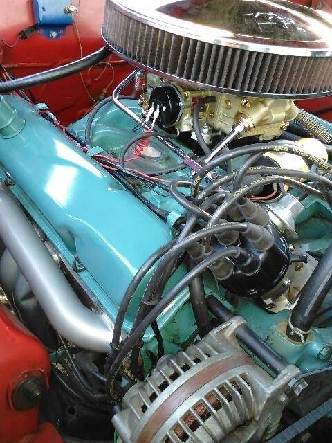

The engine came with this supposedly rebuilt Edelbrock 1407 (750 cfm) and the first thing I did with it was open it up and check to see that it had (at the least) was the jetting/rods/accelerator pump they come with from the factory.
It didn't - in fact, all three of those were dead wrong, so I replaced all back to factory issue with new parts, then made sure all passages and such were open.
Needles and seats are pretty and new (Well, they were when I had it open anyways).
The car has run much better since I did that, although I still have some tuning to do.
Sure wish I had on O2 sensor setup to read A/F...
The plugs I pulled recently looked "just right" with their light brown deposits, so it's in the neighborhood at least. No, I haven't done the "beat on it, then immediately shut it down" method yet, since the whole she-bang doesn't even have 300 miles on it yet.
As far as the float levels go, I set those using the drill bit method as instructed in the Edelbrock guide, so I think they're fairly close.
I'm not partial to these carbs at all really, but I'm starting to learn about them.
I'd just as soon have the usual Holley 3310 family carb on there, but my last experience with one of those wasn't real good either.
