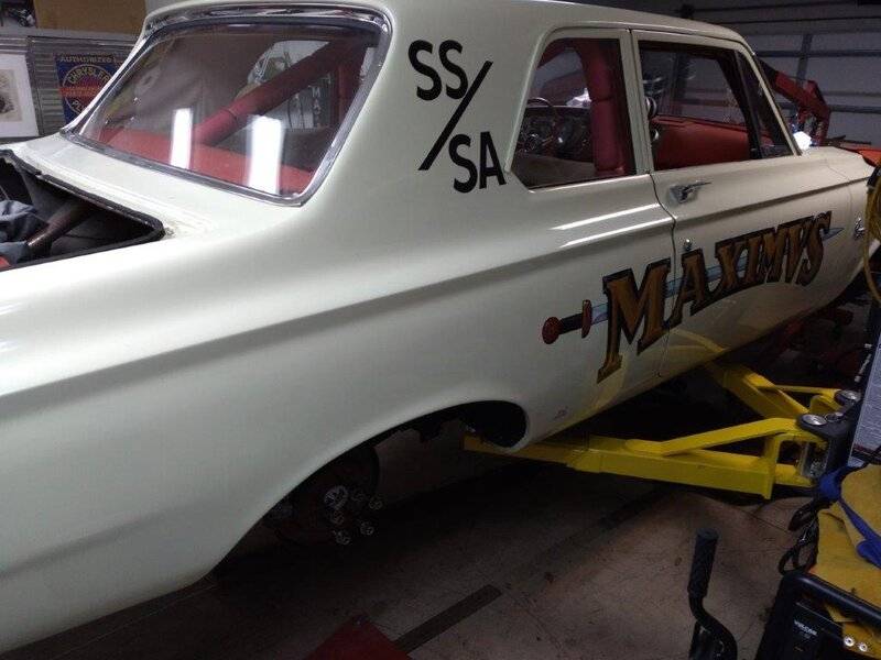

This is too much fun. 15 years past. It's interesting to see how the original build has aged... and it's not pretty. Front end parts aging and will need to be replaced, paint and graphics aging but will be retained as it is what it is, brake system components will need replacement due to age. It goes on and on but is nothing more than what I was expecting. The man I sold the car to did a great job in preserving the car while racing it. Basically I will be returning the car to a street/race ready state. Hope to have the engine and trans pulled this weekend for inspection.

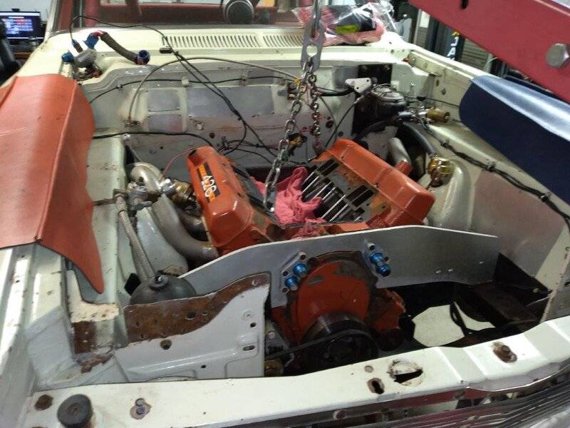

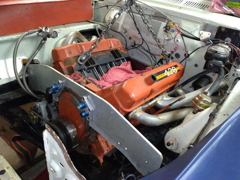

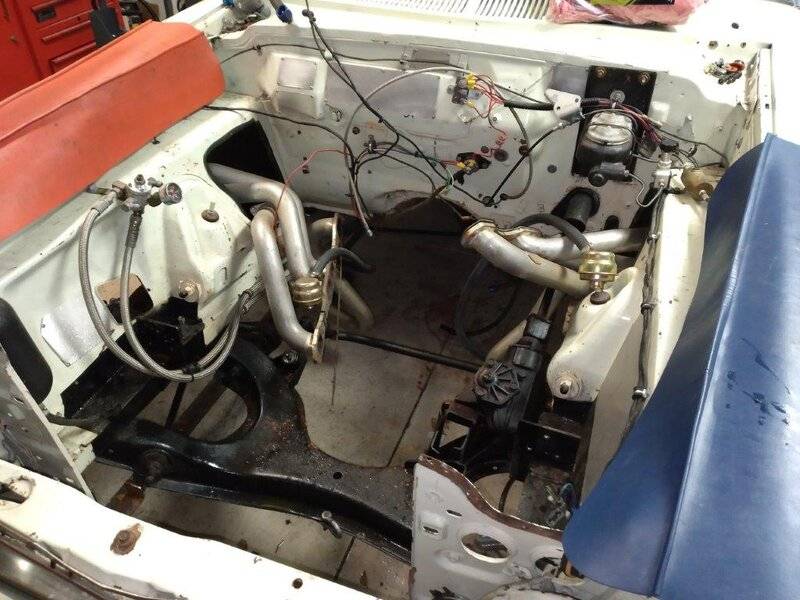

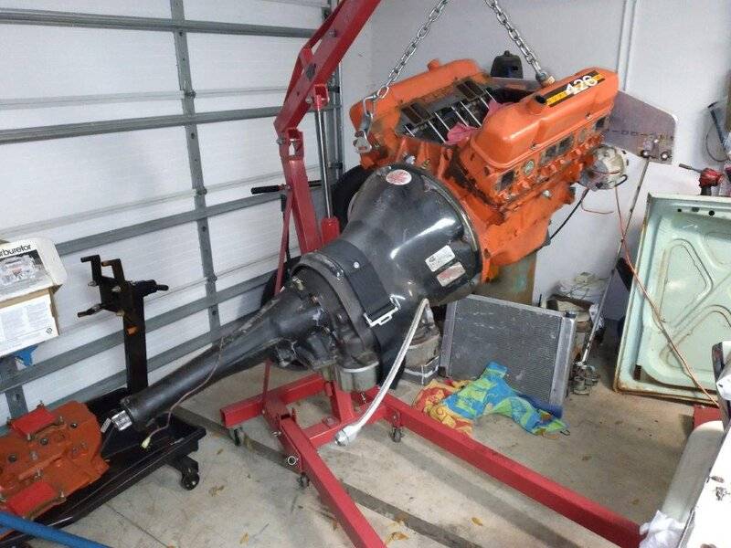

Drivetrain out, pics
Chuck

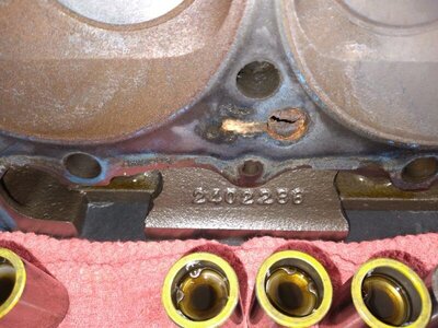

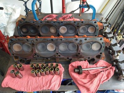

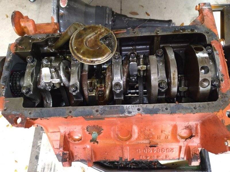

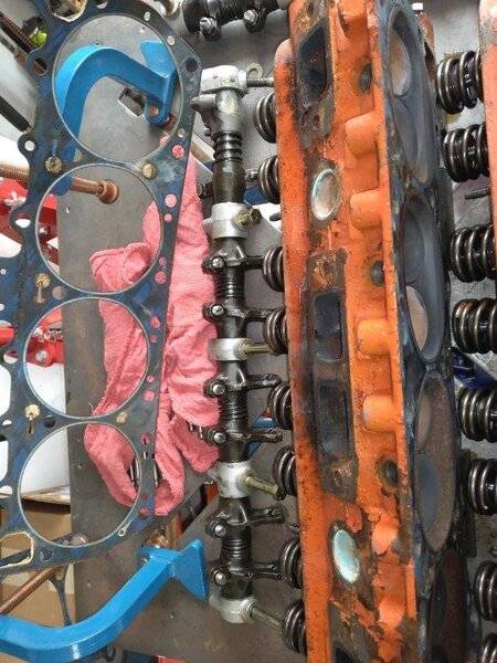

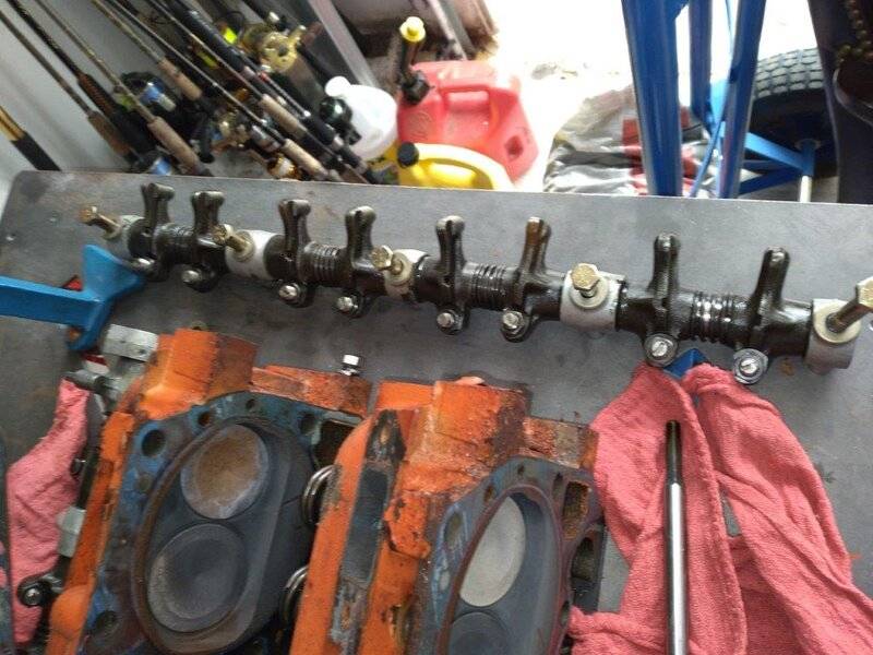

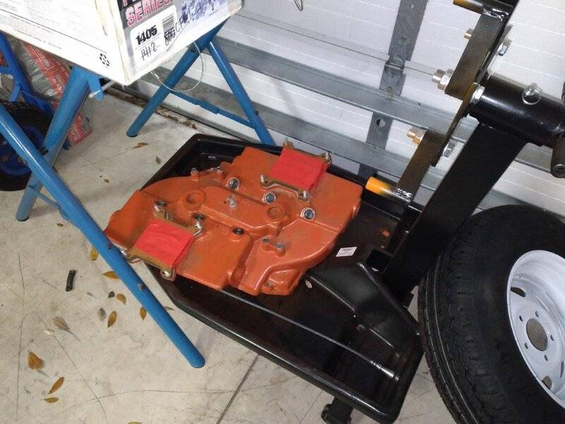

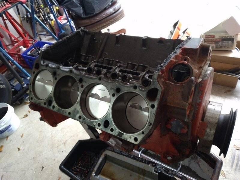

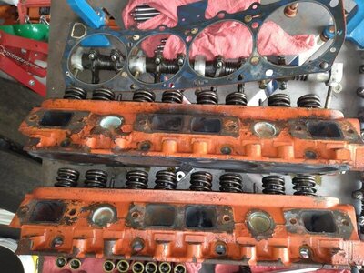

Engine looks good, pics. These max wedge head ports are huge. Minimal carbon on piston tops, wiped right off. Those are Isky rockers arms and stands - excellent shape, I'll probably re-use them.
Chuck
20220123_125619.jpg 20220123_125626.jpg 20220123_125635.jpg 20220123_125644.jpg 20220123_125652.jpg 20220123_125714.jpg 20220123_125724.jpg 20220123_125818.jpg 20220123_125824.jpg 20220123_125829.jpg

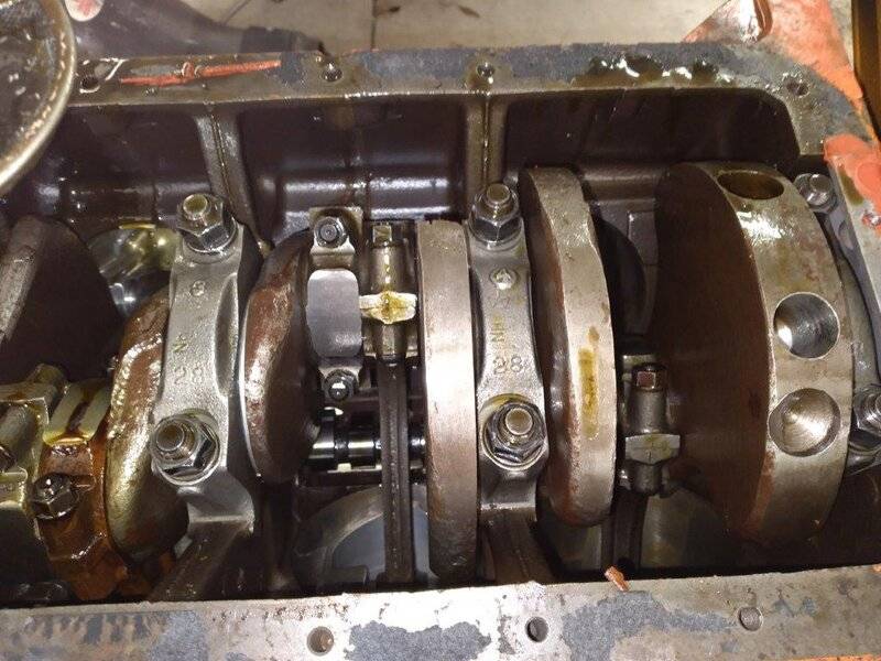

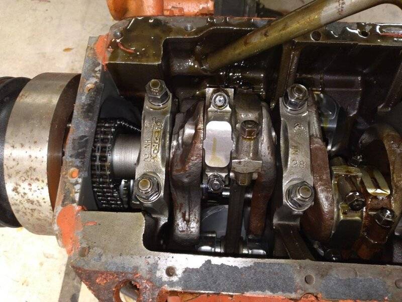

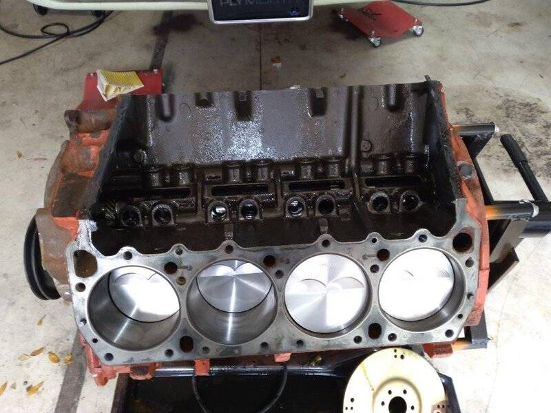

Block is 0.060" over, so no more boring on this one. I'm checking rod and main bearings and if they look good, I'm buttoning it up with the new Isky solid roller and using it while I build a new shortblock with some more cubes. It looks great so far, the guy that put this motor together did a quality job. The MW heads are going out for a valve job and valve stem seal replacement - they look good too but I'd be an idiot to have it this far apart and not do a valve job. I'm probably not using the Isky ductile adjustable rocker system (they look new, hard decision here) and going with a T&D setup to handle the roller valvetrain stresses.
Chuck

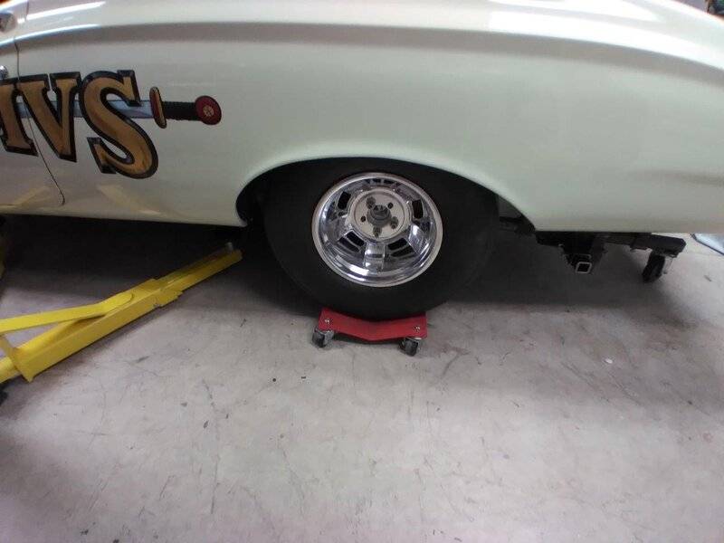

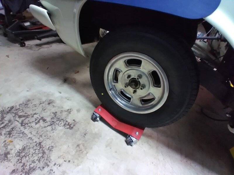

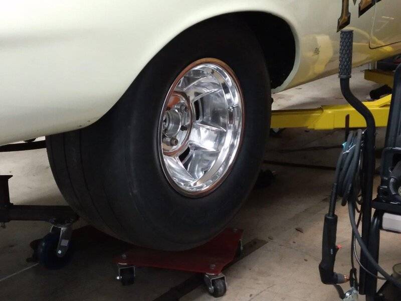

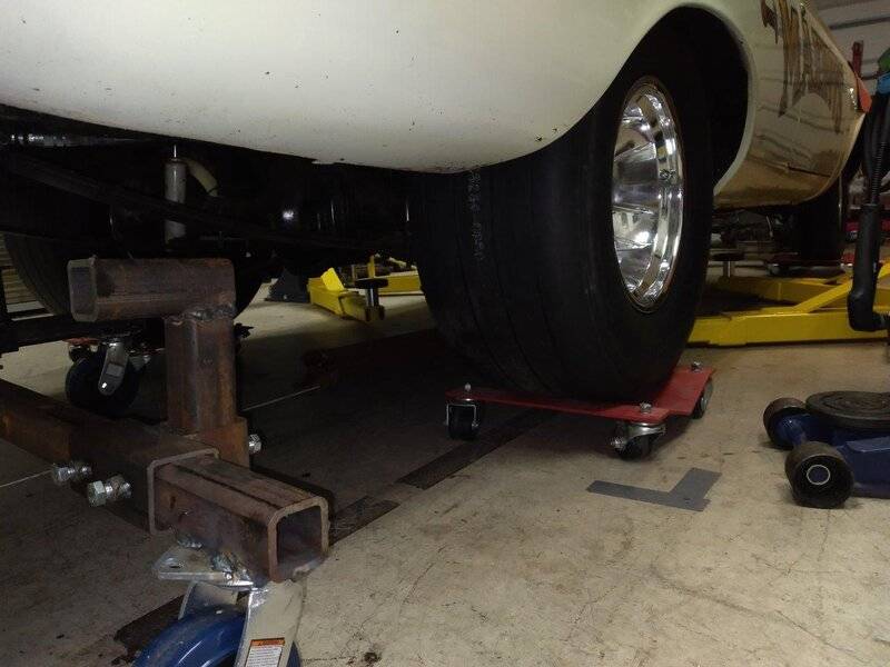

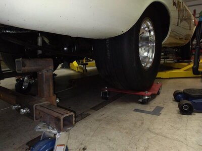

Got the rear Halibrand's mounted today and test fitted on the car - fit great. For future reference the wheels are front 15x6 with a 3.75" backspace and 215/70R15 firestones. The rears are 15x10" with a 4.25" backspace mounted on M/T 3558's (P295/65-15 ET Street radials DOT). Here's some pics, old school. Just in case anybody doesn't know Holley is reproducing these in aluminum.
Chuck (snook)

  3. New Halibrand 15x10's and M/T street ET tires (P295/65R15) mounted and stuck on the car.

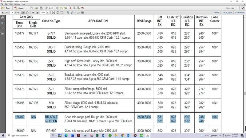

More updates; got the Isky solid roller and kit ordered.
Went with:
PART #: 165050 - 505T (RR505-T, SOLID ROLLER CAM & KIT FOR CHRYSLER 440. Cam & Kit includes: Cam, Pushrods, Springs, Retainers, Shims & Thrust bumper. Added the Optional Kit Parts - VL-38 - 3/8 Valve Locks and Optional Roller Lifter Upgrade to Bushing EZ-Roll (no needle bearings, it's spendy but worth it to me for the peace of mind. I had a set of needle bearing rockers let go on me one time, it wasn't pretty). I'll be using a set of original oldie ISKY ductile max wedge adjustable rockers - they are like new and Isky says they will work great with this setup.
Chuck (snook)
Cam specs (will be moving to a 1.6 rocker later):
