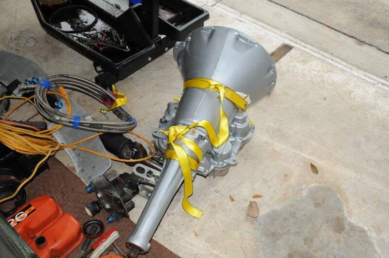

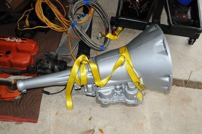

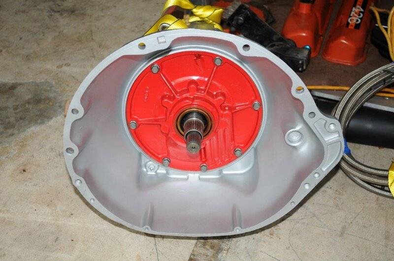

  • Got the trans back. It is now a thing of beauty, all the good stuff was still intact, A&A steel billet drum and low gear set (2.77:1), bolt-in sprag, A&A RMVB LBA valve body, etc, etc. Output shaft retainer was toast for some reason but Harold (PM me if you are looking for a great trans guy, he's in Fellsmere FL) fixed it and we're good to go. He takes pride in his work, see pics - it's pretty.

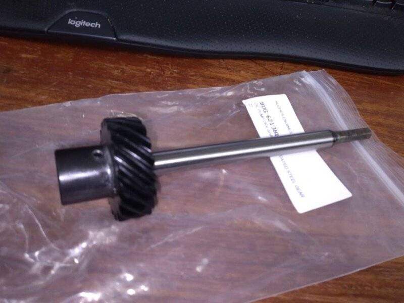

  • Sprang for a melonized oil pump drive gear over the bronze gear for my Isky solid roller since I intend on a lot of street use and I don't want to constantly check that part for excessive wear. I called Isky and they said it was OK to run that over the bronze gear drive. A pic below of the Hughes Engine PN# HUG 6213BB. I will sell the Milodon PN# 21525 (new, still in the shrink wrap pack - I'll post that in the classifieds when I get around to it)

I trusted Harold with this one year full boat only 1965 727 slip yoke trans. If you know how scarce these are, you'll understand.
