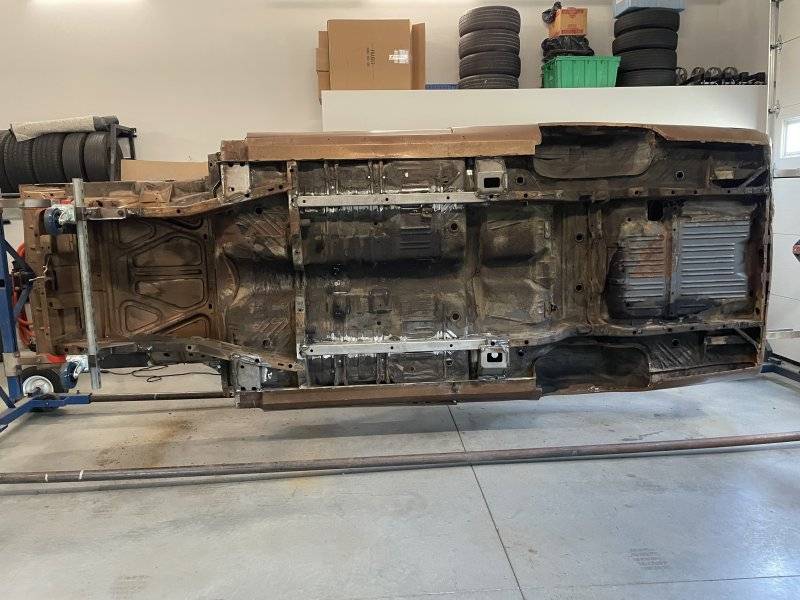

I got the engine & whole set-up from Bouchillon Performance in SC. The engine was shipped to my office where I have a forklift. We took the crate apart and loaded the engine on the pallet onto my truck and I removed it at home with the engine hoist.
I'm going to run a 8 3/4 with 3:55 gears. It's a street car and the 8 3/4 will be good enough for the driving I'll be doing.
I didn't know that there was a difference in transmissions & I just got what they ordered from me.
The frame connectors & F&R stiffeners are all welded in place, except for the left side stiffener that welds to on the left side shock tower & inner fender. That side inner fender needs to be replaced and I'll have the body man install that one when he changes that panel.

Frame connectors and boxes look great. Yeah, I was thinking 8-3/4 is plenty for me too, but if I can get a new Dana for the roughly cost of a new sure grip chunk and restoring what I have, I might as well go with the new Dana.

Next on the agenda will be cutting the tunnel for transmission clearance, dry testing the engine and transmission, figuring out the coupling from the column and the rack, test fitting the a/c unit and cleaning up the underside with a fresh coat of undercoating.

You doing all the welding yourself in your garage? If so, you are moving along real good for an old retired fart :).

I think I have a new left inner fender,if you want to get all the welding finished now,if you need it.
