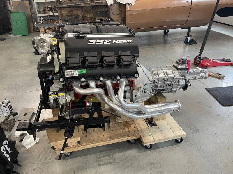

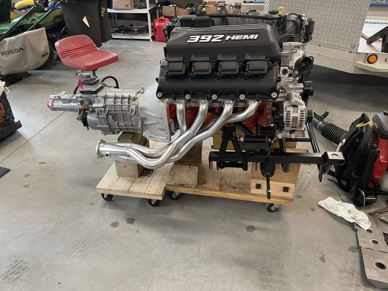

Those should wake up a few Horses. They look great. It's coming together nicely. This is going to be a great combination for you, year, color, and obviously, the drivetrain. You did good!!!
I probably missed it earlier, but what hp & torque numbers will that motor put out?
I believe around 485 hp and 475 torgue.
Not sure on torque, but I’m told 505 hp. I believe that the hp increase over the stock 485 is due to a computer tune.
The headers may add between 30-35 HP over the 6.4 manifolds. That will scram quite nicely. In streetable trim, it could be an 11 second car if you hook up.
I dyno'd my scat pack challenger, through the 8 spd trans and it made 422 rwhp. If you do the rule of thumb math, it is like 506 fwhp. Not too shabby at all.

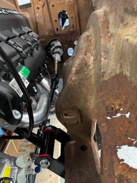

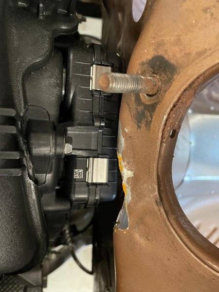

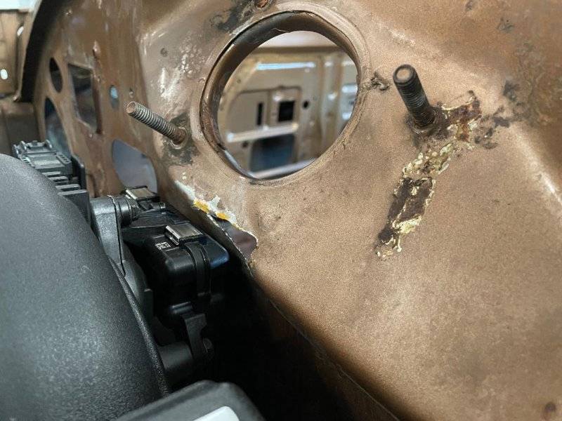

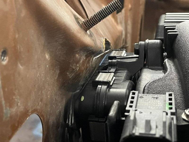

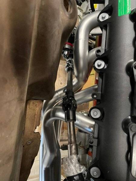

Last test fit for the drivetrain to check for the firewall clearance and steering shaft clearance.

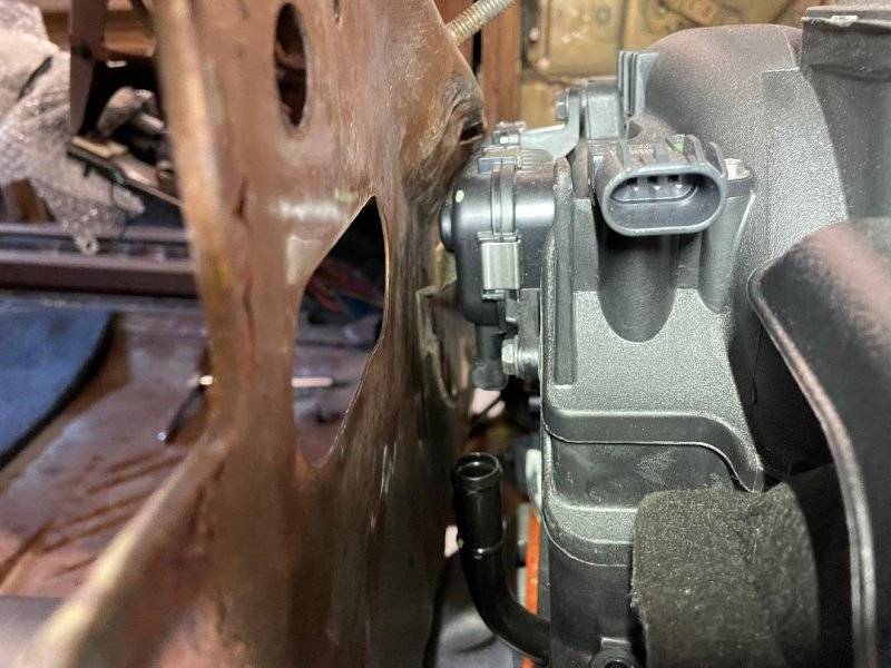

The vertical tube is for the heater hose. The 2nd one isn't in view. I'll have to connect those before setting the engine in permanently.
Plenty of clearance for the steering shaft. Utilizing the QA1 tubular K-frame along with the lack of torsion bars, steering gearbox, steering linkage and clutch linkage gives gobs of clearance underneath.
Holeee crap....Perfect example of how a picture is worth a thousand words. The clearance at the firewall to intake electronics is more crucial than I thought. I have a 2007 5.7 on an engine stand and the clearance of my intake is likely far greater since it is the basic non-active design.
The Holley swap kits mount these engines forward 1 3/4" probably to account for the obstruction.
Great to see some progress.
Yeah, it seems to me that the engine could have been mounted an inch forward and it would have been perfect, but who knows what it would do for interference between the header and the steering shaft.
Oh, I'm sure it all is a juggling act to fit it all. These are taller and maybe longer than our classic V8s given the front end accessories.

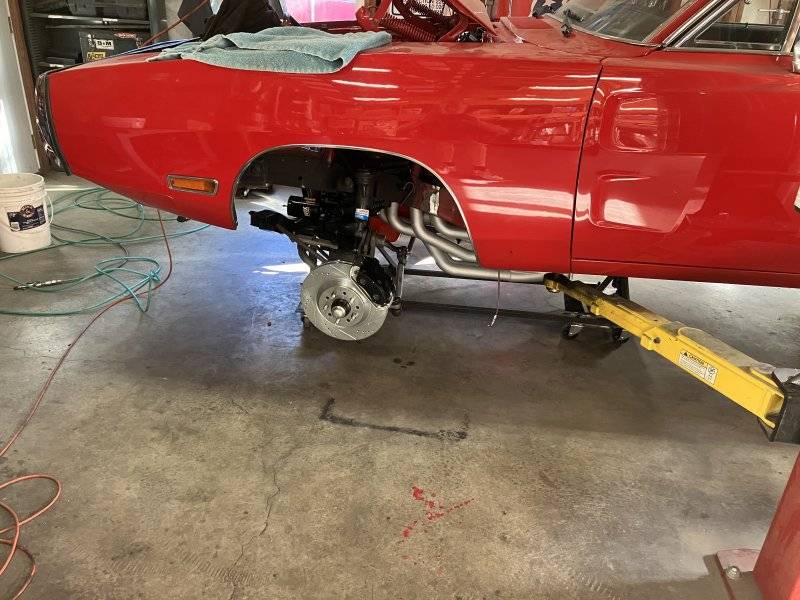

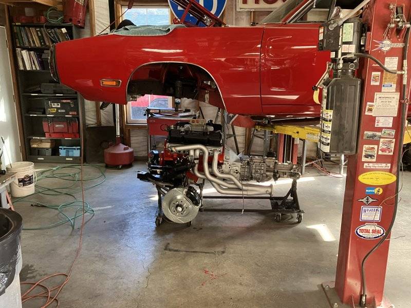

Easy-peazy to body drop onto the engine/K-frame. I’ve done several Hemi and 440 body drops and both are tight fits and require a helper. I’ve done this three times by myself like nothing.

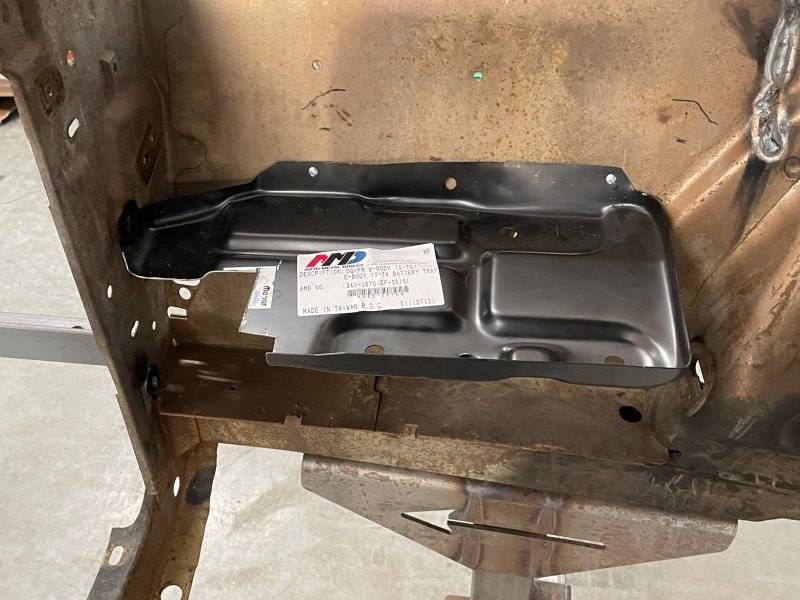

I can’t mount the battery on the left, so it’s going on the right side. That’s going to be a project for another day.
