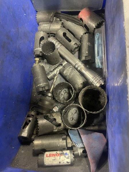

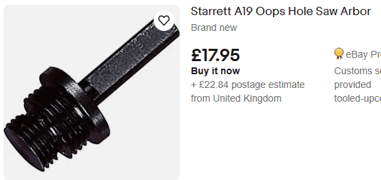

There are two different sizes - the larger has a centre hole for a pilot drill when using bigger hole saws.If you have a set of holesaws, and already have holes the wrong size, you can always use an 'Oops Arbor' - this allows two holesaws to be used at once - one is the guide for the original hole size, and the larger makes the hole size you need.
I use these a lot for ceiling lights, and some electrical panel work.

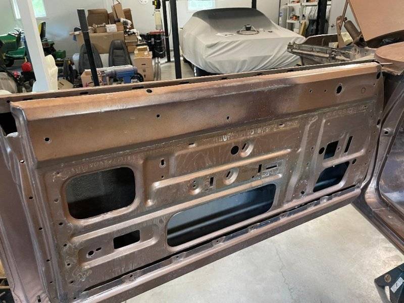

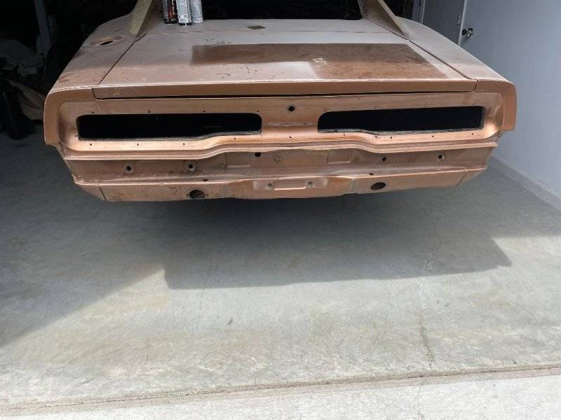

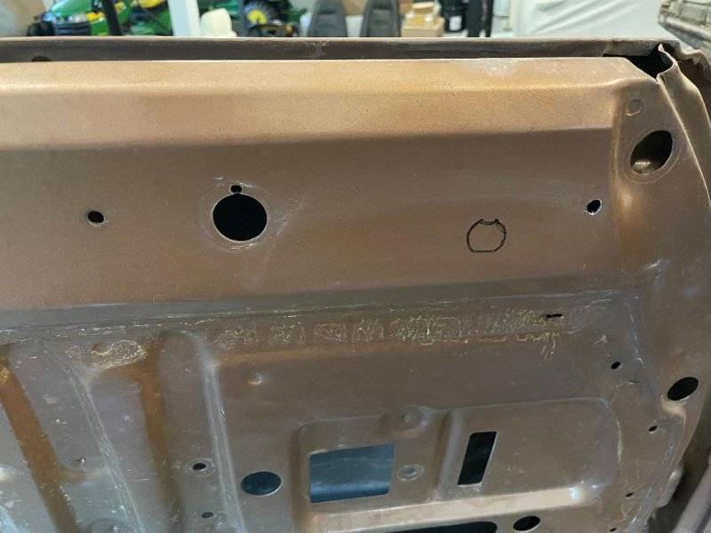

Did you have a template to drill the tail panel holes?Drilled a bunch of holes today in the tail panel & also to attach the upper door pads on the inside of the two door shells.
Apparently the mirror control is in a different location whether the car came with or without upper door pads. I'll drill out the new location tomorrow.
