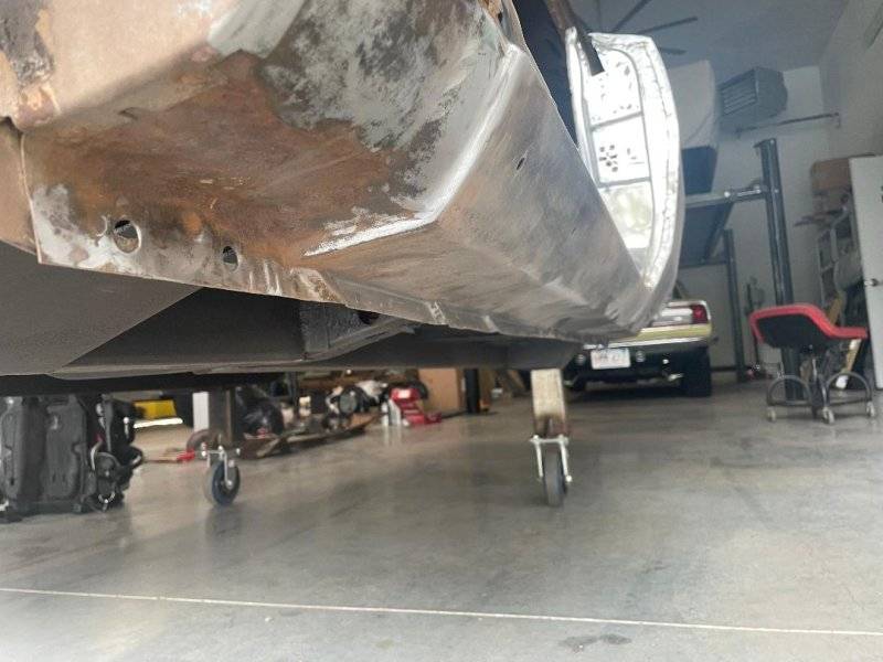

The only rust surprises were under the vinyl roof and passenger side footwell.
The Dutchman panel needs to be replaced which leaked into the trunk floor and you can guess what it did to the center of that.
It is on the whole a very nice clean shell. It must be nice to start with something so clean. :thumbsup:

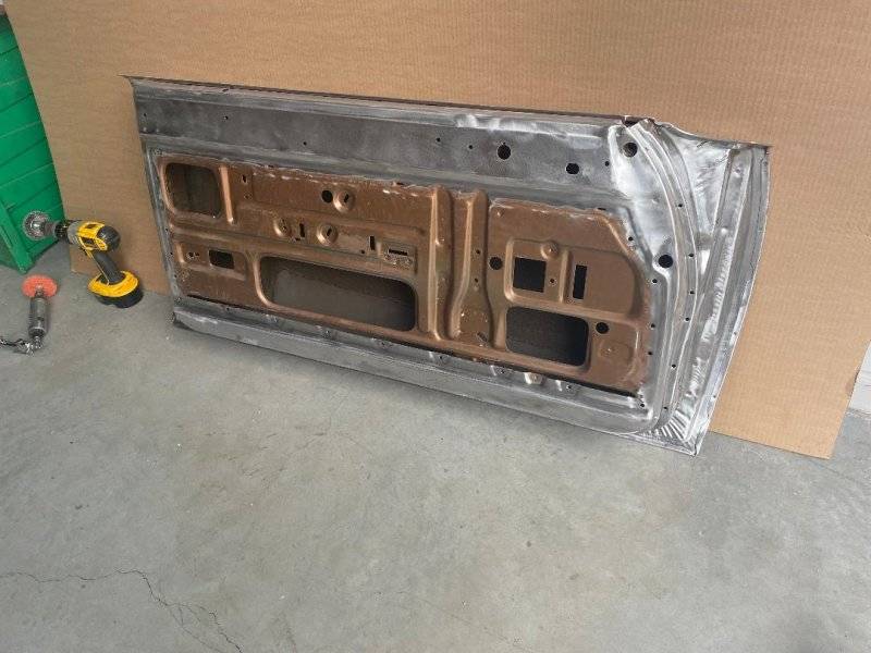

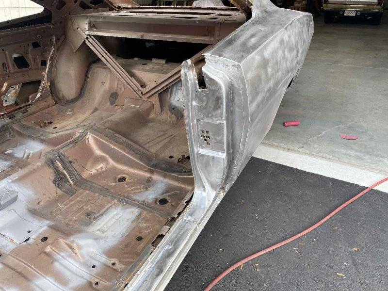

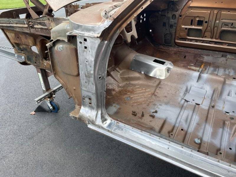

Making progress .........
Way to go, Marcus!
Did I read that you're going with a TKO or TKX Tremec 5 speed?

That car has good bones! The QA1 stuff is cool too, all of the QA1 bits I put on the GTX last winter seemed to be well made…

Being original paint, there were no surprises visible ..... well, until I took out the trunk mat, carpeting, rear window and vinyl roof.
Is that car getting a Tremec transmission?
TKX 5 speed.

I ask because I'm helping with a Tremec TKX swap into a 69 Coronet and wondered if the shifter hump is much different than my car needed with the TKO. SST claims the TKX fits without much trimming.

If you scroll back a few pages, you can see how much trimming I did. Pete told me that if you cut the floor to install a 4-speed hump, hardly any trimming is involved.
