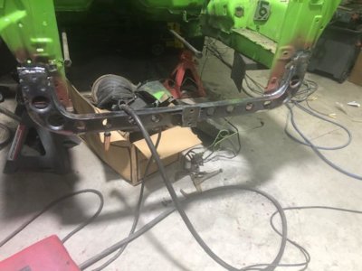

        As have already been posted, there's are lots of ways to get your car painted. If you are actually looking for paint AND bodywork, then the costs go up. What I did was do all of the bodywork myself, and bought the paint. Paint was approx. $500 for sherman williams mid grade paint. I had it painted at a Dodge dealership for $1800. If you don't know how to or like bodywork, I'd suggest learning how to. It's not hard and if you mess it up, start over and do it again. As far as finding a painter at a good price, you just need to start knocking on doors. There's lots of bodyshops and dealerships around here so it was easy to find a good deal. If you don't have alot of places to check on, well, you might pay more. But it any event, more you do yourself, the more money you will save. Good luck !
        • Agree Agree x 1

          Thanks Moe-par for the Farwest info. I'm in Yakima and need to change colors on my build. My wife hates the green. I'm about ready to put my ride on the rotisserie and install the mini-tubs and relocate the rear spring mounts. Then I'm media blasting it. I will epoxy primer it and do a lot of pre-fitting before painting it. I found a guy that loves painting old Mopars. He wouldn't quote me a price as he said it depended on how much prep work was needed when he got it. I have a handyman that works for me that used to work in a body shop and we will get a lot of the block sanding ready and have the engine bay, inside and trunk pre-painted before he gets ahold of it. I'm going back to the original copper color only a nice brilliant metallic copper and a pearl white vinyl top.
          Crider, that's a beautiful car, reminds me of my old 68 Roadrunner. She was F.A.S.T. I loved that car. On a good day, she ran 12.48 in street trim with a kid seat in the back. Uncork the hookers and put on some sticky tires and it was good for low 11's.

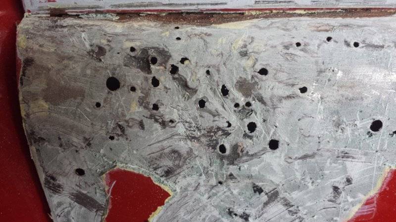

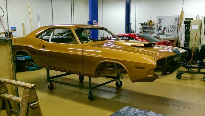

            I have painted numerous cars in my garage.
            The biggest factor is the prep work and no, I will not paint over someone else's prep work.
            I have had guys come to me with cars they say are "ready to spray" only to find substandard work and materials. The paint job will carry my name on it so even if the paint fails because of something the other guy did - when people ask "who did the paint?" it will be my name that is given.
            This truck came to me after another shop had "painted it." They quickly painted everything in pieces and charged the guy $6000.
            When I got it there were bent parts, broken off screws, bolts, worn out holes and cracks in the paint. One crack in the front fender was deep so I sanded down through 1/2" of filler to find a substandard patch job that still had rusted metal in it.
            The color for this truck was $800 a gallon and that did not include primers, clear or reducer.

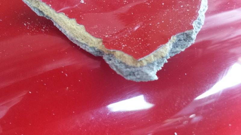

            The next truck shown was painted by a "custom shop" in California just two years prior to coming to me.
            Notice the cracks in the paint:
            I ended up stripping this entire truck.
            The body and prep work was horrendous. Here is a chip of the paint removed. Notice how thick the filler is under it.
            This was mess was under the paint on the bed side.

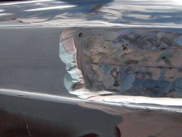

                On my '68 GTX project I did my own media blasting with a small pressure blaster.
                The above took about 1 hour to do but labor is free.
