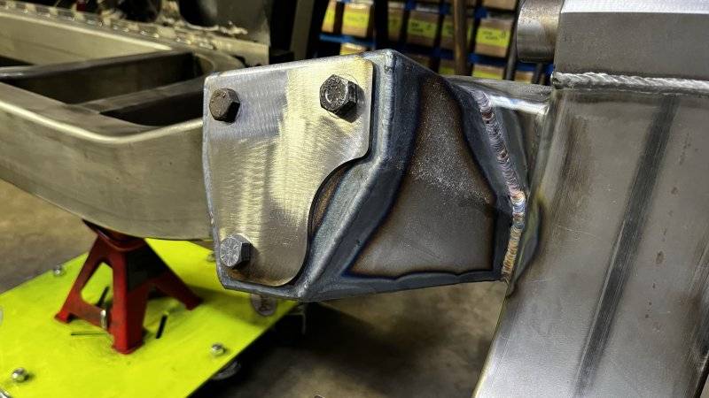

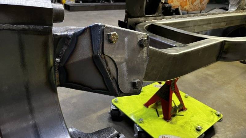

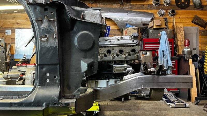

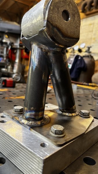

New engine mounts - lighter, spread the load more broadly across the frame, and have a lower radar signature.
Frame side is all mild steel. The plates where the tubes will land are 4130.

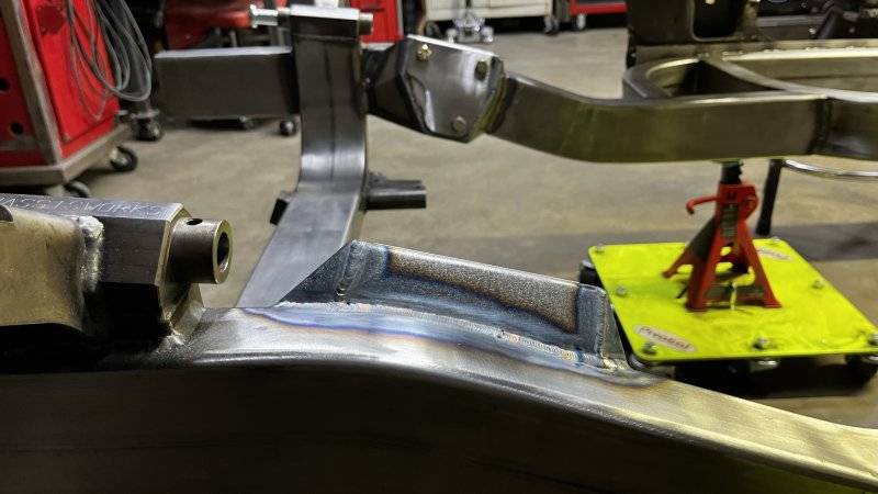

Sides are blended to look like they were made in a press brake.
All burned in. The open corners are tricky when managing gas flow, but doable.
Next is to add some strategic bracing to avoid the frame spreading under load.

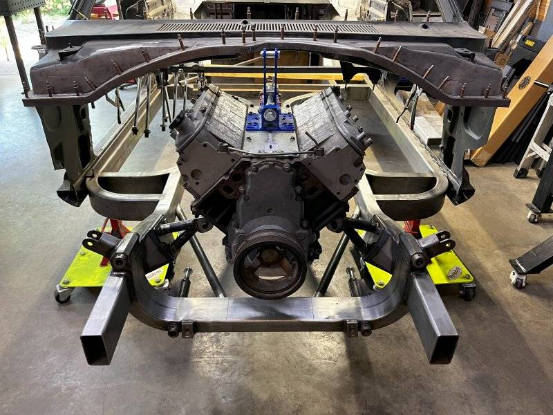

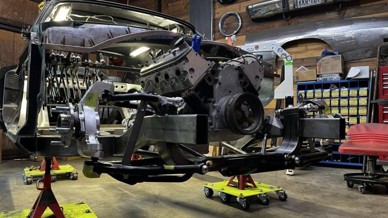

Spring and Summer offroading is done, and I've been sweating it out in the shop on the car.

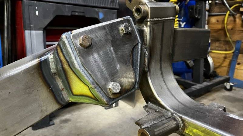

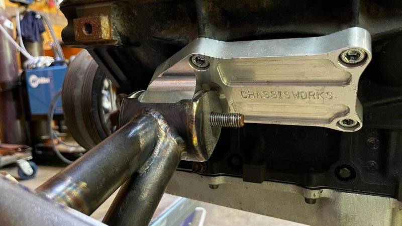

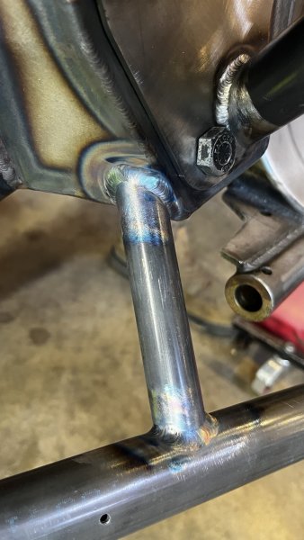

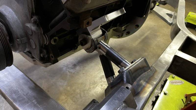

Engine is placed and mounts are done. For good time time. No more revisions. These are completely burned in.
They're light and very strong. All 4130, and the tube is 1-1/4x.065. It's such a joy to weld chromoly.
The heavily offset mounts from Chassisworks made it easy to push the engine back and maintain clearance for the exhaust primaries.

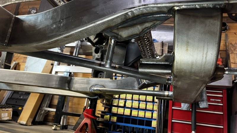

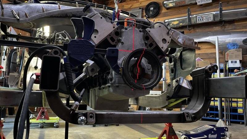

I added lower reinforcement for the suspension crossmember. It's common on all the new pony cars and even my truck has some bars that connect the torque box-ish area to the engine cradle. This was the start of my K member.
You can start to see how deeply setback the engine is. Net is about 12.5" not inclusive of the 1.5" or 2" the front suspension is pushed forward.

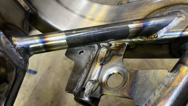

Added some 7/8x.058 from the anti-twist engine frame mounts, which is about the time when I started seeing this as a K member.
Also added these lower A arm braces to tie the lower chassis bars together.
And it's no time at all before the chassisworks suspension comes together. Final width is about 60.5", but as you'll see, the factory wide body absorbs it all with ease.

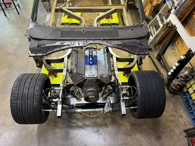

Found a set of used 305s for mockup. I'm on the hunt for rear 325s. This is the first time I put tires on it, and I just couldn't help but stare. It's been a long time.
Good birds eye view of the k member and suspension.
And the fender absolutely swallows the 305. This opening and the marker will get moved forward and up just a bit. It's been four years since I drew and built the frame, and I truly can't remember exactly how far forward this is, but it's 1.5" or 2"...probably.

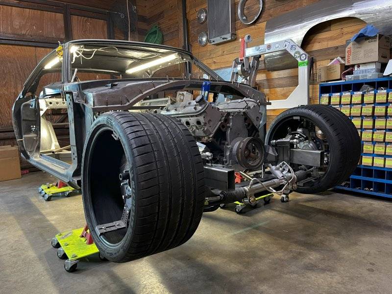

Frame extension and sway bar are in and fit snugly. Cycling the suspension, everything clears from lock to lock. I’ll pull this all back apart, brace, and burn it all in.
At full stuff, the tires and the valve covers are about level. I’m pretty excited about modifying the fenders to fit all this.

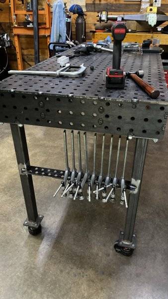

First, all clamps are out of the car. It's the little things, but it felt like a real change to not have tooling stored in the car any more.

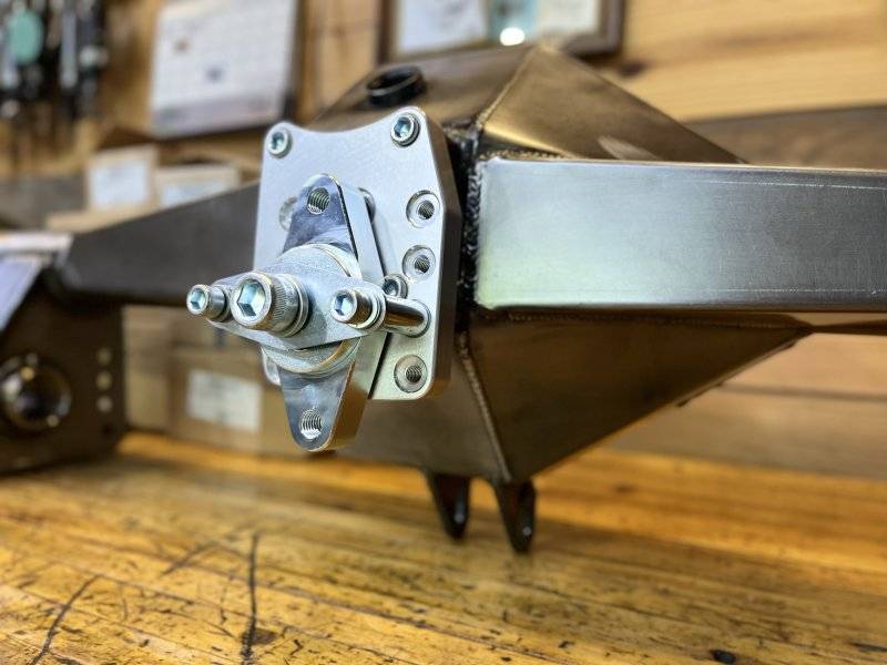

Watts link with adjustable roll center.
Strange HD center. Forged s-trac, 35 spline, 4.11.

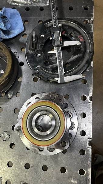

Picked up some used C6 parking brakes to see what I might adapt for a the car. The answer is, "not much." Still working on this problem, since the unit bearing is about the size of a half ton truck, so nothing off the shelf fits. Still fiddling with a custom backing plate and this corvette shoe.

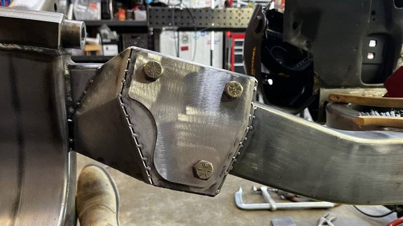

Did preassembly on a bunch of lower link and watts brackets.

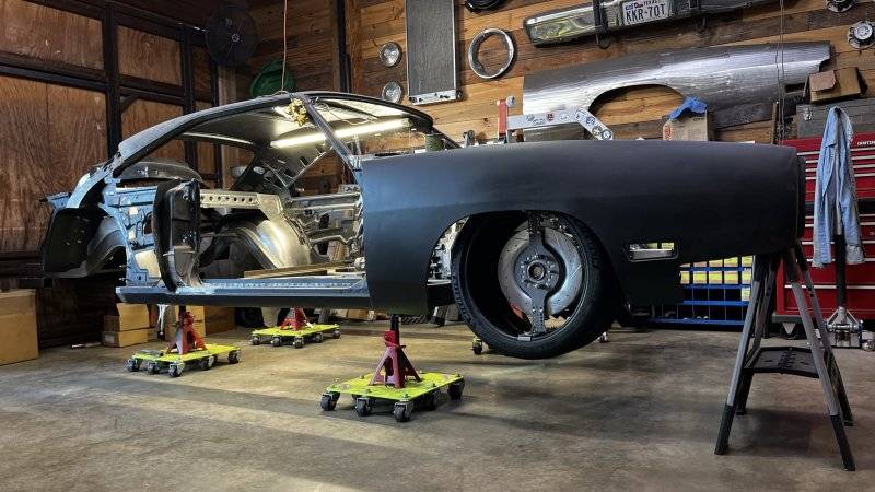

Tires are settled. Front is 305/30R19, rear is 325/30R19
Ready for fitup.
I pushed the tire forward from stock position about 3/4 so it better follows the front opening. I know factory had different wheelbase options for these b-bodies, and this was a great opportunity to get the aesthetics just right for this. It's been rattling around in my mind for months now.
The 325s push to the edge of the quarter by design, and I have some tin work ahead to make everything play nice at full bump.
That floating piece of square tube is "the ground."
