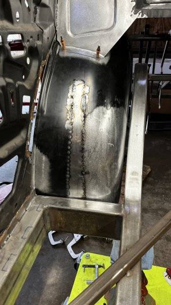

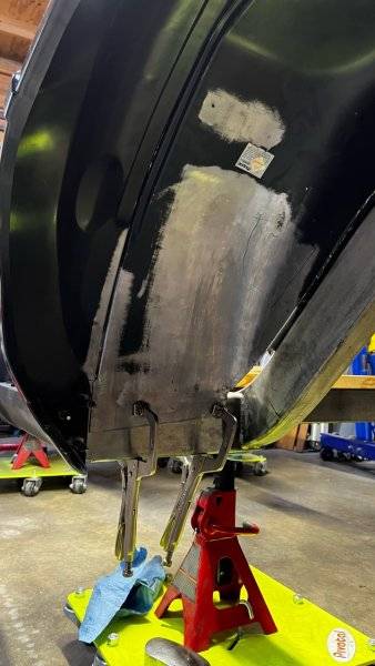

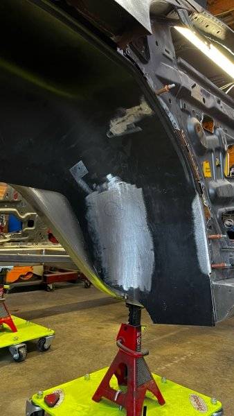

Wheelhouse extension done, with overlap from the inner to the outer. These things are time vampires.
One more piece to fill the front inner corner profile, and then I’ll start to mirror on the other side. But first, it’s time to go deer hunting.

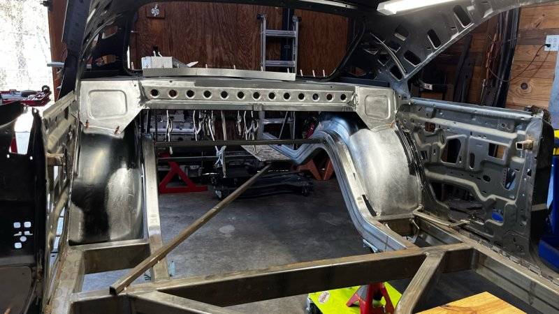

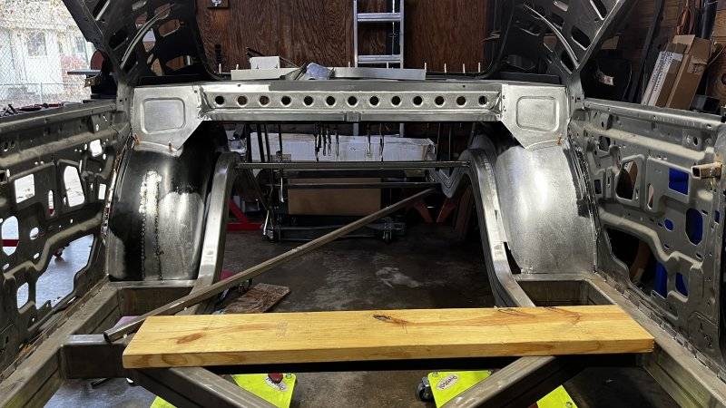

Lots to organize tomorrow, but everything to put the car on its own weight is here.

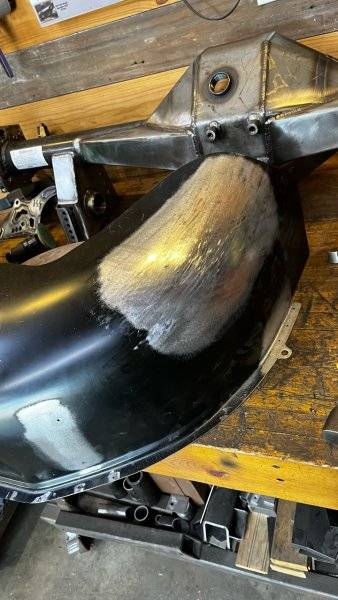

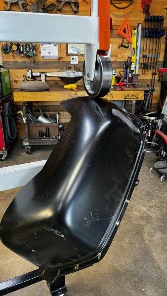

What all tools are you using to get it smoothed out after the dolly work, just an english wheel? Your work looks phenomenal!
Question don't you have a contract or work for chassis works? And if so did you design these parts for them or did you order what they have off the shelf to fab and fit?
And by the way your fab work is top notch.
English wheel, slap hammer, and a bit of the shrinking disc. Thanks man. Lots of hours, but I enjoy the work.

Thanks, I'm looking into buying some metal shaping tools since I tend to be shaping metal often but didn't know what piece to start off with? So you don't use a blanishing hammer? Watching videos it looked like it would work great for smoothing out metal in tighter areas?
Kind of depends what you want to do; a plenishing hammer is awesome for smoothing out metal, creating domes, etc. however it does have limitations. An English wheel can do the same but so much more, but both have their place. My favorite piece of metal shaping equipment is my bead roller.
Patience is the key for sure. There’s no fast way (I don’t think) to do any of this very well. It’s lots of incremental steps, none of which are too hard, but do require prolonged focus for an amateur like me to get the kind of results I want.
I listen to books or Jazz while I work. That keeps me in a zone.
David
Just getting caught up and I have to say you put a lot of professionals to shame. Impressive skillset and patience as mentioned before. This will be an amazing car when done.
I plan on buying a pneumatic planishing hammer. It will do all the same stuff as body and slap hammers, but far faster and it gives you a little leverage that comes with that “third hand.”
If you’re building one or two cars, I’d favor a planishing hammer. It’s great for small to medium sized area work, like fender flares, weld seams, and so on. I just scored the English wheel for free, and ended up getting it first. It take up a lot of floor space, and I’d sooner recommend the hammer for a space efficient tool.
Whatever you choose, just get started making stuff. Experience is a great teacher, and you don’t need more than a few YouTube videos to get going.
They’re powerful tools, no doubt. To me, it’s just a matter of which you get first. Hard to go wrong with either.

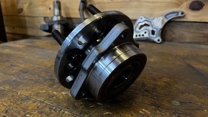

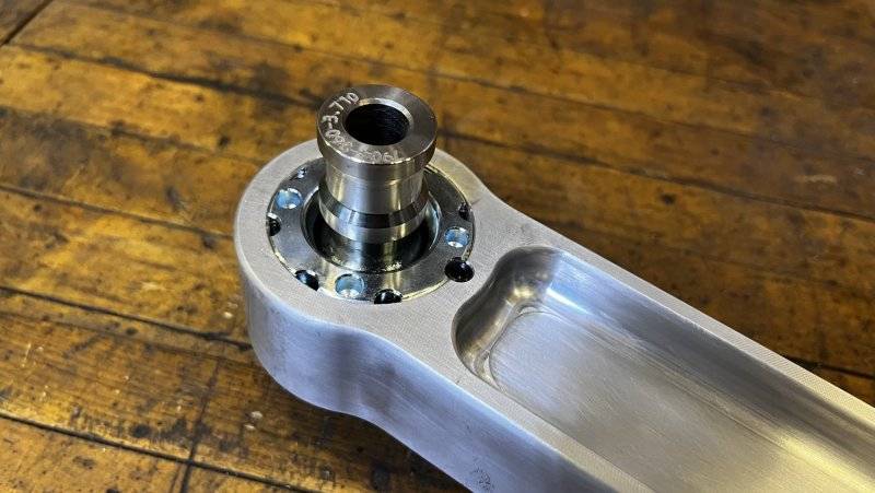

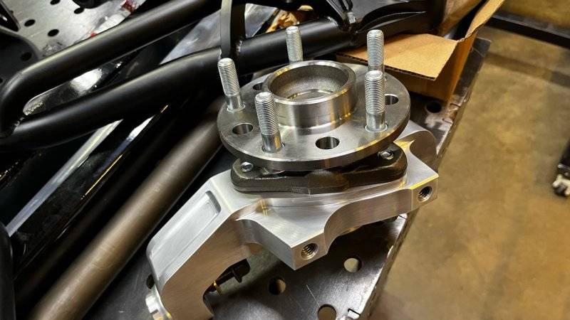

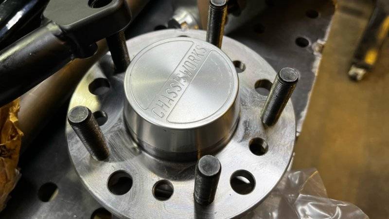

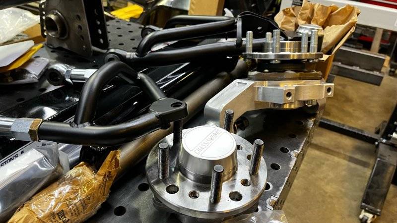

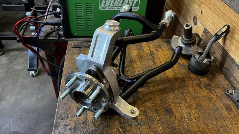

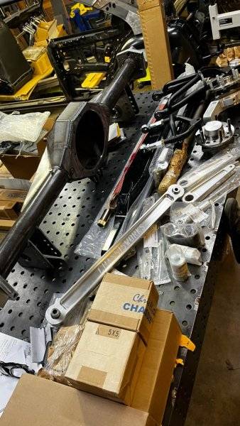

Everything is sorted, paperwork is cataloged, and parts are stowed. These are just some photos of a few of my favorite components.
Wide track arms will make for a 60" wide front end, their widest dimension available. This also confirms the notion that a charger is a factory widebody. Also, the front unit bearing is an evolved version of a C6 Z06 made to handle lots of side load from slinging heavy cars around on sticky rubber.
The rear unit bearing is the same as the front with a different flange for the floater Fab9.

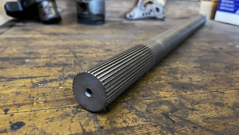

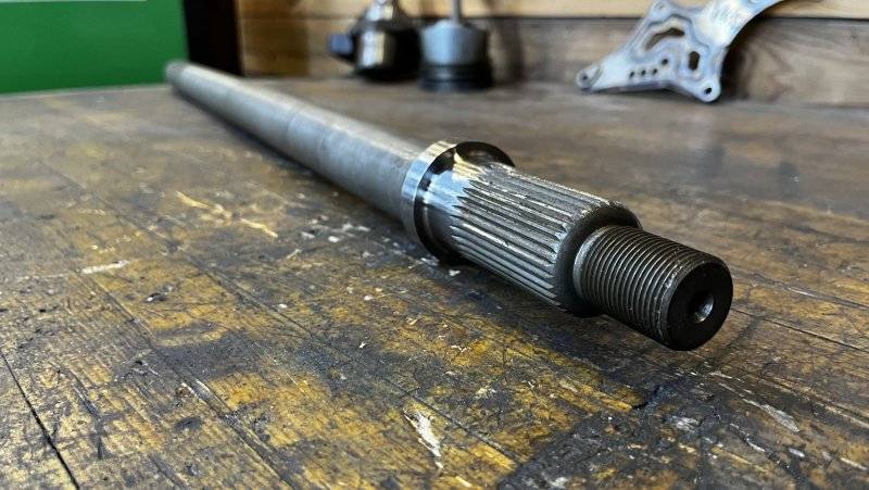

Rear 35 spline chromoly shafts.

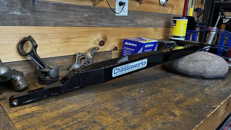

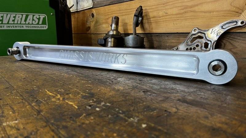

24" trailing arms. Their longest and lightest available.
48" torque arm. This is one size longer than their 39" for a Chevelle.
Also, I forgot to order the watts link, like a dummy. I'll get that incoming next week.

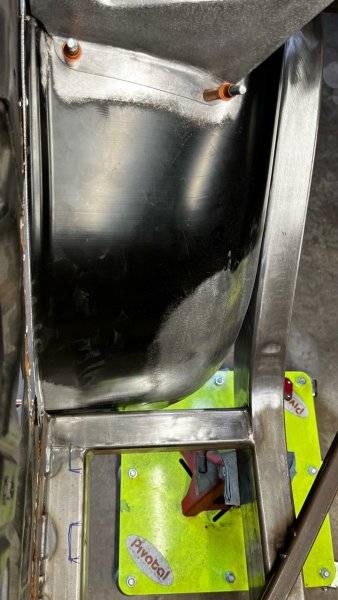

I’ll slice the front and extend the material to match the “torque box” frame section.
David

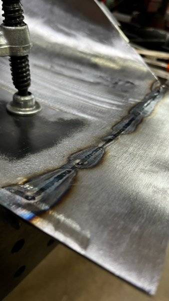

Profile adjusted.
It’s only about 3/4” wider, but I cut in this larger section to avoid blending two welds so close together.
