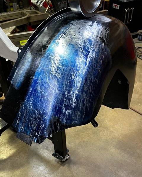

Welded, beaten, and given a first run through the wheel.

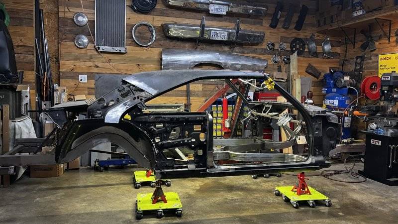

Thanks! It's so much fun to work on, and it's at a very rewarding stage where progress is easy to both see and feel.

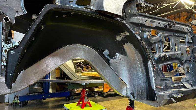

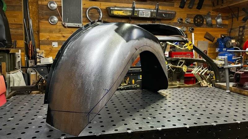

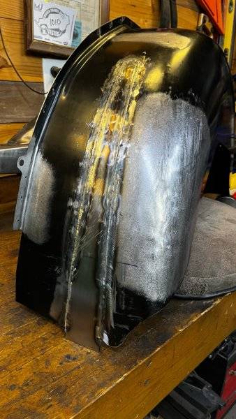

Flanged.
Lots to tidy, but pleased with how this is coming together.

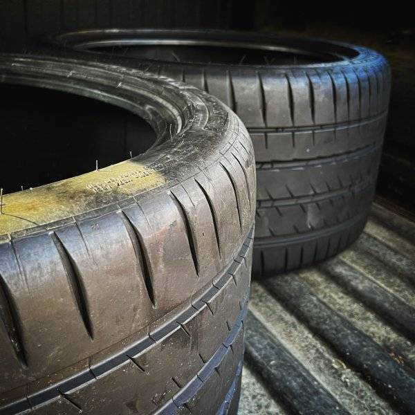

Picked up a set of lightly used 305s for mock-up on the front.
They’ll work for the rear until I can find a set of 325s or better.
David
I'm going to find some used, bald ones when the time comes to check for fitment with the tool I got from Speedway. Want to see how much I can get under both ends plus wheel specs.

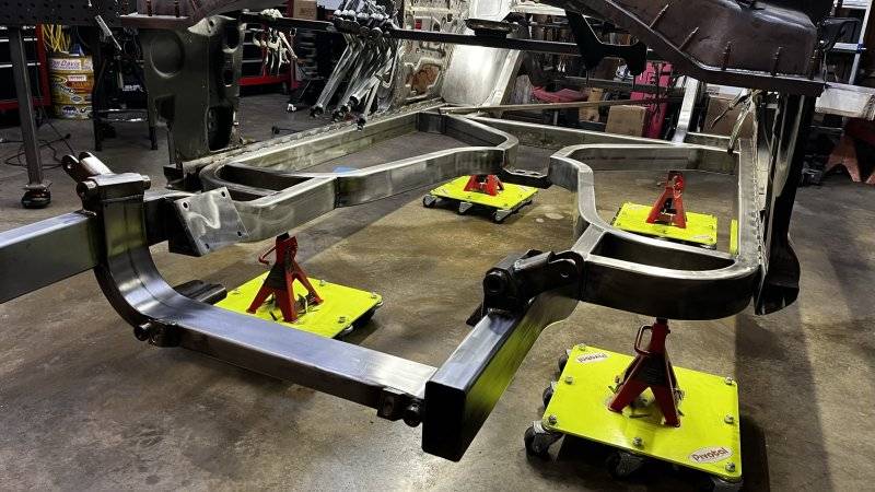

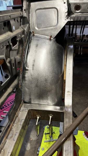

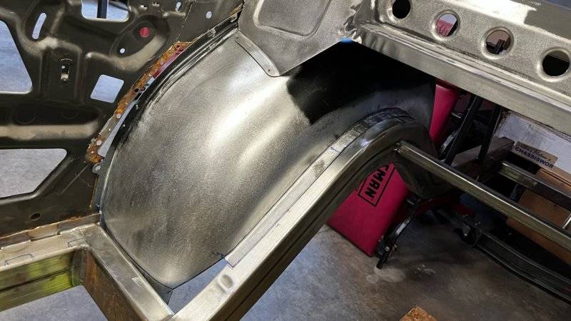

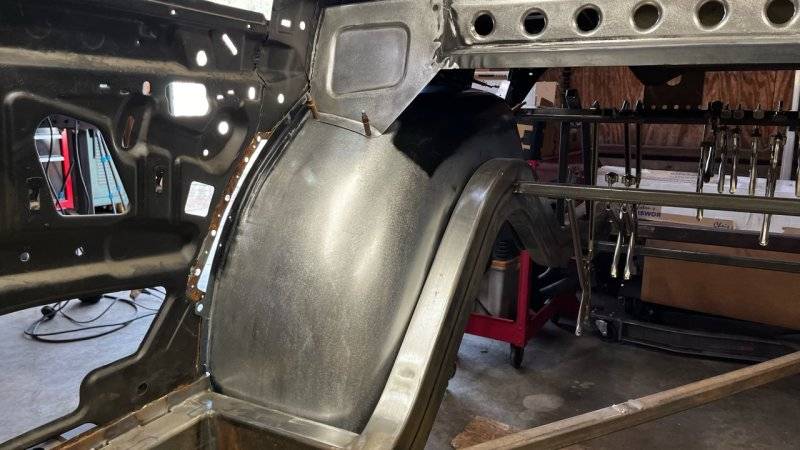

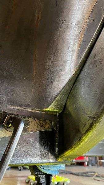

I got tired of all the muck and crud that accumulated on the frame, so I plugged a couple of hours to clean it up.

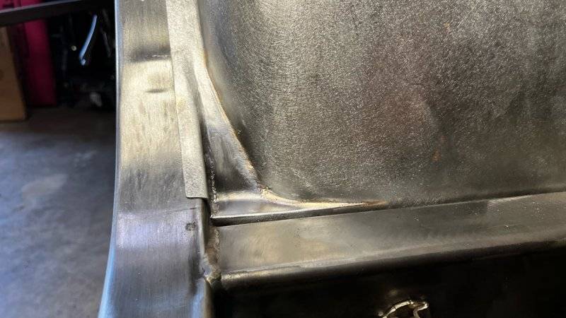

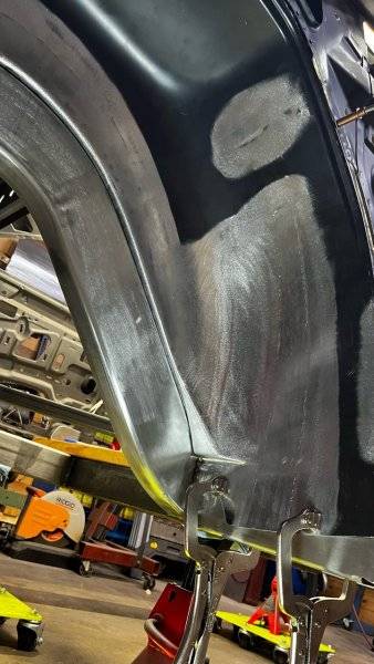

Then, I adjusted the flange on the wheelhouse to get a tighter fit, and proceeded to sil-brz most of the front corner weld seams. There's still a fair bit of blending to do.
David

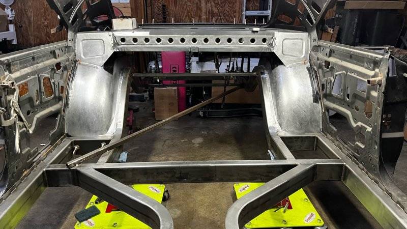

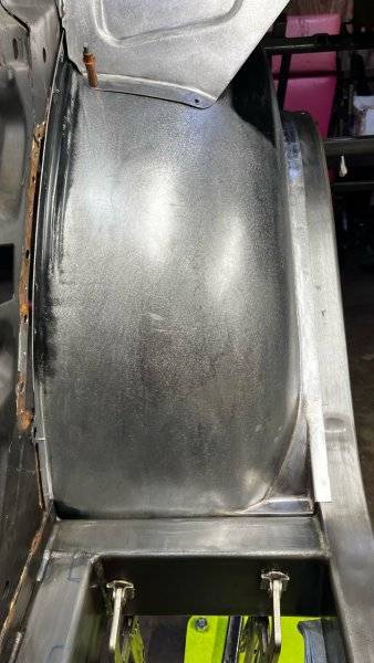

Inner wheelhouses are pretty much done for now. There’s just minor tidying to do.
