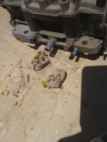

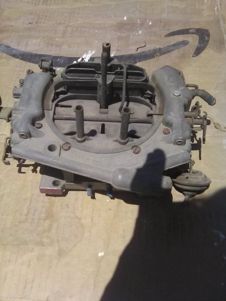

Getting ready to rebuild the 6139S ThermoQuad I plan to use on the '72 Satellite Sebring Plus 340/305 project (see thread: "Project Odyssey"). Well, took the carb out of the box it was shipped in and first thing I did was open the throttle. I found the secondaries would only open part way. Oh no!
After some looking around, I found some kind of wasp mud nest had been built into one of the secondary throttle bores. It was no problem to knock it out with a simple screwdriver. (I will be following the article on FABO that RustyRatRod posted on how to rebuild a ThermoQuad).

That's the correct factory opening as manufactured. My problem as you can see was the wasp nest was only permitting the secondary system to open half-way.
There also looks like mud in the front air vent. The MP bulletins recommended [ for WOT ] the sec blades at 88* for a single plane intake & 81* for a dual plane. It is not always about total airflow, but distribution also...
