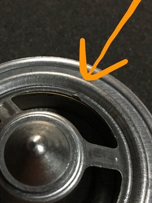

fyi
the Milodon thermostat has an integrated air passage (hole). i didn't notice it before. did the boil test and it looks all good
