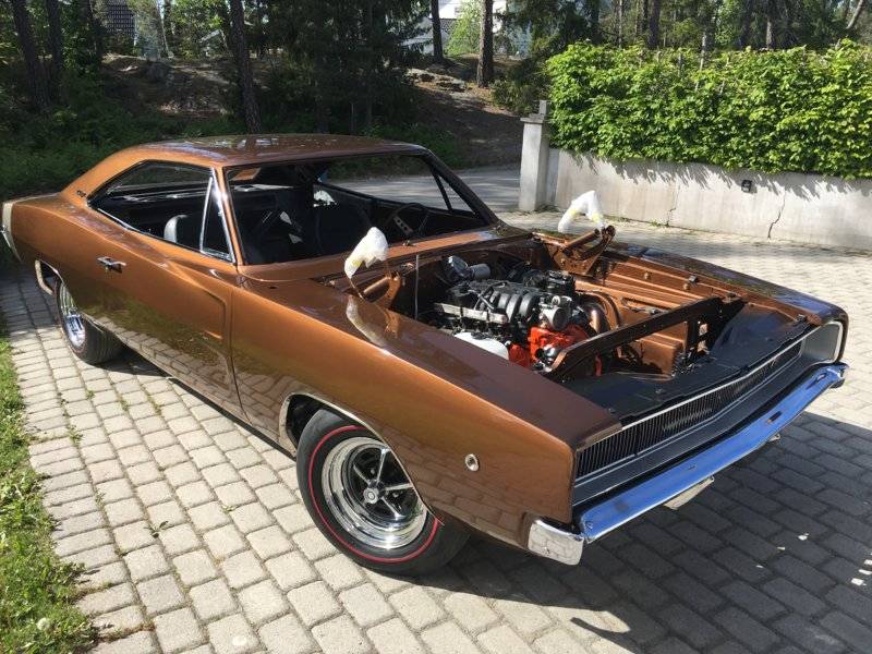

Thomas 1968 Charger project
Your car does look great in the sunshine! Keep up the good work.

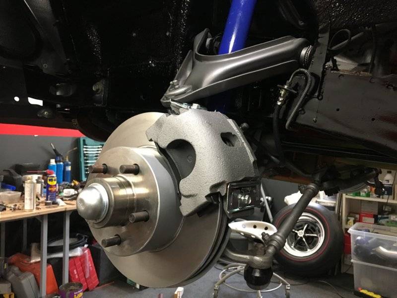

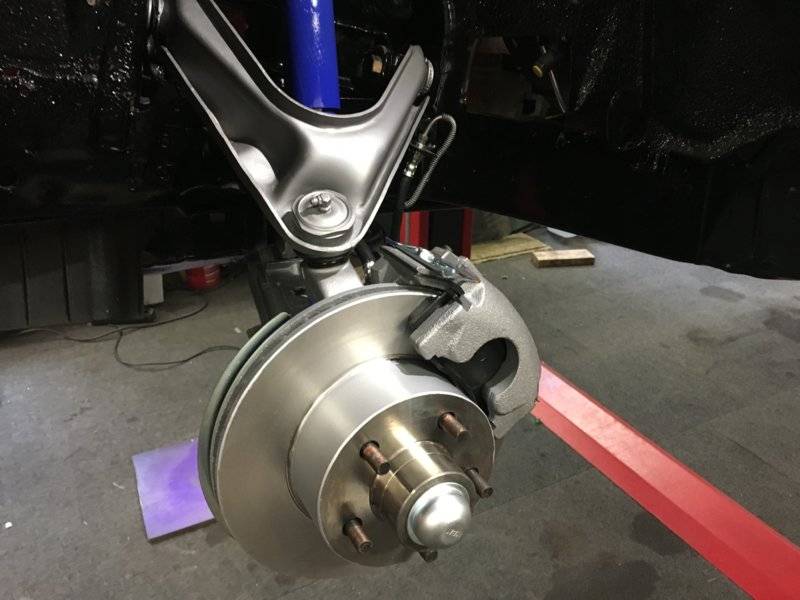

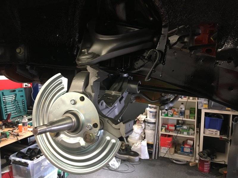

Completing the front brakes today with everything new Including the spindels

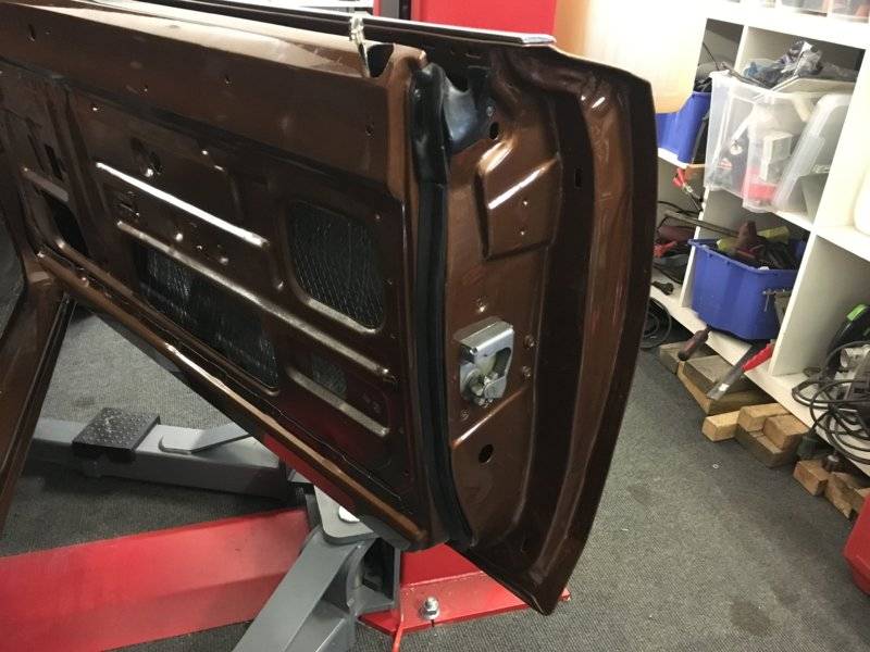

Working outside today. Sorting out wiper mechanism and door locks, so now I have working door handels:thumbsup:

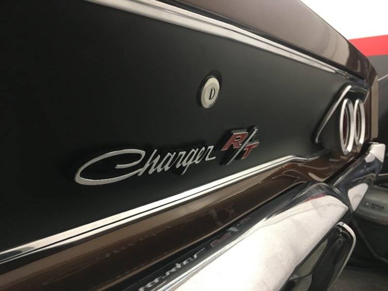

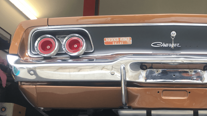

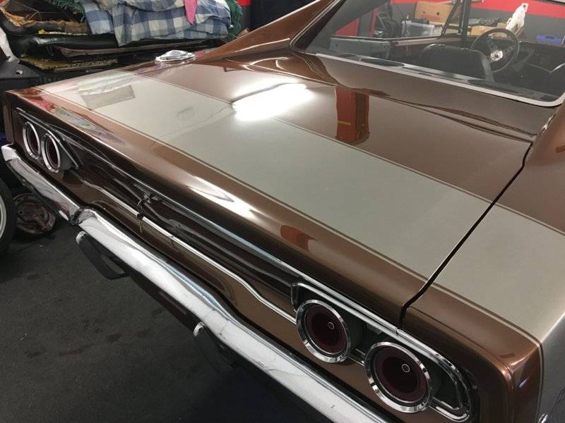

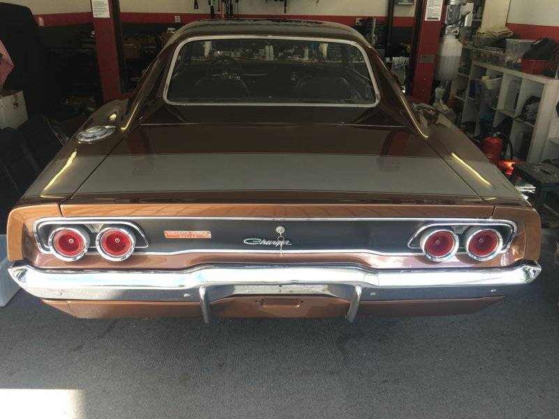

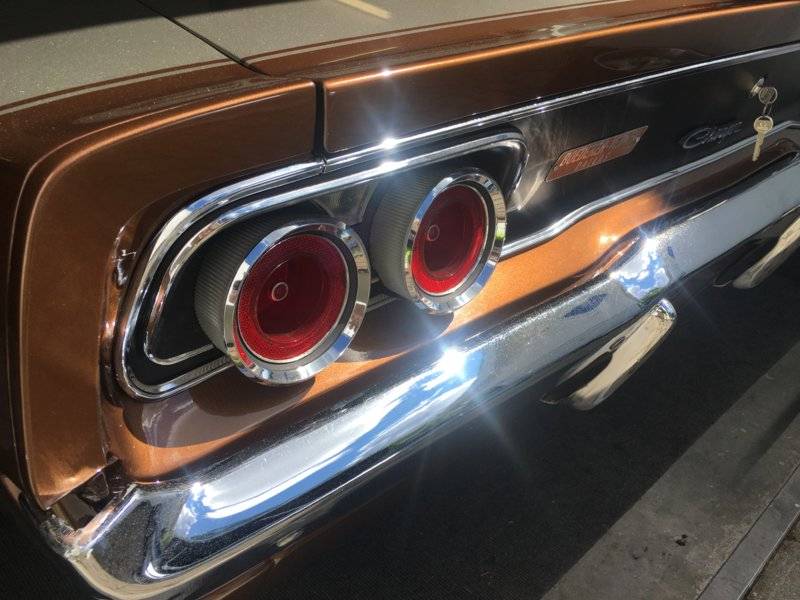

Finished up my blacked out rear taillight panel today.
Onlything missing is the R/T emblem.
Also fitted the original dealer plate that came with the car (Boedeker & Verner)
7CE0B979-7615-4921-BE9B-5D042147B1AA.jpeg 178F73AB-8034-4633-96DD-9C4674E865B0.jpeg 5E5FBF07-48C2-4582-8727-CC2956890F89.png

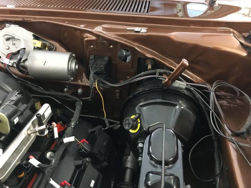

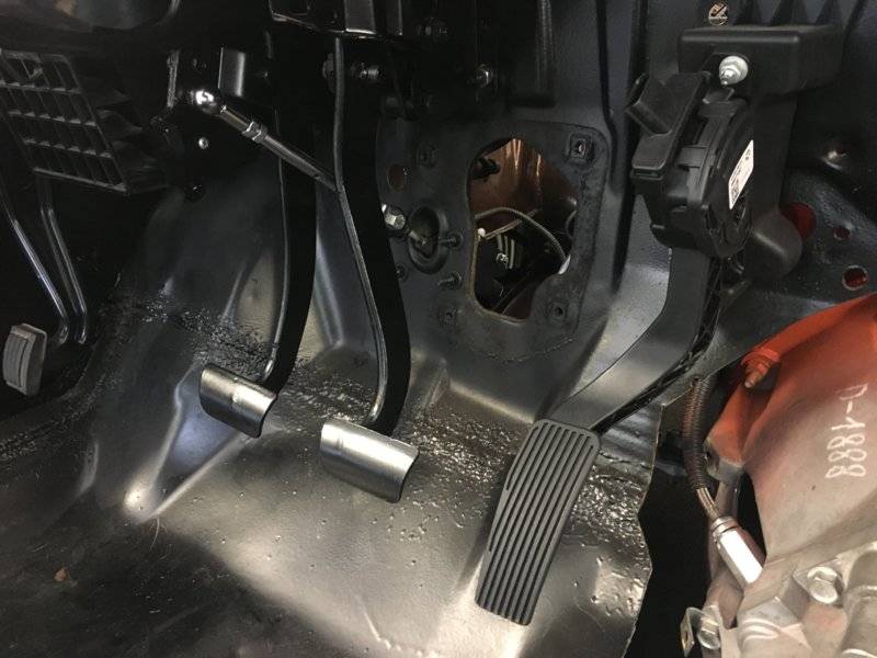

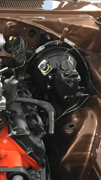

Finaly got all my pedals in working order. New electronic gas pedal from Mopar, original brake and cluch pedals connected to new brakebooster/master cylinder and home made Hydraulic clutch conversion with Brembo/BMW parts.
D76E38F1-C59B-458E-97F4-0811D4964E59.jpeg 129E1E42-19D5-4A5E-A8FD-3B8267C13309.png

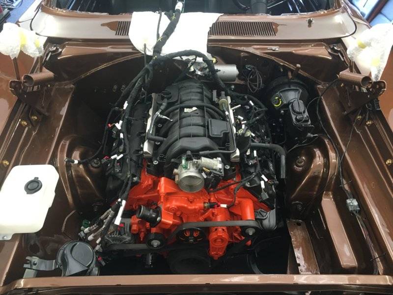

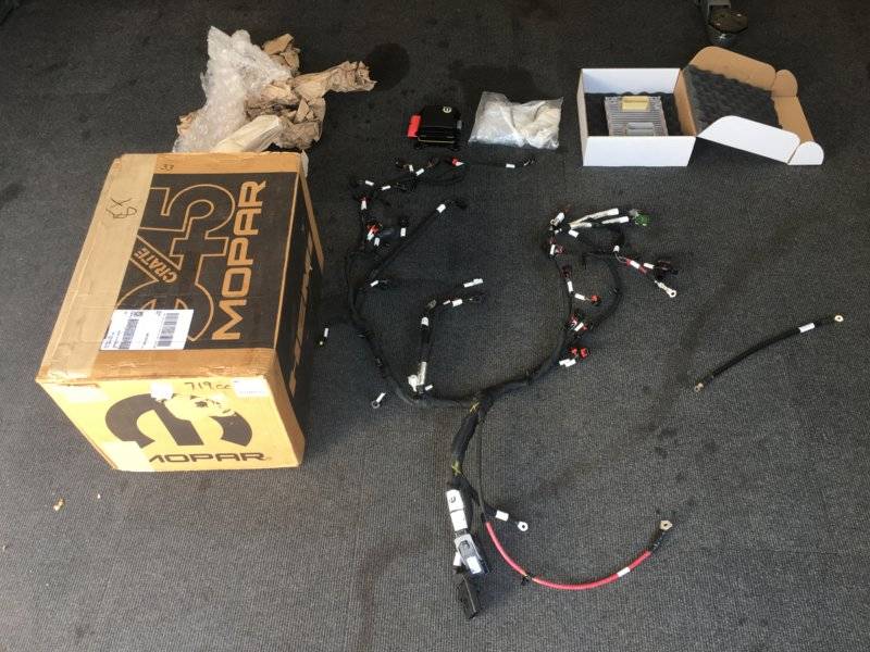

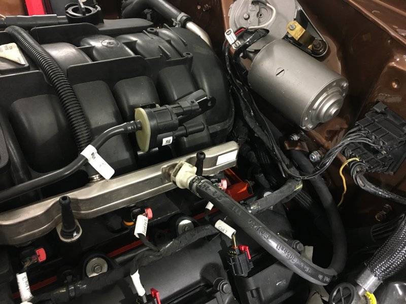

Laying out a plan for how to route the new Engine harness. Will try to get it as much out of sight as possible. Planning to place the PCM under the dash. Also relocating the battery to the trunk

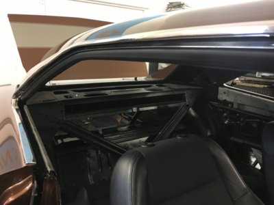

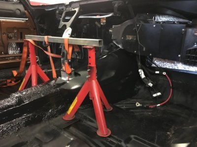

Started fabrication of new transmissiontunnel and gearbox crossmember today
22B73809-43CF-468B-A550-DC58B793FA9A.jpeg 93AC3505-C6A1-493B-BA33-5A054367BCD0.jpeg

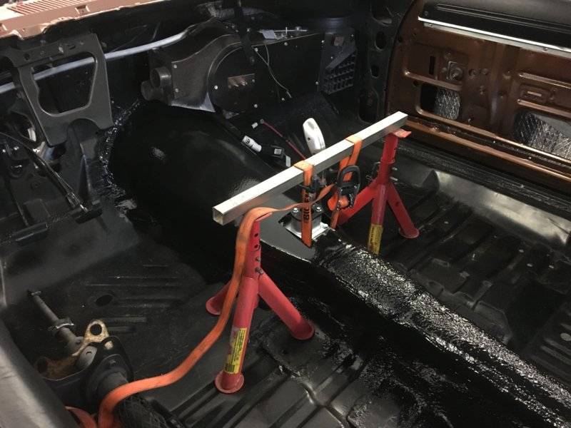

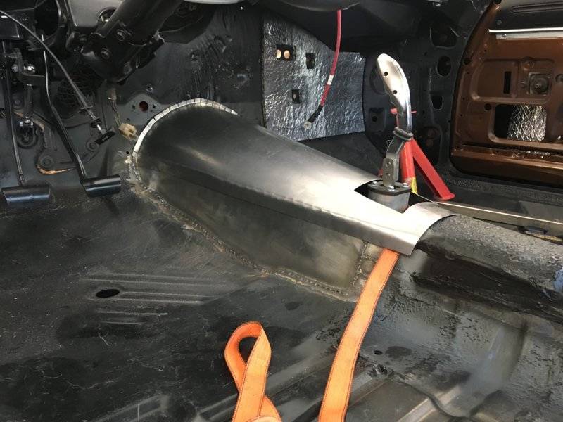

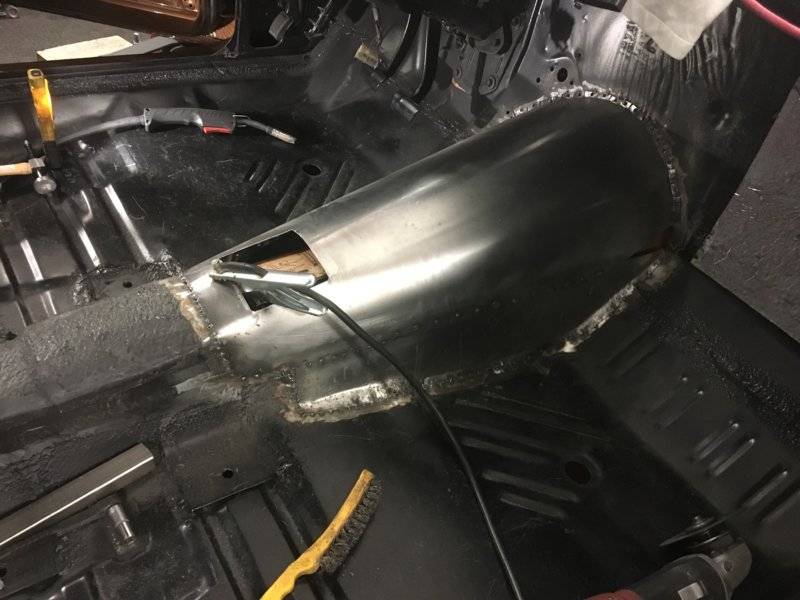

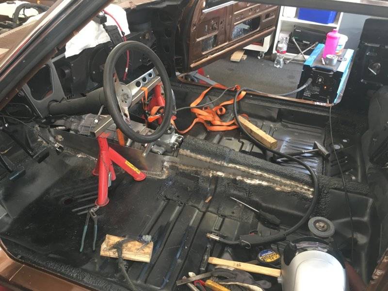

Progress on my new trans tunnel. Cut and lifted the rear part of the tunnel and built a completely new one from the gearbox and forward.Will weld in the new top part and then remove the engine and trans to weld everything from the underside as well.
Then comes rustprofing and painting to mach the rest.

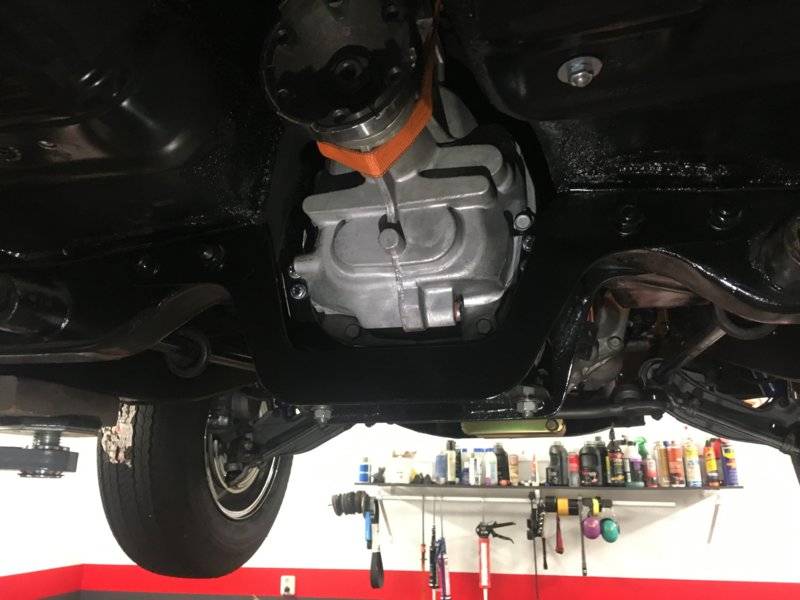

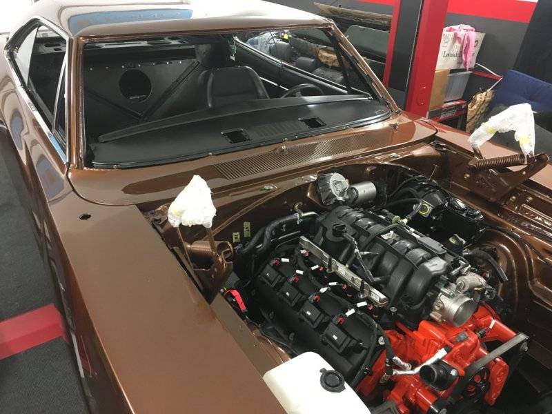

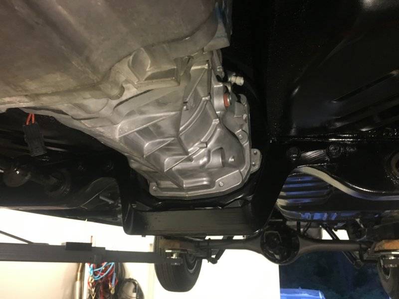

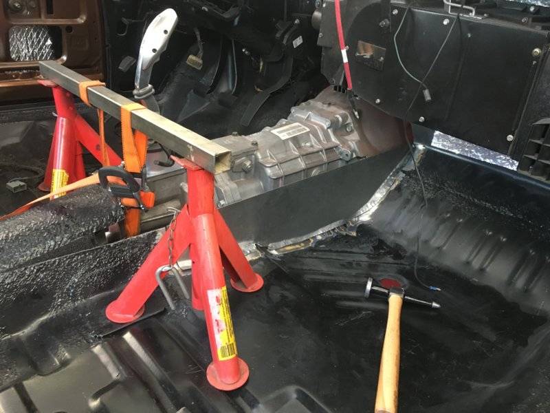

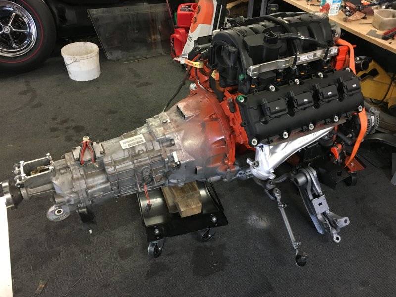

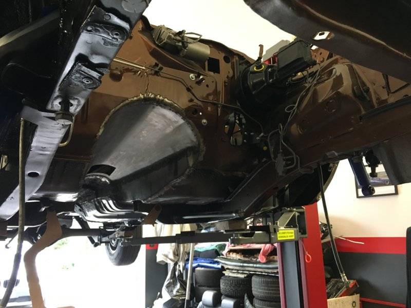

Engine/trans is out and new trans tunnel is in. Next in line is to reinforce the framework that runs above the gearbox and to fabricate a new gearbox crossmember.
BE6E6CB3-5A75-4F17-9E71-CCB512FDA032.jpeg 52249F9B-3798-45D9-B5EC-EE3E4E241A4A.jpeg 2A1E1E63-60B5-447E-B7B2-DCF66C9A8CBE.jpeg

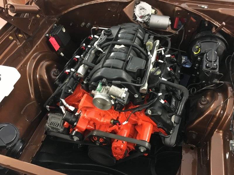

Engine and trans back in place.

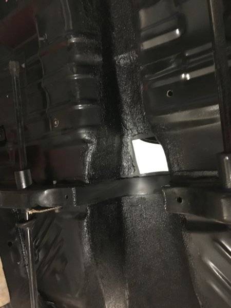

Finished the new transtunnel with a supporting brace above the transmission. All welded from both sides, primed, pianted and sprayed with undercoating. Also connected all of the new engine harness.Desided to place the PCM under the dash so had to route the harness through the firewall.
The PDC found its place in the engine bay.

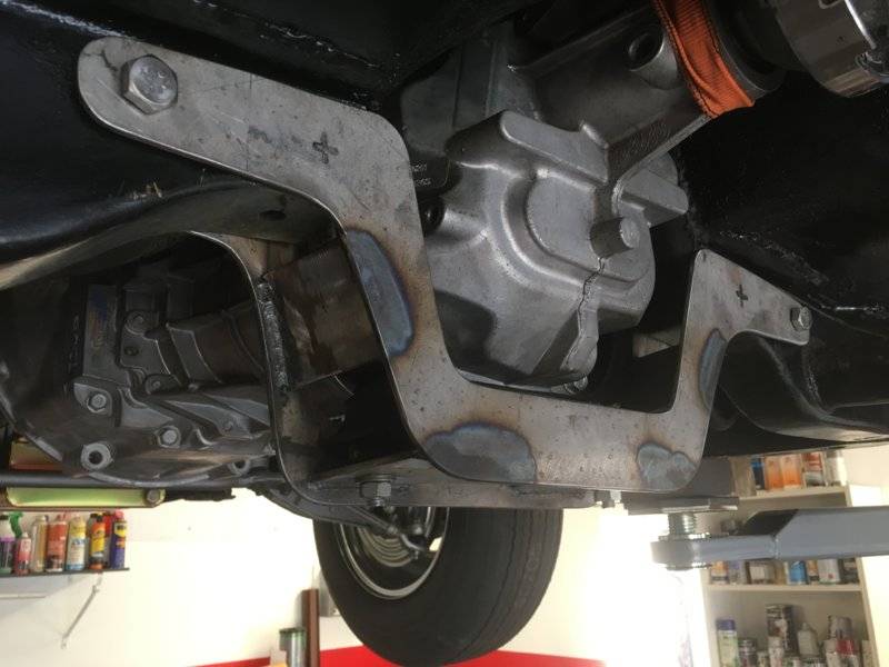

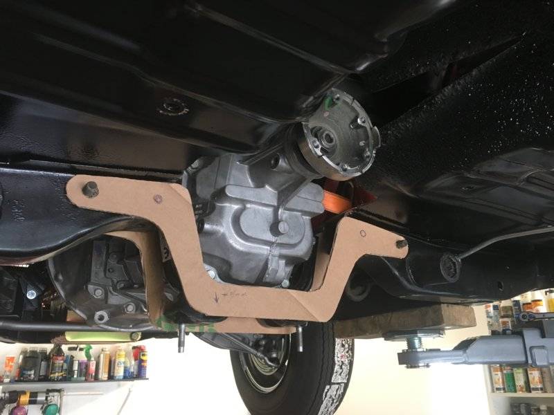

Next weekend will be focused on fabrication of the new gearbox crossmember.
1DFFDCCF-6A33-4D03-AF93-69D21F63CD91.jpeg BF9756A3-3073-4437-A51D-B1F07281AAF6.jpeg F256F6E2-EB9C-4BEC-BA84-8527CF7A1CAD.jpeg 6BA5001E-BF78-4AF7-9403-CD23697B99F1.jpeg

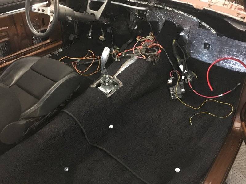

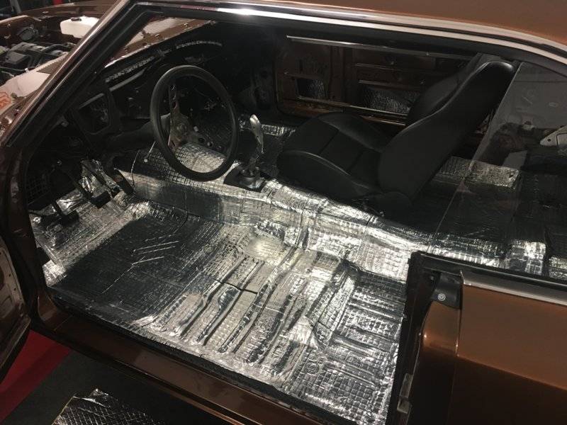

So, had some more wrenching time last weekend and tried to make the most of it.
Had my checklist and here it goes.
Finishing the new gearbox crossmember =Check
Completing the brakesystem = Check

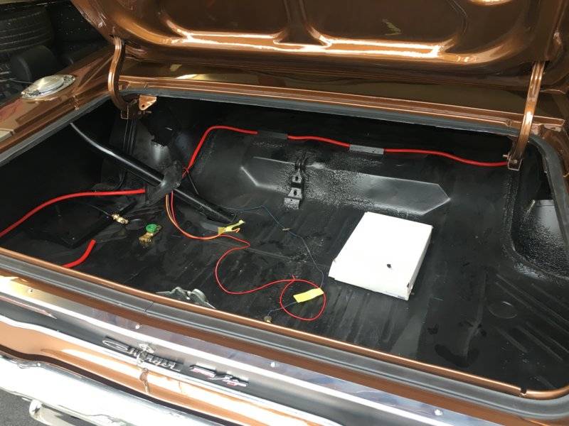

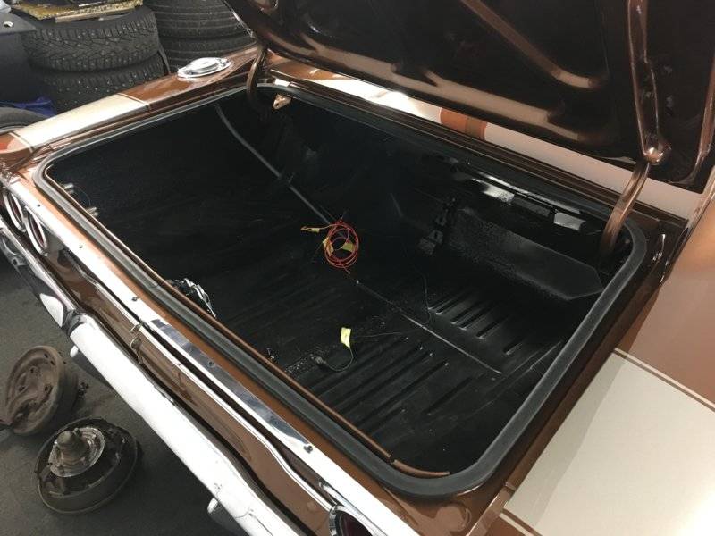

Electrical feed from trunk to firewall = Check
Welding in some bolts for good grounding Points =Check

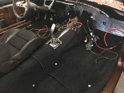

Sound deadener on the hole floorpan = Check

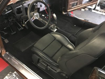

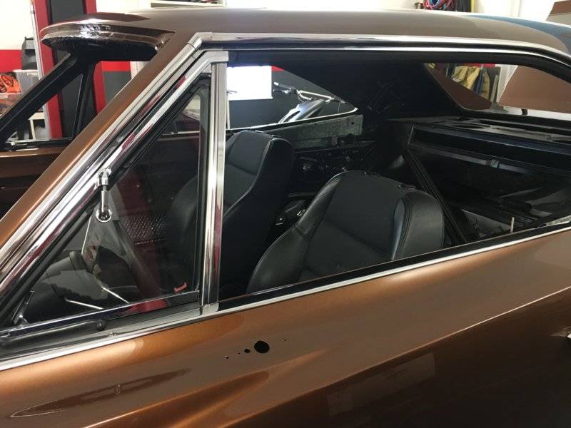

Fitting new carpet = Check
Fitting new seats = Check
Fitting new emblems on rear panel = Check
Buliding a bracket for Engine ECU = Check
file53.jpeg file56.jpeg file57.jpeg file60.jpeg file62.jpeg file63.jpeg file65.jpeg file67.jpeg file69.jpeg

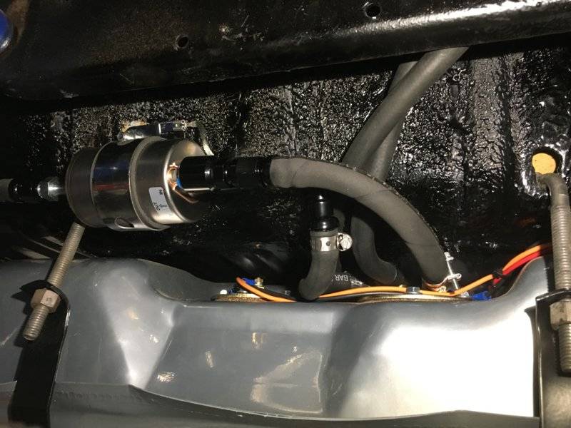

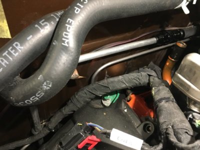

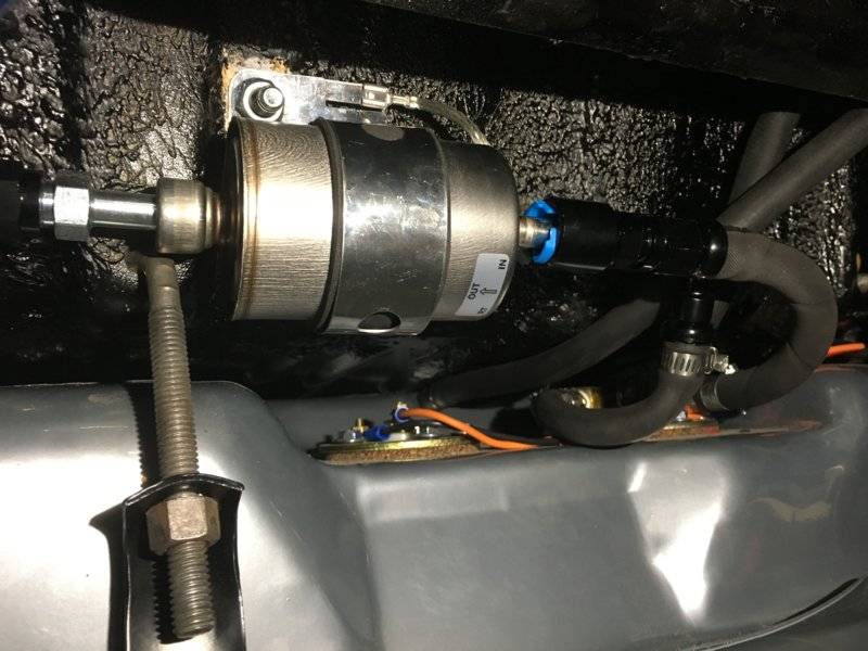

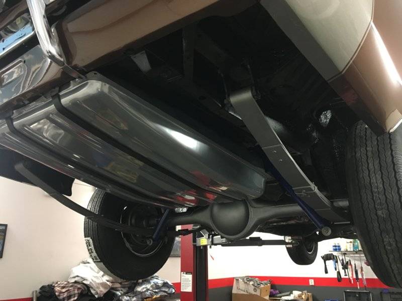

Finished my new fuelsystem last weekend. New tank from Tanks Inc with built in fuelpump for fuelinjection and sending unit that connects to my original fuel guage. Feeding into a GM fuelfilter/FPR (normaly used on LS swaps) that enables me to run only one fuelline all the way to the engine.New fuellines and fittings all the way. Trying to keep a "factory look" on everything.

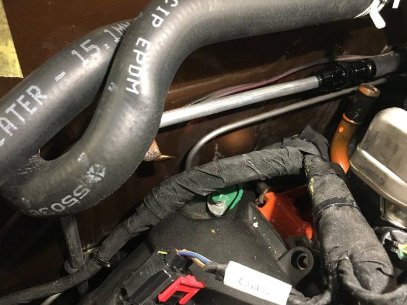

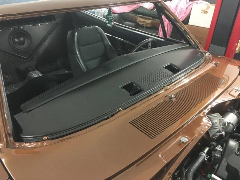

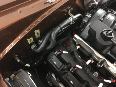

Spent the past weekend testfitting my dash and connecting my heaterbox.
Pretty pleased with how it turned out, almost looks like a OE fittment.
Used some hoses that came with the engine and other hardlines and fittings I had laying around.
Also made two custom "walls" to separate the passenger department from the trunk.
This will also dubble as i boombox in my stereo, even thou I will probably prefer the sound of my gen 3 hemi :)
