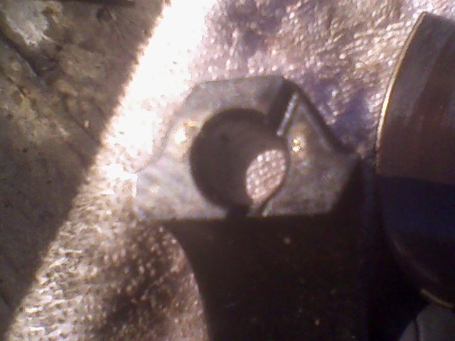

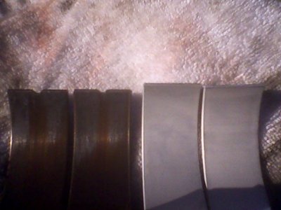

ok BB gurus, working on the 440 today , i realized that the new standard 440 rod bearings i just bought are slightly different from the originals. the old set appears to have an oiling hole or oil exit hole not sure which. the new set does not have this hole. is this critical? why would the new set not have this ? do i need to take all these and cut a notch in them ? these new bearings are a perfect fit. anybody else run into this? thanks guys

pretty sure the new ones have an oil hole in the middle of the bearing saddle and the bearing will have a hole in it to get oil to them, new style do not need that oil groove, i asked the same question when i did mine.

i read on the dodgecharger site that the new ones just dont have V grooves, some people are filing them , some are running them. no definite answers to why , WTH or if its ok to just run them

yeh i put clevites in they had holes but no grooves
That's right. All that groove is for is skeetin a little extra oil on the cylinder walls. It's not like it's not already a major splash fest in the bottom end to begin with. I know some people assemble the rod bearings in the rods, torque to spec and run a drill bit through the groove in the rod and drill a hole in the bearing halves. I've seen people try to file them and blah blah blah, but if you just gotta have that hole, doing it like above is the easiest and best way. Really in the end though, it's simply not necessary.
