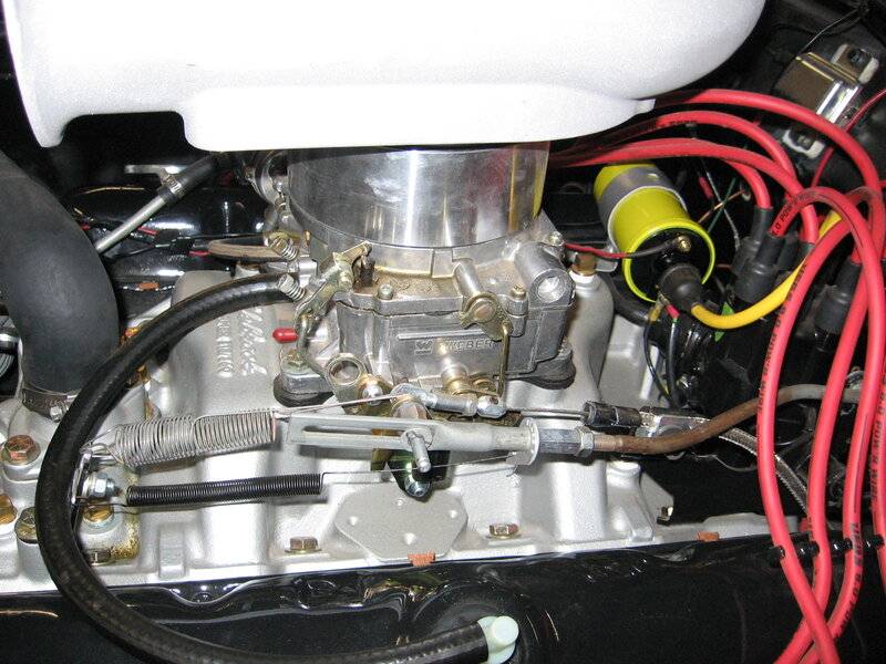

On my 63 I got a universal Spectre throttle cable from
AutoZone. In the photo you will see the coupler on the kick down rod.

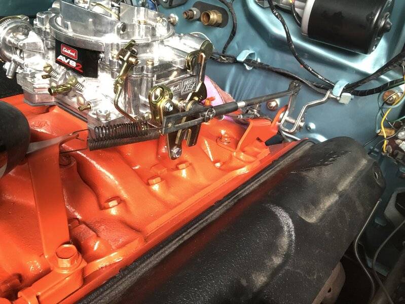

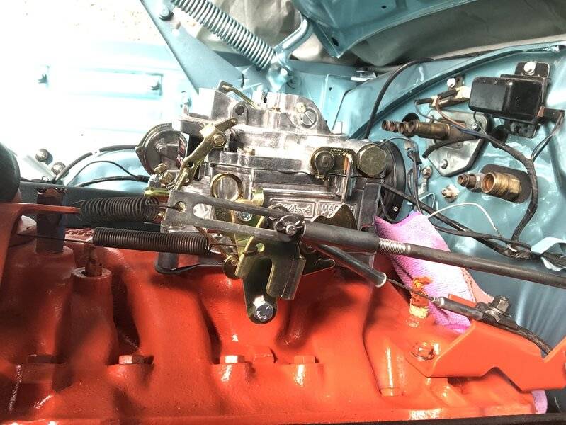

This is my Poly. The cable is barely long enough but works. What I had to do is invert the small hold down clamp on the bracket for the cable and kickdown. There is a small square slot on the top of the bracket that orients the clamp to the centerline of the engine. I had to reposition the bolt by drilling a hole so the clamp is oriented to the outer edge of the engine. The bolt just presses out then back in to the new hole.
I picked up about 1.5 inches that way by straightening out the cable. Hope this helps.

The Spectre cable has all the atachments.
As I stated not the best choice but when you are stuck on a weekend and want to get the car running...
I like VFilms set up.

Nice setup. Getting this linkage to work right is a bitch, but seems like you got it.
