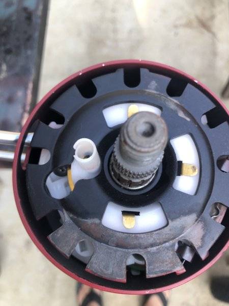

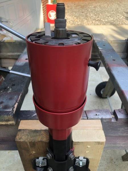

1967 gtx stearing column tilt conversion. Now my original steering wheel won’t work. Can anyone tell me what year this column was changed to and what year steering wheel will work for the turn signals and horn. Thank y’all
It looks like a Saginaw ( GM ) column. My 1987 Dakota used one. Possibly parts from one of these would fit. Maybe even an optional sport wheel.
mother mopar never made their own tilt columns. all were saginaw. my new yorker tilt/telescopic had t/s switch bad and it takes the same one as 67 corvette. as above, probably gm wheel will fit.. if your wheel has master spline, might be the problem and possible to file a slit in it.
