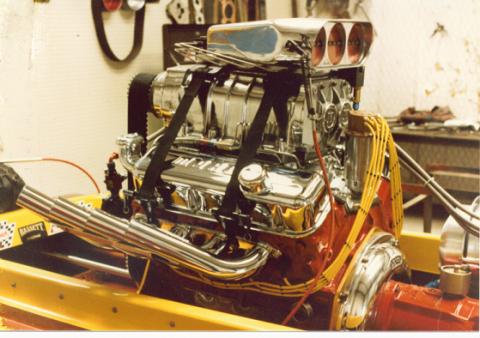

Not to hijack your thread, but it reminded of how easy it was to swap engines in our boats. We could swap out and fire the back-up engine in less than 15 minutes. :headbang:
