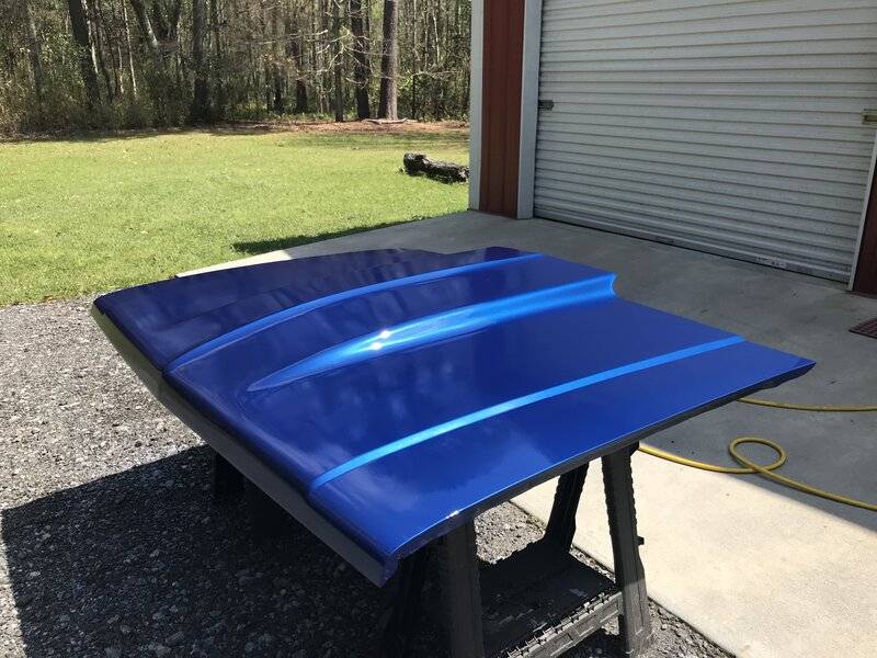

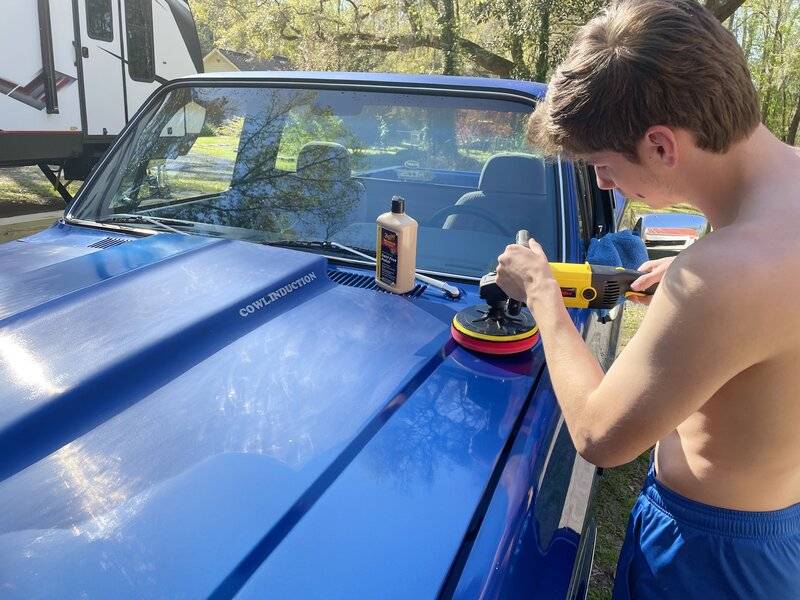

First time painter here. I wanted to practice before I paint the Road Runners engine bay, so I painted my sons hood. Prep, primer, and base were perfect. When it came to the clear it didnt want to lay out smooth. We had to knock it down with 1500 and buff it out. Not a big deal, but I would like to have it smoother out of the gun. Internet search showed hundreds of tips. Any old school painters with real tricks?

When you say it didn't lay out smooth, can you describe the results? Debris? Orange peel? Fisheye?

1. Cutting and buffing are part of the process, I start at 1500 and go up to 6000-8000 before buffing.

How hot was it? If you're painting in direct sun/heat, that's going to happen.
AHHHHHH Rookie mistake, LOL it was in the shade up until clear. I will be painting everything else in the shop....
