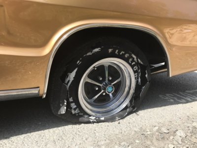

Hey all, what do you recommend for my 14 inch rims as I have to replace the full set after a worrying blow out? Currently I have 225/70R14 but want to go as big as possible.

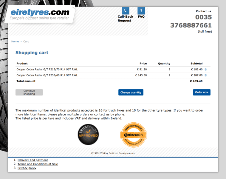

REAR - Cooper Cobra Radial G/T P235/60 R14 96T RWL
FRONT - Cooper Cobra Radial G/T P215/70 R14 96T RWL

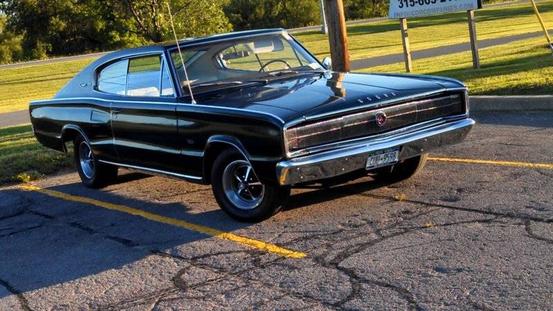

Here is mine with 245/60's on the back and 215/70's on the front
That looks lovely Don, I think you can get away with 60's on the rear once the width is good like yours as it is a percentage but I can only get 235/60, do you think it will be enough to fill the arch?.
I can save a few euro by putting 215/70s on the front, I don't mind that I can't rotate them as it does not get much milage, what do you think? would they look to skinny as I know the 70 will fill the arch ok.
