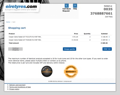

That looks lovely Don, I think you can get away with 60's on the rear once the width is good like yours as it is a percentage but I can only get 235/60, do you think it will be enough to fill the arch?.
I can save a few euro by putting 215/70s on the front, I don't mind that I can't rotate them as it does not get much milage, what do you think? would they look to skinny as I know the 70 will fill the arch ok.

So to sum up :) ... the real question I suppose is - what is more important to the look of the charger, 60 profile or 70 profile .. as a 60 profile I can go to 235 wide and a 70 profile I can go to 225. Is the extra 10 in the width worth losing the filling of the arch?. All subjective I know but I value all your opinions as it's my first time changing the tyres.
To break it down for you to decide what you would like best:
Your current tire is 225mm wide x .70 tall = 157.5mm tall sidewall height
Options you are considering:
245mm wide x .60 tall = 147mm sidewall height
235mm wide x .70 tall = 164.5mm sidewall height
With a 14" wheel, I personally would go with the 235...as it has a larger sidewall. You will notice the height more than the width difference.
