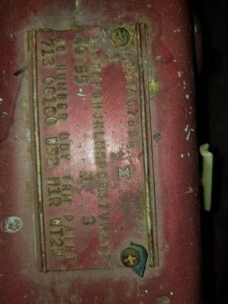

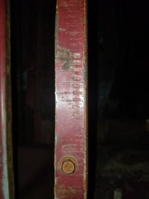

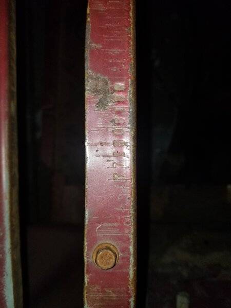

I just bought a 65 Coronet and it does not have the vin plate. Has fender tag that matches the core support. The title I got is very old from 1976. Does the serial number on title match the core support number like say a 69 B body would. He says its the correct title. Serial number on title does not have that sequence number. Thanks and how would I get a vin tag because I cant register car in Indiana without a vin that matches title.

Did you check inside the door for the VIN tag? That is where it would be located on the 67 and back cars. That car being a 65 won't have the standard 68 and up vin tag on the dash. Also that SO number doesn't match the last 6 of the VIN. That number didn't start matching until 1969 on the fender tags and the SO number was present on the tag from 1968 and back. That SO number should match the fender tag and the core support. Do they actually inspect the car for a VIN tag or do they just say that its necessary?? I can't imagine anyone now a days knowing what or where the VIN is supposed to be on half this old stuff anymore.

The only way you can match the VIN to SO is the build sheet.
So to clarify the above for the OP. The radiator support number matches the sales order number on the fender tag but not the vin. If you can find the factory build sheet this will have both the vin and the SO number. With those two And the title you could get the vin tag reproduced. The last path would be Chrysler historical who may have the IBM build card. That ties them together as well. Also a path for documentation to reproduce the vin.

The fender tag and core support match. I dont have the vin and yes I know its inside door by hinges. In Indiana when you buy a car and it has out of state title the BMV does what's called a title check to verify the vin matches title. I have the vin to car on title obviously but no tag to match so I can register car and get title in my name. I know it's the correct title to car.
