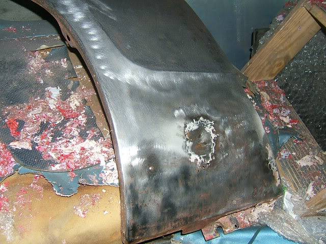

As far as your dogleg repair on that fender, measure the patch area, use a flange gun to create the step offset so the repair patch will sit flush, trim the repair patch to fit if needed, apply the adhesive, secure in place and let cure.
Myself, I stick with the welding as well because that's what I was brought up on. Buttweld whenever possible. Overlaping can create air gaps on the backside that need to be sealed, but so can just laying a panel over another and plug welding like a quarter to trunk gutter or floor pan to crossmember if the panels are not perfectly pressed tight against each other. Matt brought up a roof...obviously the roof is layed over the inner structure. It needs to be bonded all around the window frames, across the pillars and along the rail gutters. You can drill all the holes, pull the panel to the frame as well as possible and weld and hope there isn't too many gaps in between the inner/outer and then proceed to grind down a bazillion plug welds. Or, you can lay the adhesive, secure the roof and any gap is eliminated by the adhesive....Walla
Just because the panel bonding is a newer technolgy and they didn't do it back then (it didn't exist), doesn't mean it doesn't work as well and can't apply to our cars. Welding and adhesives both have there pro's and con's.
BTW...nice work on that fender!
