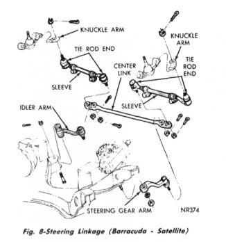

My front wheels is standing with a really big toe-out..
I want to do a rough adjustment before I'm driving to the service.
I loosened the nuts that are holding the "sleeve" in position, but I then cant move it... I sprayed it, but i cant get it to move... Do you have any clue what I'm doing wrong?
How do i turn the sleeve without damage it?
Or is this the wrong way to do it?

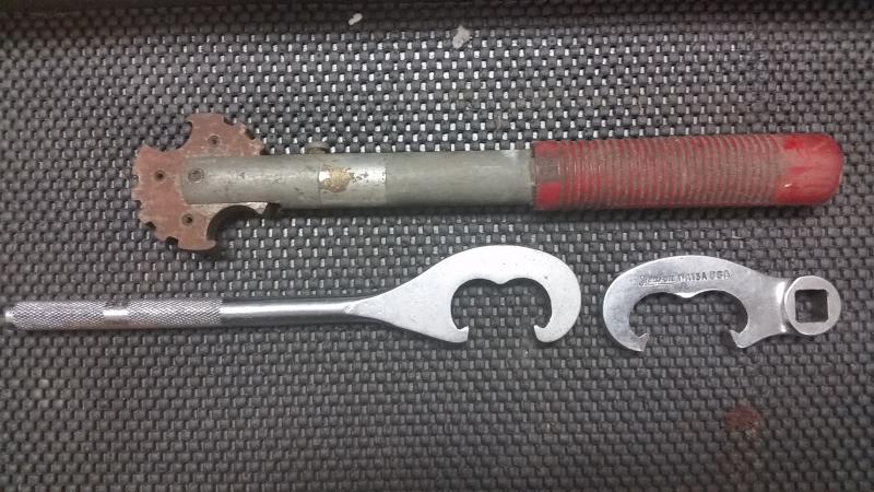

CargerPilot: I wish I had that tool... But was hoping to get it done without it... How does it look?
It has a tooth that goes in the split so when you are turning it opens the crack
If you can get a small chisel in split it may help
