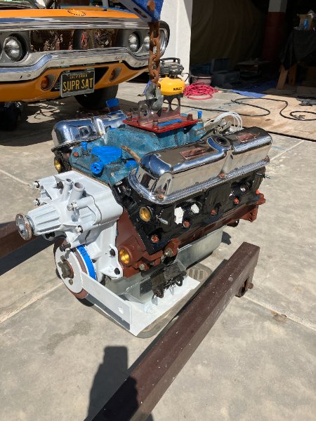

When I re-inserted the same dipstick tube in the 340 I rebuilt, sure enough it was a tad loose. Now that it's installed and running in the vehicle, it wants to just fall on out. The silicone or whatever I used to secure it was a complete and utter failure. Any leads for me on a decent replacement? Working on a '72 Satellite Sebring Plus.
