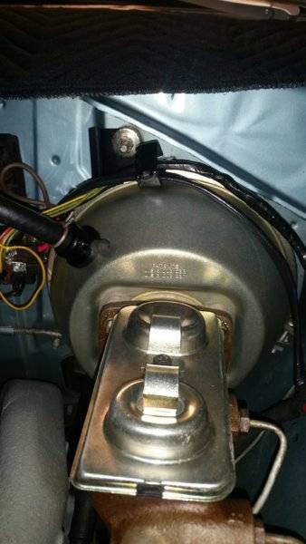

Here's my 65 PB booster. Getting ready to install the new check valve. I do not have much confidence in the results.
thats a Midland Ross booster,need to get it apart and take a look inside, if the check valve doesn't work. There is a mopar brake guy master power brakes i think. He will know.

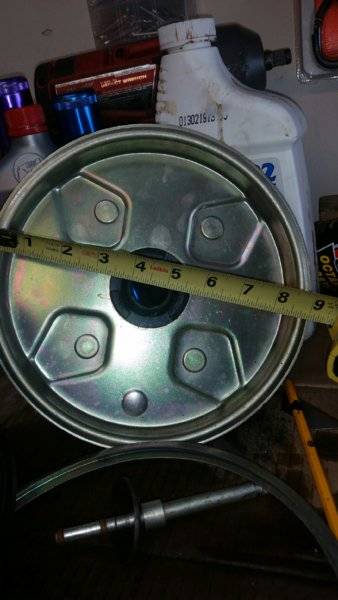

Just disabled what I could get apart, it takes specialty tools.
However it is not a midland ross, it's a reman ARROW.
SHOP MANUAL WAS NO HELP.
I'll clean and detail what I can get to and reassemble and reinstall.

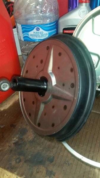

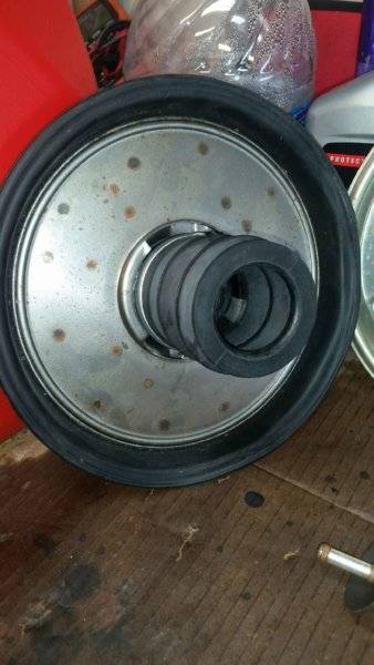

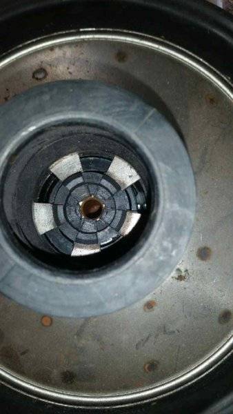

Here are pictures of midland ross mopar b body power brake booster. See if this looks like yours. Additionally check the rubber that is sandwiched bet the two metal plates for damage, also take out the master cylinder push rod and check the inner star reaction ring for damage.

Very similar but different. The rubber is soft and in excellent condition, I can not get it apart to look at the star guts.
My star has twice the number of tabs.
My shop manual shows how to dissemble the one like yours but mine needs a special tool to get it compleatly apart, I can not remove the push rod.
