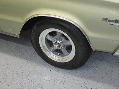

I'm running 245/60/15 on my '66 Satellite on 15x7 TT D. I couldn't get a 255 in there without some rubbing up high in the wheel wells, but your Coronet might have more room.

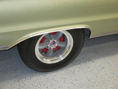

I run TT 15x6 front and 15x8 rear. Front tire is a 215-75-15 and rear tire is Mickey Thompson 28x10. Rear bs is 4.5.
