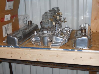

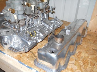

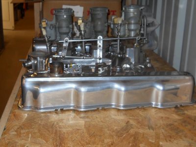

a 318 poly stroker up to 412 ci. pushing 420hp. that's what's I am going for with a Edelbrock p 600 3 deuce manifold on it . 001.jpg004.jpg001.jpg003.jpg

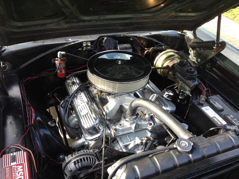

Build what makes you and your wallet happy. I had the same question for my 66 charger. Rebuild a tired 318 or build a 360. I found a 360 block from a 77 van. Punched it to 365 CI, keith black pistons, edelbrock heads, roller cam, air gap manifold, 600 CFM carb. Makes 410 HP & 440 Tq. Yes, its not the original motor but I like it and thats what counts. Yes i heard opinions from others on what they would do, but its my car and my decesion. Build it, drive it, enjoy it! Its better than everthing else because its a MOPAR!
