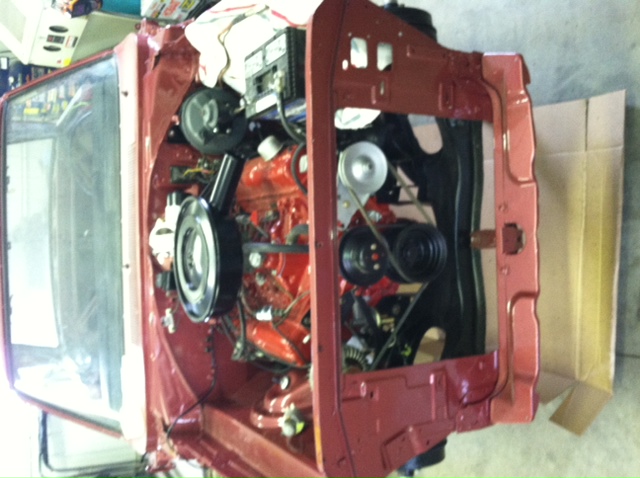

Stick with the Poly, I rebuilt mine and it did not break the bank, I even stayed with the solid lifters. You can make a monster out of it if you like. Mine sounds very nice with a mild cam and series 50 flowmasters.
