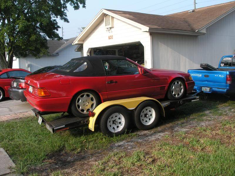

I used a Uhaul car trailer to to my 68 Sat from Long Island NY to Delaware with my 2005 Grand Cherokee 5.7. Towing Capacity on the Jeep was 7500. The trailer weighs 2000, so add the cars weight for the gross. The trailers are pretty nice, I like the surge brake set up. You didnt say what you were picking up. My Sat was a few feet too long and over hung a few feet past the trailer. You WILL use plenty of fuel. Good luck !!

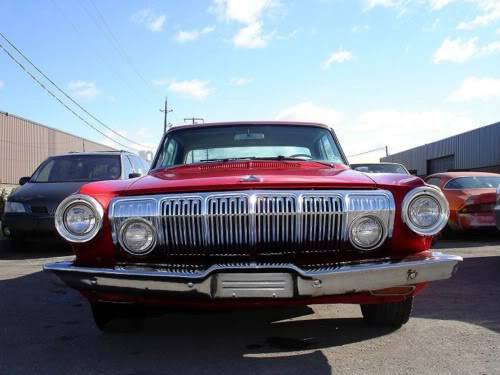

I am picking up a Texas bodied 63 Dodge 440...
That must be a nice solid body- Congrats- and take a few pics for us of your journey

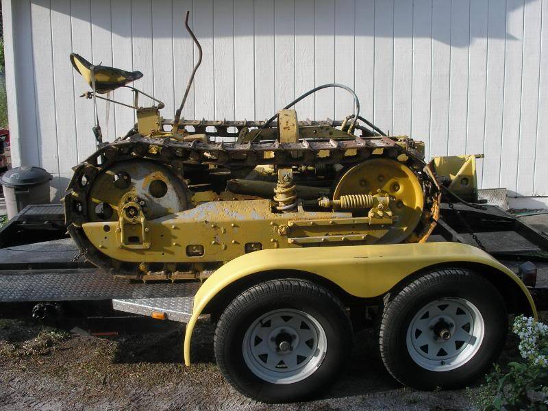

I have a 2002 Durango with the 4.7 and 3.55's and I tow with it. It does just fine towing my 76 Tahiti jet boat or a 1900 lb trailer with a mid size car on it. Probably the heaviest thing I towed was a 71 F250 and a 70 Chevy truck but those were short distance moves. OD off through the mountains and up hill in second. Very recently I got back from a 500 mile trip towing a heavy B body. Make sure you have functioning trailer brakes!

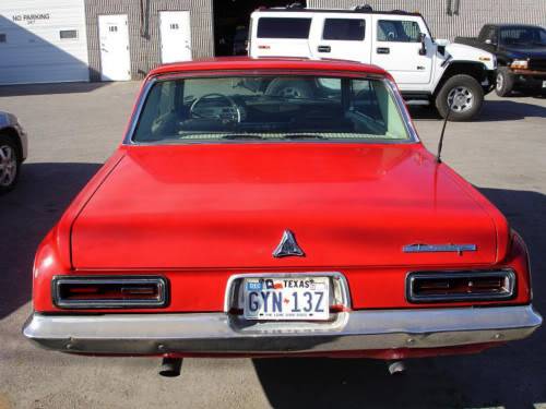

This is what I am going up to get....
Nice car!

I've done this about a dozen times with that car and my brothers 66 Sat,
