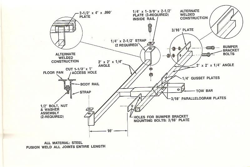

Chrysler gave the plans to make them in their literature (possibly the back of the owners manual, but I don't recall for sure) up til the early 70's. Attached is a screen shot from a Dart that I grabbed when researching hitches for my wagon at the time.

Did it attach to the bumper area only or go towards the front of the car like the Dart example I posted above?

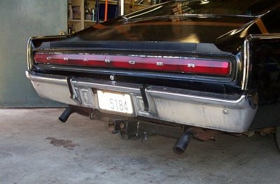

this is mine mounted to the tie-down plates
