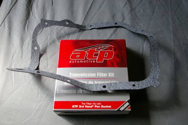

I've been using these for the last few years, comes as a kit. After filter change I clean surfaces then install gasket and pan. No sealer.

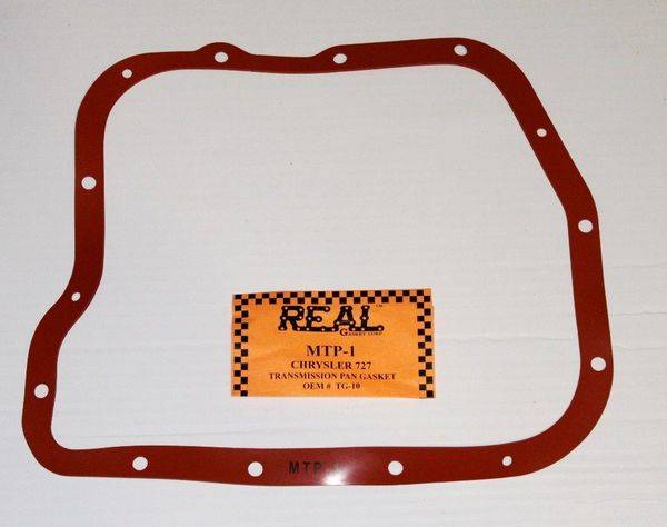

I'v rebuilt many transmissions in my career and have always used the cork gaskets available from the trans parts houses with no sealer. But now I would use the newer gasket available now that 65 440 shows in his link. But I also agree with previously stated that most pan gasket leaks are coming from somewhere else.

65-440 is using the right one, when I bought one I bitched and griped about the price, but, the trans has not leaked a drop in 5 mo.s, I am tickled!! I had to give 41.00 for mine. Dave.

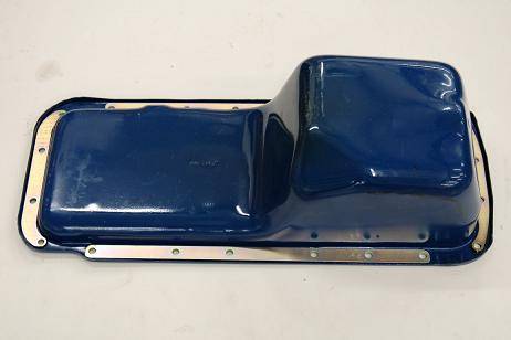

As mentioned before, pan flanges get distorted at the bolt holes from improper tightening. Has anyone ever used these? Seems like they would distribute the tightening force more evenly and protect the holes and flange.
AR Engineering, $45.
