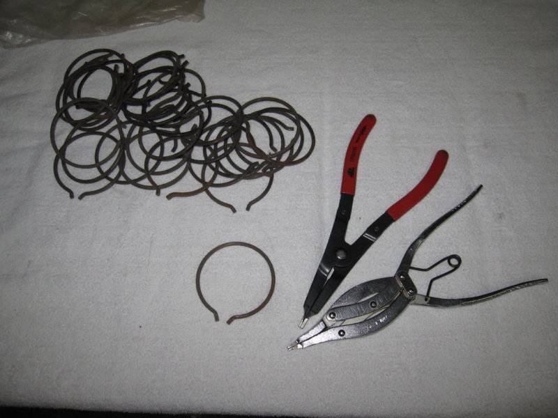

Is this the ring? If not I have all the others. I have found this ring needs a pliers that can open very wide to expand it. I have 2 different MAC brand pliers but only the red ones will work on these rings.
Mike
MikeView attachment 614341
Holy smokes Mike thats alot of rings!!!
Those appear to be just like the one that came out of the transmission housing.
I picked up a pair of snap ring pliers (reverse) at O'reilly's and it appears they will open the ring wide enough to work. They are very much like the photo in Bobzilla's post above.
Now I just need a ring...
I will buy one from you if you're open to selling one.
