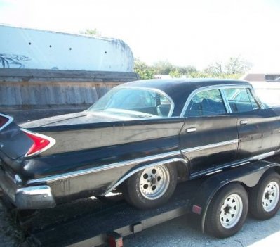

I have a opportunity to purchase a 1960 Windsor with a frozen 383, condition of tran unkown besides being there, but the price for cheap and car is complete. Have a (was running when pulled) 440 out of a 74 New Yorker no transmission. Easy switch? K frame, trans.? Also have a complete running 1964 318 poly and pushbutton 727 as a power option.

'60 will have the extended crank flange and an iron torqueflite. the '74 440 will be externally balanced. i see crank flange and balance issues.

Floor plans ,trunk,brakes, no drive shaft... I passed even at 1500.00 . On Sarasota Craig's list. Seller said it just needed a starter.
"just" needs a "starter" - i.e. somebody to "start" all the floor, trunk, brakes repairs it needs...
