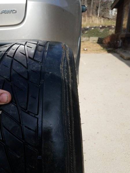

Trashing front tires... It's getting expensive!!

I'm going to throw this thought out there.....are these tires Directional's?
I recently had my wife's car balanced and rotated, and discovered that the two front tires were on the wrong way around - directional tires.
This will kill tires prematurely.
Not saying that this is your problem Devin, but it might be an idea just to check it out.

Tried to get it in the shop since I had it out with no luck but now that I had it out the tires are at rest vs being lowered from the lift, good time to throw a level on them. Both rims are leaning in a 1/4" in 12" (used a 12" level), that's a problem! How does an alignment shop say this is alright or how can it get this badly out after an alignment?
With the weather slowly starting to show signs of straightening out I bought new tires, bought Nitto 555's. The Charger is on the lift right now where I'm trying to find a cause but nothing to be found as of yet. I'd like to get the camber closer before driving it 15 minutes for the alignment but have a question, is it normal for the camber to change considerably between just being sat on it's tires then moving it around? I know anytime you sit the car down the tires push outward as the suspension travels up so I'm thinking it's normal? As of now I think where the problem may lie is the guy that's been doing it has to jack it up to access the camber bolts then let it down to check the alignment, without moving the car back and forth I believe it's not settling causing a false alignment?
I'm also wondering if my spindles could be throwing it all off, as best as I can tell whoever had the car previously put 71 or so B Body spindles on it?
