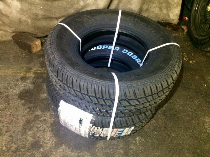

Trashing front tires... It's getting expensive!!

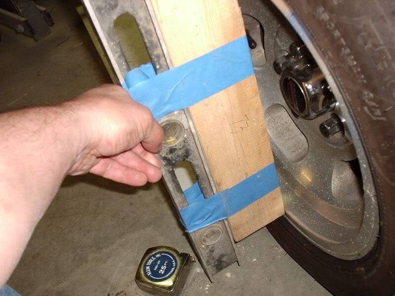

Not sure how you measured that with a 12" level. What you furnished comes out at 1.19° camber.
I had a 12 level handy so I just held it vertically resting on the rim lip, basically held plumb but off center where it caught the lips and not the tire.

I thought about it but didn't want 2 more tires to deal with getting rid of so they stayed with the tire shop but like I said I took pictures.

Would require all 4 corners and a level floor. I find a L square, protector and pointer to be more accurate than using a level.
Small square 12x6 tape the protector to it. Install pointer at zero long enough to read angle. I remove the wheel bearing dust cover and set the square on the machined hub.

Thanks for the info Kern Dog. I'm pretty sure I torqued my LCA bushings while hanging but then again I used Poly bushings where they aren't bonded so it shouldn't be an issue? I checked mine more accurately last night, I used to equal length shims to get my 4' level outside of the fenders. The left tire is tilted in 7/16 on top and the right is tilted in 5/16, this is reading across a 19" span (rims are 18s).
