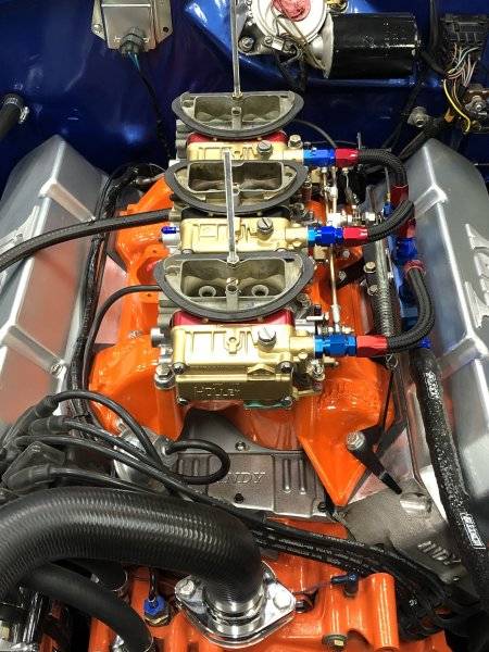

Completely disagree. 240 isn’t a big head at all, even on a 440. I run a 6bbl on some Indy SR’s but they’re raised port. Definitely hike the intake up a bit. Shouldn’t be an issue with the Trickflow.

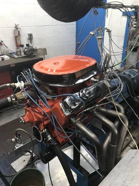

Here’s an engine I built with 240’s, they don’t extend into the valley like a raised port head. So there should be no issue.

i have built a 505” Trickflow 240 engine that retains the oeiginal Six Barrel cast iron intake manifold and carbs. The block was just cleanup decked. It runs very well and we dynoed it with both a Holley Street dominator Intake with Holley 850 and then with the Sixbarrel setup with factory air cleaner.
The results were:
Street Dominator
635 lb ft @ 4400 rpm
594 hp @ 5400 rpm
Factory iron Six Barrel w/ factory air cleaner installed
608 lb ft @ 4300 rpm
576 hp @ 5400 rpm
The results were:
Street Dominator
594 hp @ 5400 rpm
576 hp @ 5400 rpm
Very nice! Thanks for the reply. This is exactly what I was wondering.
