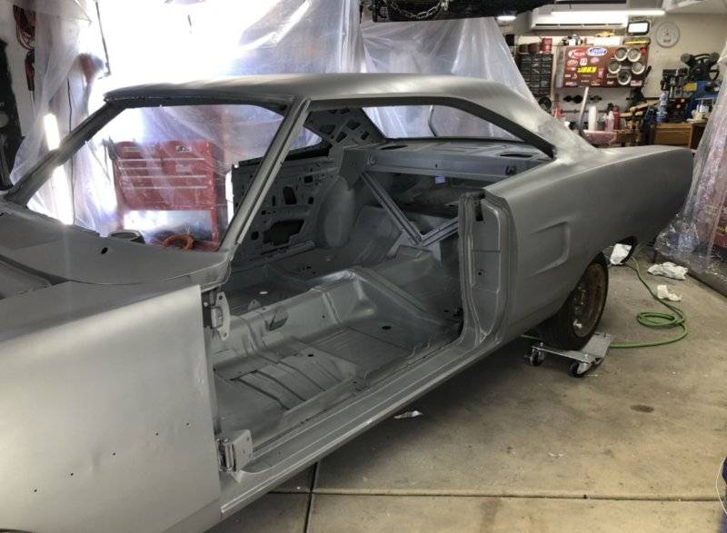

Hi guys, wanted to gain some insight on things I should plan to have in place with respect to clips etc prior to paint ie during body work. I know this is a pretty open question but its kinda meant to be so I can make a check list. Something like “Things to do prior to paint”.
Any insight appreciated……

ThNks guys but I guess I wasn’t clear on what I was asking. The car is completely striped of all clips everywhere everything. What I am assking is as I prep is there any clips or things that I should put in prior to shooting. Just starting the body work.
Nothing I can think of offhaand.
I wouldn’t. You want to coat all that bare metal before putting anything back on
Thanks thats what I figured but the reassurance helps move through unknown places!
