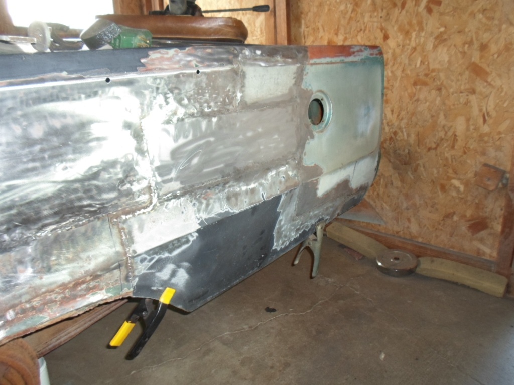

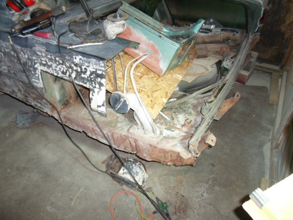

Thanks for the replys.I.m not adding much filler but is a section about a foot long that looks flatter.Can really notice it with a straight edge even thou I know the quarters are not straight but I can tell from the other side about where to be. This the mess,not turning out too bad for a first try thou.

make sure you have no "high" metal .......... tap down the high spots or you will pull your hair out
That's a nice rebuild job there. I would use fiberglass type of bondo for what you are doing . There are several brands but not sure what is available in your area. Bladecutter has a thread here about mixing Your own and it works I've used it on my build. Maybe someone can post a link to it. Good luck with your project.
A lot of different replies from rip it out and start over to how to block sand it out. Maybe it would help to clarify what you are dealing with it you lay a long piece of straight wood or pipe down the side and measure the largest gap that will have to be filled with filler.
