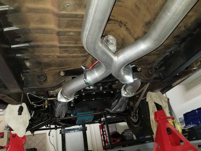

Installing 3" TTI system in 68 Charger. Working from back to forward. All went well until installing X pipe to header adapters. One side lines up good (drivers) but passenger side is about 2 inches off. No matter how I reposition the X pipe, mufflers, ect, I can't get the adapter to align with the header flange. I know there is left and right side and confirmed correct. Anyone ever run into this issue? Also it looks like the header to X pipe adapters should only go in one way - there's more clearance between car and adapter if orientated one way. Does this make a difference??

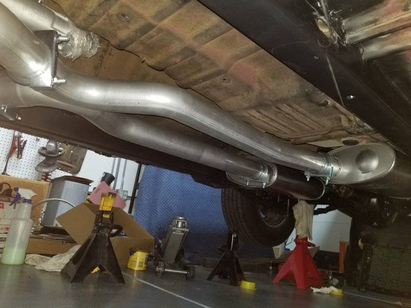

Helped a buddy with a 2.5 system couple years back. Started from the front. Couldn't get tailpipe on. Read the instructions. Install rear to front. Fit like a glove.
I have the 3 inch on a 65 B body. I had to install front to back and did it single handed. It fit like a glove. Doing it from the rear was impossible. But keep everything loose until its all aligned. I also suggest you don't use their clamps. Use the type that summit sells that don't deform the pipe. If will make pulling the system apart a lot easier.

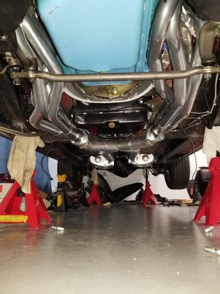

Got it in. Took everything apart from mufflers forward and reinstalled. It went together like it was made to go together. Only thing I id becides remove/reinstall was to clock the passenger side header collector.Thanks for your input.

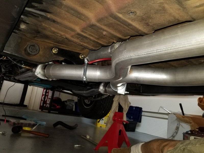

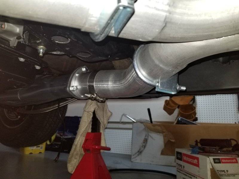

Same issue with my right side 3 inch TTI H pipe that bolts to my TTI headers. The right side pipe heads towards my drive shaft. Left side pipe and headers are perfect fit. Plan to bring to muffler shop later this summer. For the price paid I expected better.
If thats a shifter cable you might want the look at heat shield options or re-route the cable.....
Yeah that's on the to fix list. Didn't think it would be that close when I originally installed the shifter. Thanks
