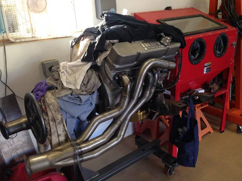

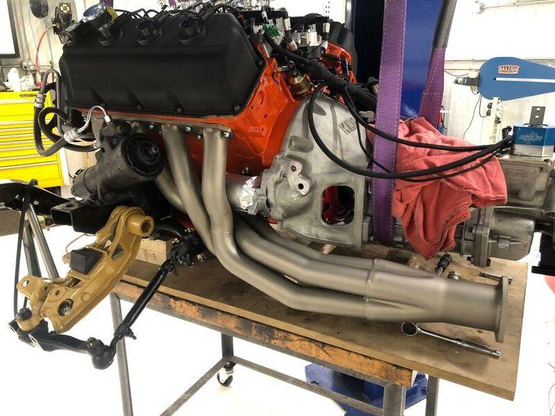

Not sure if it would be relative to your car but I just put TTI 2 1/8 headers on my 69 and fitment was impressive, no problems with power steering.
My engine started out as a 90's crate motor so whatever you would call that Mopar block.
Just wanted to mention that as the #1 primary curves in and gets rather close to the block. (so if your World Block is for whatever reason a larger dimension there you may need to do some slight clearancing).
Very impressive picture, it shows my they should work....barely, Thanks for replying!

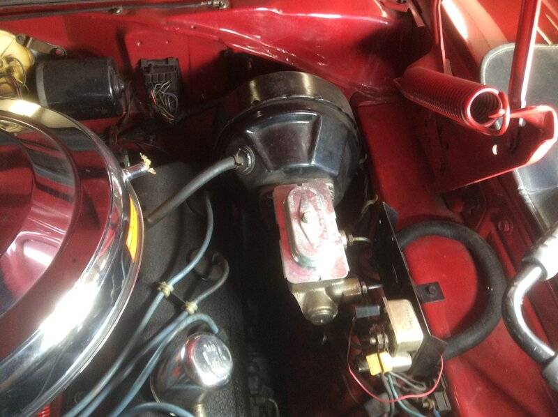

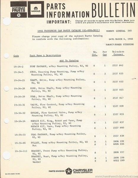

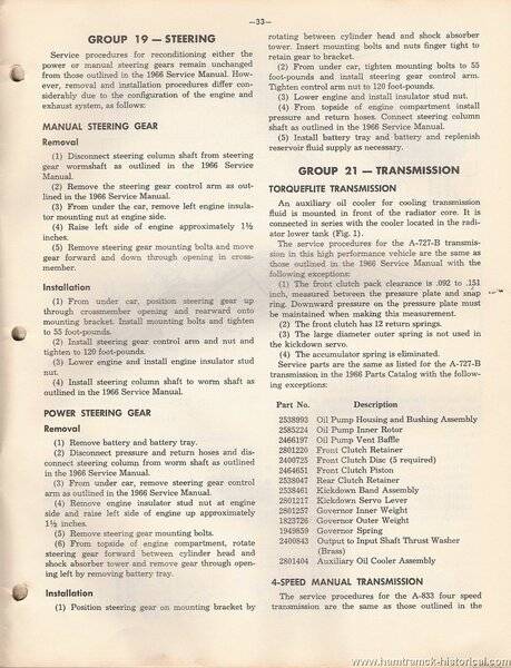

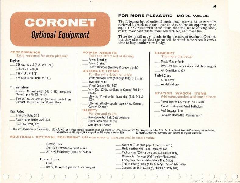

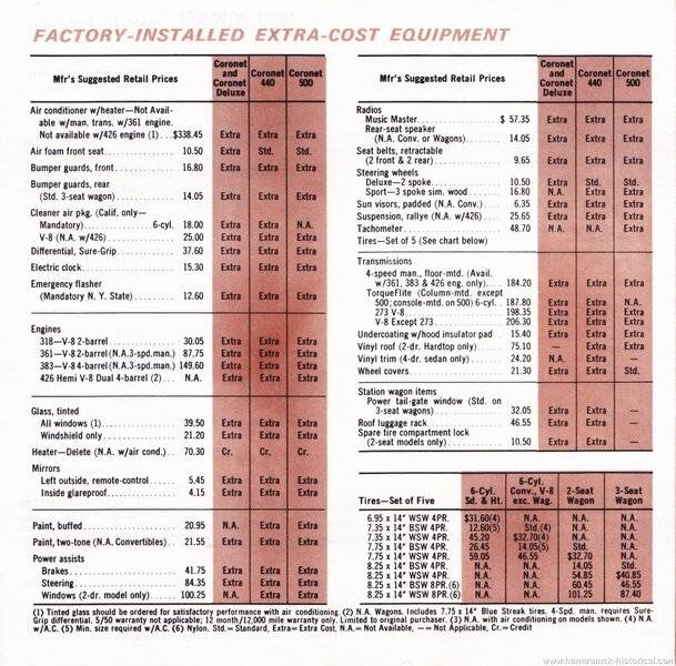

Well OK. That's a lot of documentation, thanks for sharing. I had read and always thought there was no power breaks as the booster would not fit due to the width
of the Hemi's valve covers.
They used a booster with an offset mount. Still a royal PIA to pull valve cover or left rear plug. Flexible plug boot solved most of the plug changing issues.
P/S was available on a 66,I own a a 66 original
with P/S Hemi 4spd
Booster raised up. To remove driver's side VC take all bracket off drier's side of intake and 1,3 and 5 tubes don't to fool with them.

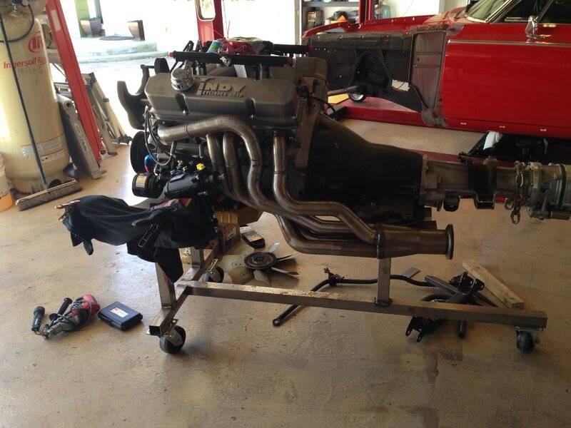

If you can do it, have the engine on a stand and bolt the K frame to it so you can check for issues. Much easier to deal with that way. I used the TTI units for my combo, they make them specifically for it, but since I was using Shumacher Hemi conversion mounts on an Indy block bolted to a 70 K frame, I figured there would be some fitment issues to deal with. There were. I ordered them raw, uncoated so I could take care of problems. Good to go now.
